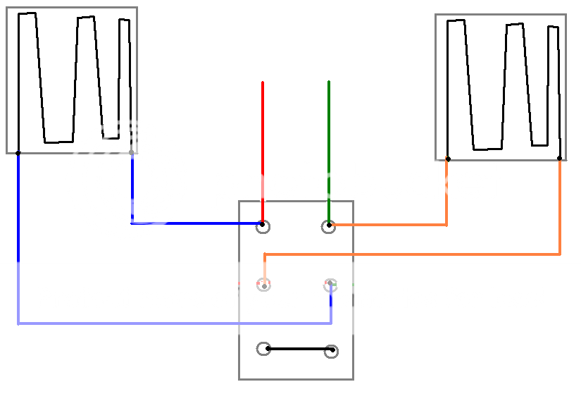

Simple = best in my book
If you connect the grips up using a simple a double pole, double throw three position switch, you han have high, low and off.
In high, they're connected in paralell, in low they're connected in series. vide infra
https://i48.photobucket.com/albums/f216/stinkwheel/switchwiring-1.png
I was very hoping you'd turn up. Thumbs Up
That's probably the best way. I suppose I was trying to be too creative when it wasn't required. I'll give that a go and see what sort of temps it achieves.

Yep PWM is bit sofistercated for them things
I suggest running them in parallel first cos if they're
like the ones I played with years ago, they won't exactly take the
skin off your hands running flat out.
Are we talking of ones like pictured below?
Remember they'll lose heat into the bars and some heat will be insulated by the grip, so don't get fooled by a bench test
TLDR
fit pads and grips, run flat out
IF they get too hot, after 15 minutes use the switch method above
to run them in series
