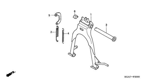

It's the CG setup. Smile
it doesn't have any way of undoing itself so doesn't require torqued threads.
My CB500 was the same too.
Oddly the 2005 CG doesn't seem to be on there, but the 2004...
https://storage.googleapis.com/pfk-megabucket-732/HPL/Images/17KGA401/IMGE/F__2000.jpg

Teflon-Mike wrote:
Rob Fzs wrote:
they're only like 20 quid new off david silvers, you'll only end up smashing something worth more trying to undo the pin
Trouble with chopping the ends of the pin, is that while you may get the stand out in a hurry... you still have to get the corroded in remains of pin out of the stand some-how.
Pete did it 'Old skool' with patience and persistence, and 'minimum brute force' and if you have the time, it pays, not only in the £20 saving on a new pivot pin, but likely saving damage to fragile center stand along the way.
The one I described doing with drill holes and plus gas, that way, was fully salvaged... slowly, and the frame it belongs to resting back on it built up as a 'roller' waiting an engine.
OP says his stands already cracked a leg, though; and having turned the air blue trying to salvage one like that, and ended up achieving nothing more than a hole in the garden fence when I lobbed it in disgust, after managing to get it out and get the pin out of it, and spend two days chasing good metal to weld it up... I think I would probably be cutting to the inevitable & reaching for the angry grinder rather than the hacksaw, and digging through the piles of 'ready spares' or looking on ebay for a CM or CD footrest bracket with side stand to bolt to the motor to prop it up after!
One I did with the top hat bushes, was taken out with a hack-saw; but I saved the stand, but took three threaded hacksaw slots to loosen the pivot tube enough to peel it out, without doing 'too' much damage to the stand. (Probably 1/4 of the tube came out as saw-dust!) As I already had a side-stand bracket on the engine for that one, I would have probably not bothered, but for the fact that my daughter wanted that bike.
The stand is fucked, as OP said.
Even then, you just cut a slot along side the top of the stand, lube it up and slam the pin out with a big hammer and then weld it back up again.
'00 Aprilia RS50 > '92 Honda CG > '99 Yamaha Fazer > '91 Yamaha RXS > '79 Suzuki X5 > 01' Honda Cg > 07' Honda Cg > 82' Kawasaki Z200 > suzuki gsxr 400 gk73a > honda vfr 400 NC30> Yamaha RD350 YPVS F2 > Kawasaki ZZR 600 D1 > Yamaha TZR 250 2MA >Suzuki TL1000R > Yamaha TDR250 > Honda 929 blade > Suzuki SV1000 > Honda H100
Mod 2 Passed 09/06/2011
Petemate
Joined: 13 Nov 2015
PostPosted: 10:20 - 11 Oct 2016    Post subject: Reply with quote
Brutal but clever Rob - save the stand and only a spindle to obtain.
82 not out....1983 Honda LA250 Custom
2008 Saab 9-3 1.9 Tid 150 Vector Sport estate
2005 Stirling Eccles Topaz 2-berth
Teflon-Mike
tl;dr
PostPosted: 10:59 - 11 Oct 2016    Post subject: Reply with quote
Well you can try it!! Let us know how it goes!
Reason for drilling holes to get plus gas into the pivot tube, was/is to avoid slotting the stand, and making more work / risk.
Reason you cant get the pin out to start with is because its rusted in the tube in the stand, so you aren't dealing with good metal; & I'd not be too keen to try filling a hacksaw or dremel slot, what 1-2mm wide and four inches long with weld.. and THEN trying to get a pin to go back in the hole, AND the stand to rotate round that pin.... even if it was good metal!
And no real need. If you are chopping the pin to drop the stand from the frame; you have the whole stand in your hand, and you only want to get the remains of pin out.
Why cut the bit you'd like to keep?
Thread the hacksaw blade through the pivot pin, and refix in the hacksaw', then slot the pin from the inside. If you keep the hacksaw 'flat' you can cut right through the pin, and leave barely a witness mark on the tube of the stand....
If you have enough of the pin protruding from the tube, you may be able to grab it with pliers or grips and twist; the slot letting the pin contract enough to break rustgrip and pull out with a little wiggling.
If not; thread the hack-saw again and cut two more slots at 120deg to the first; cold chissel and a hammer, and tap into the crack between the pin and the tube and and bend the end into the middle away from the tube, they you can work the chissel into the gap to break it away down the length, and it should pull out with pliers... if not work it from the other end the same way, and the first section will drop out. Next two sections can be removed the same way, but with more of a gap to bash the 'petals' into
Same conclusion, no welding required; much less risk of buggering up the stand you hope to keep in the process, and probably no more time or effort.
Save the metalic glue gun and the dremmel for building up the ovals of the frame eyes!
