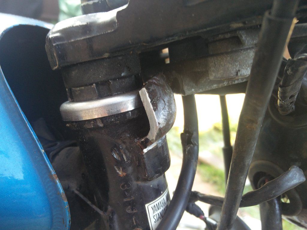

Had a go at repair the steering lock but couldn't budge it. I'm going to try again using mole grips with a fork tube for leverage. I couldn't shift it with a 2ft pry bar I couldn't get any purchase.

Also 'fixed' the steering lock. It's a bit shit but it works. I striped the head stock and rebuilt with fresh grease. I have also stripped cleaned and rebuilt the forks although I can't do up one of the dampers as it just spins I need a tool to hold it. However the forks are so tiny I can't get anything substantial enough down to jam the damper. Until I do this I can't put oil in the forks or rebuild the front end.

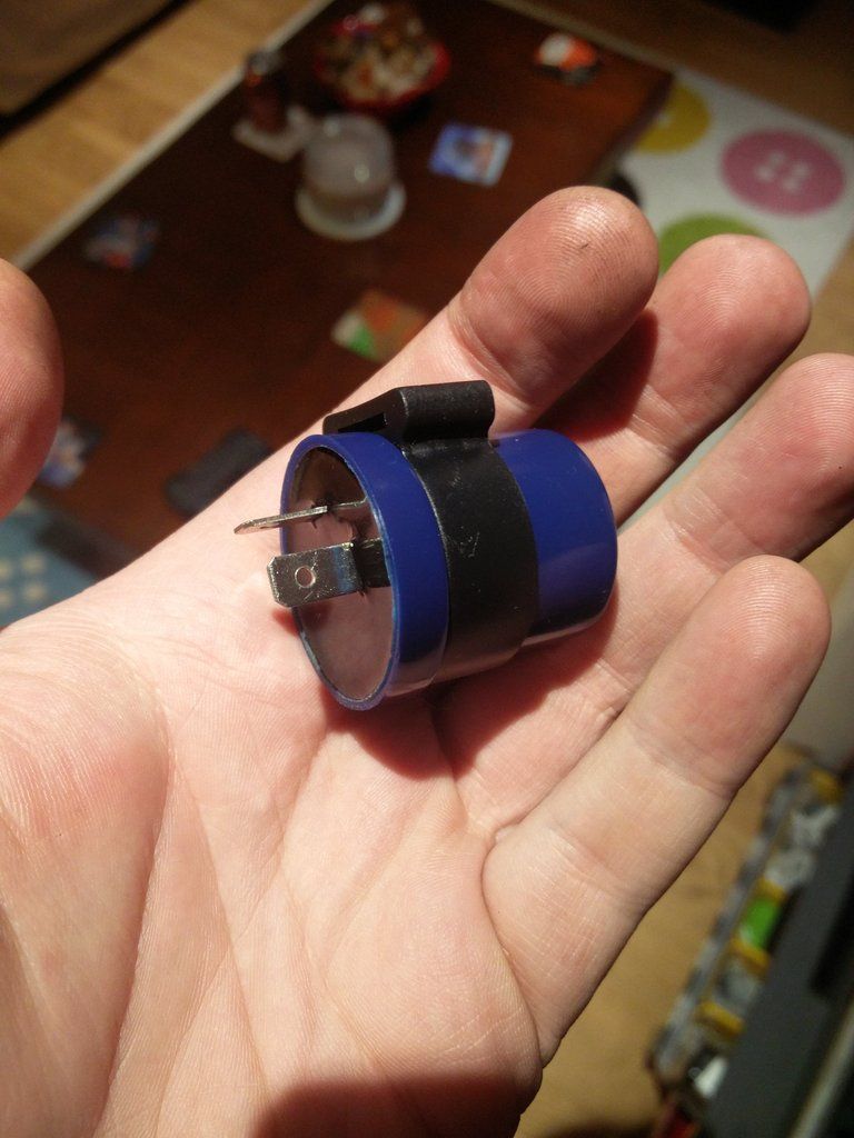

Also received a LED flasher unit and I'm just waiting on the bulbs to arrive now. Anyone with an RXS will know the lighting is shit. The indicators are dull, and do not flash well unless the bike is revving. If you have the brake light on the just do not work full stop.
99p of China's finest.
https://img.photobucket.com/albums/v295/chris-red/IMG_20170201_224957_zpsrccqjshl.jpg
The current bulbs are 8w each, the LEDs I've ordered claim to have the brightness of a 21w bulb and only pull 1.5w. So in theory they should be brighter, flash correctly and pull less power. I paid the princely sum of £4.95 for the 4 bulbs and the flasher. I'm thinking of making a video describing the mod if it works as it is a big change for little money.
I might also buy an LED tail light to futher help the load. The battery is tiny! So every little helps!

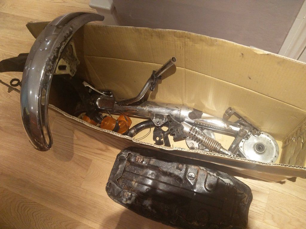

I also Bought a job lot of spares for cheap. I'm sure something will come in handy.
https://img.photobucket.com/albums/v295/chris-red/IMG_20170201_225316_zpsnwjvjscl.jpg

Buy a LED bulb (400LM+) fits right into the original light, works just like a standard bulb would = no soldering, no hidious LED panel instead of the classic tail light. Go Aliexpress or DX, cheap. Thumbs Up
Make sure it's at least 400LM, 300LM is not bright enough for the brake light. Or at least it wasn't in my ZX7R. 400LM was equal to a standard filament bulb

The pivot is ridiculously loose. I don't know whether to drill out and get some sleeves made or weld up the holes and redrill. The pivot is circlipped on so it can't be tightened.

PostPosted: 23:52 - 06 Feb 2017    Post subject: Reply with quote
You could probably weld a plate inboard of the holes and redrill. That would take out the horizontal play too.
PostPosted: 12:26 - 09 Feb 2017    Post subject: Reply with quote

I suppose another option would be to overdrill the holes round and get someone to turn up a tophat insert
PostPosted: 14:05 - 09 Feb 2017    Post subject: Reply with quote
Yeah I might be taking another trip to Pete.'s in the near future. Laughing
I'm going to buy the olives and strip it down I can then make a decision when I see it better.
