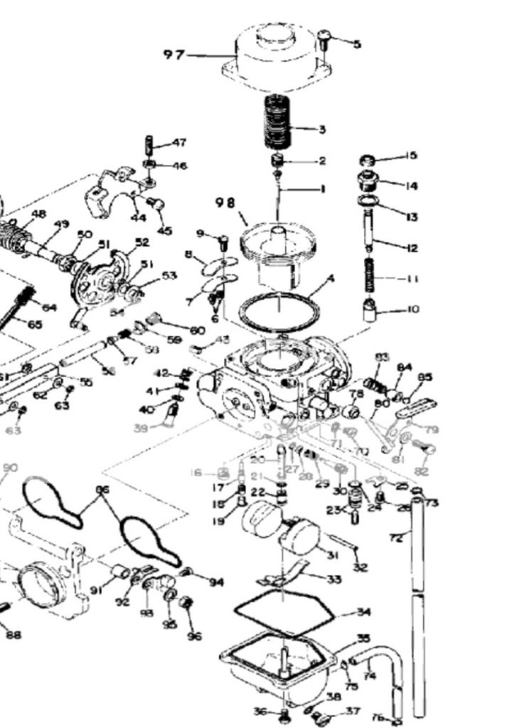

https://i61.photobucket.com/albums/h67/Jay29031/Mobile%20Uploads/51C412F0-B5D2-4C5D-8535-6DA627894650_zpsyvhlk3cs.jpeg
I was wondering if a bad seal between parts 97 and 98 would cause this ?

I thought maybe a bad seal between 97 and 98 ?
