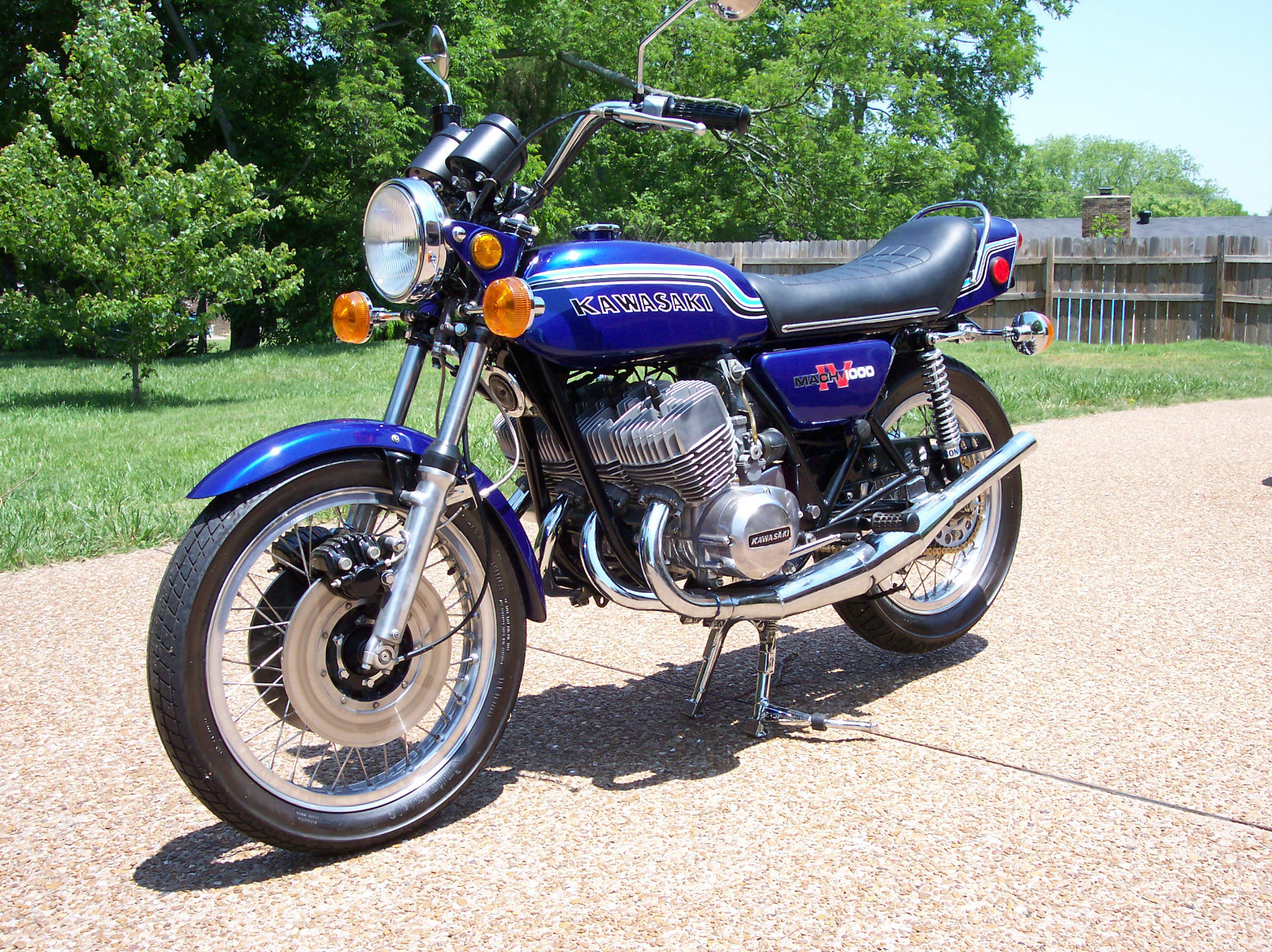

Should be noted that Allen Milliard uses aluminium solder to join the two crankcases he's bandsawed apart when he's making an inline 5 out of two kawasaki triples.
he turned a friends 750 h2 tripple into a 4cylinder and you would never know it wasnt supposed to have 4 cylinders
That would be extremely odd with two cylinders sticking out one side and only one on the other, got any pics?
Allen Millyard's a bit smarter than that Very Happy
https://i.ebayimg.com/00/s/MTE5OFgxNjAw/z/RKUAAOSwr81UOVWx/$_57.JPG
