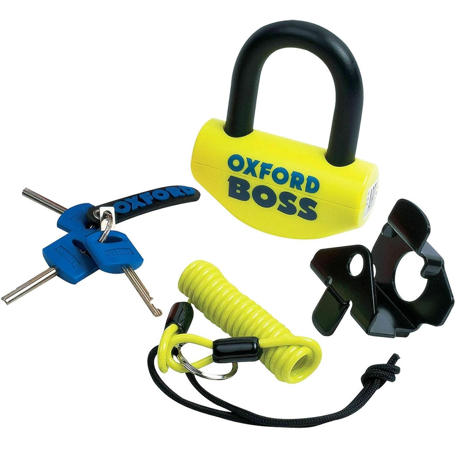

I have the below lock. It came with a lock holder as shown in the picture. I am unsure where I can install this holder on my Kawasaki ER-6N? It didn't come with any fittings... Is it even meant to go on the bike?
https://images-na.ssl-images-amazon.com/images/I/71oGdKQlfTL._SL1500_.jpg

I suspect it bolts on with a bolt through the little hole, head accessed by a socket/box spanner through the big hole, and the lock goes around the whole thing, with the hasp following the line of those turned-down lugs. Big hole on bracket facing outwards.
Have you got an existing bolt (rear footrest or similar?) on the bike that you could use? Stash it on the bike (under seat?) instead of using bracket?

I will take a look around the bike tomorrow. I was thinking may be using cable ties around some bar if I can't figure out.
under the seat, space is quite limited. I have another alarm disc lock to carry. So it will be ideal if I can use the bracket. Currently I am carrying the locks in the bag.

That's a mini-D lock or big padlock, as far as I can see.
I suspect that the smaller hole in the back of that carrier bracket, is probably about 6.5mm, sized as a clerance fit on 'any' convenient M6 screw, and imedietly springing to mind is on a push-bike, and bolting the horse hoe brake caliper through that hole.
On a motorbike? rear foot-peg bolt sounds like a good idea, only the peg and hanger are often lugged to stop the peg rotating with just one fastener; might take a bit of filing to make a flat-space for the lock carrier to sit straight, and then the peg could float turn... ha, stick some thread lock in there, and tighten the bejexus out of it... be Foyne, I rekun! Otherwise apply a bit of imagination and injin-you-ity and find a bolt 'some-here'...

How do you carry it though?
Well, that bracket may not be the best, but its something. Used to be deriggeur at one tome to clamp mini-D-locks around indicator stems.... if that's any suggestion for you... but, back to that injun-you-ity, and seeing what convenient bolts you have around the bike!
