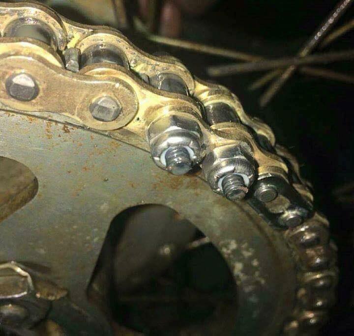

Alternatively you could use the nut and bolt approach.
https://pbs.twimg.com/media/DnzjIFuWsAAiM42.jpg
