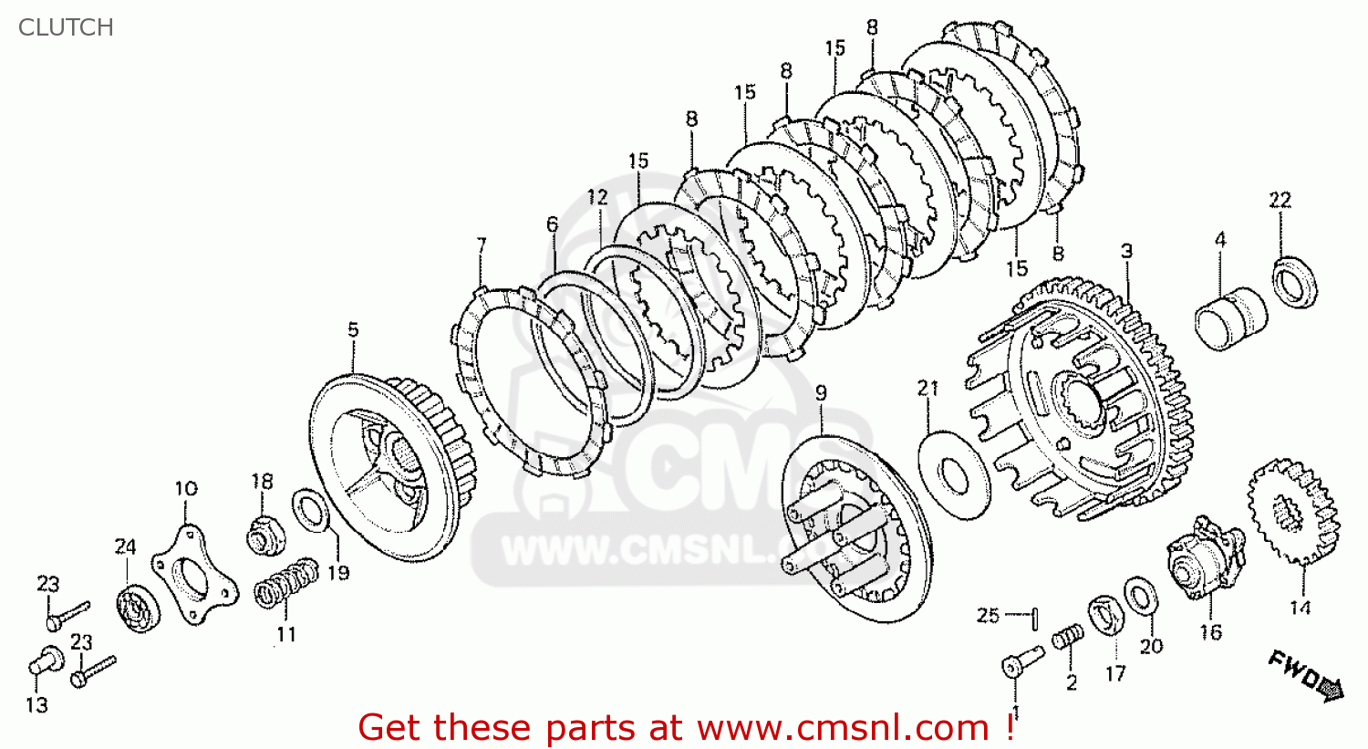

PostPosted: 11:12 - 02 Mar 2019    Post subject: cb250rs Reply with quote
https://images.cmsnl.com/img/partslists/honda-cb250rs-1982-c-england-clutch_bigma000142e07_714d.gif
