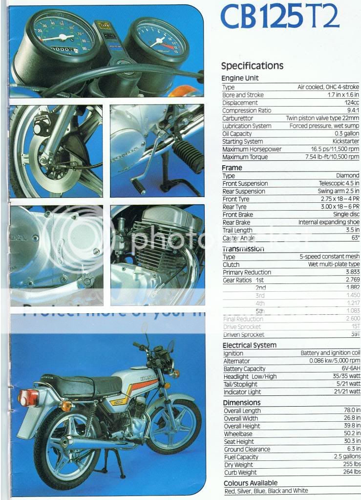

Launch model CB125Twin, claimed 17bhp, or 136bhp-per-liter. That was pretty audaciouse, for a production engine... Remember, it was the same year they launched the CBX-1000 'Six', which with 24 valves!, only claimed 103bhp for its full liter displacement.... Not much, over-the counter, could break the 100bhp/liter mark. The probably faster Suzuki GS1000 of the same year, with 4-cylinders only achieved around 85bhp, the Kawasaki Z1000 about the same... and with that displacement, they didn't have to work so hard to give them 'bottom', and with that much excess, they could stand a much fatter price tag in the show-room!
