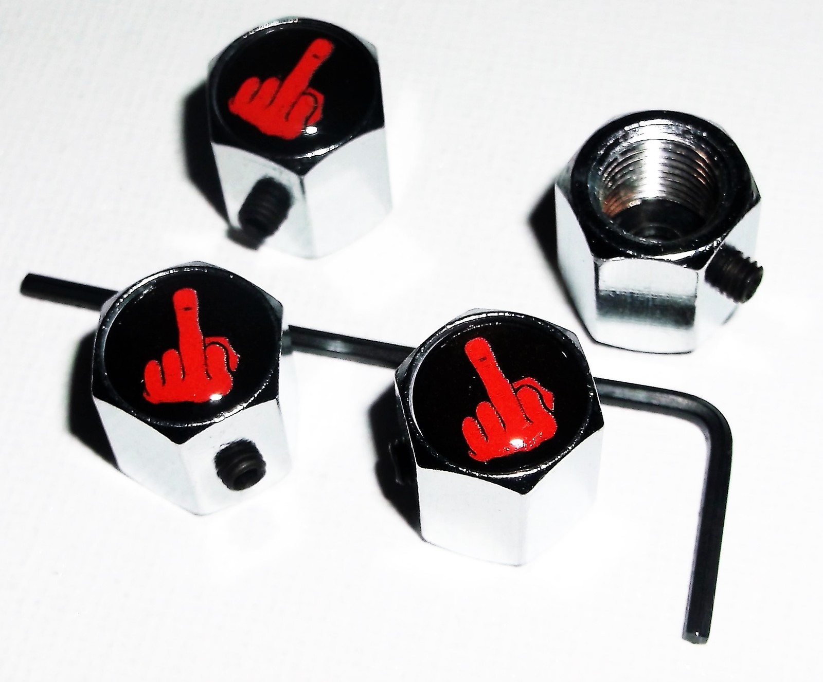

https://www.ebay.co.uk/itm/LOCKABLE-FINGER-F-OFF-CAR-DUST-VALVE-CAPS-lock-anti-theft-van-bike-tyre-alloy-/281889224494?_trksid=p2385738.m4383.l4275.c10
https://i.ebayimg.com/images/g/CPkAAOSwll1Wz2kW/s-l1600.jpg
You have an answer.
