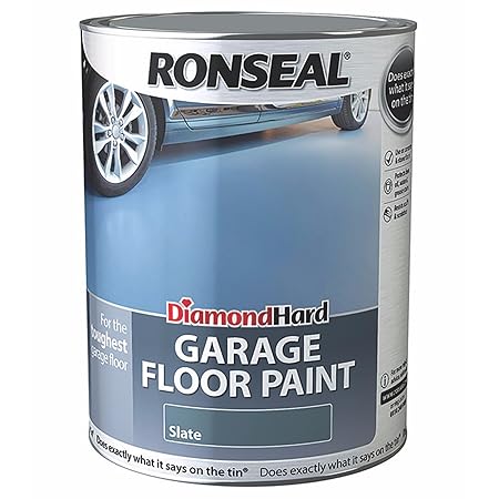

I used this stuff:
https://images-na.ssl-images-amazon.com/images/I/71oylp-gqWL._SY450_.jpg
I can tell you that it's not diamond hard and, therefore, does not do exactly what it says on the tin. In fact, the only way it could do that is if the tin said it just came off in clumps when you rolled a vehicle over it. Might be alright with just light motorbikes but with a car in the garage as well it fared really badly. 2/10 - would not recommend.

arry wrote:
I used this stuff:
I used something similar, it's good, except it doesn't fare too well with centre stands

With the Ronseal I do not trust the name. I used to, not now though because it's like everything with a name - it's bought out by corporations and used as a front for poor quality products not related to the originals at all.
It does sound like I dodged a bullet with it!
