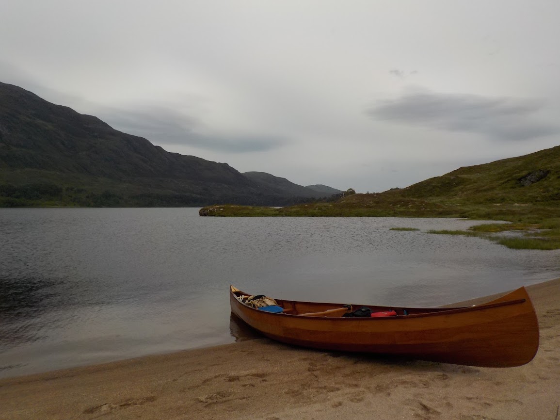

WD Forte wrote:
If you do use epoxy or resin, seal the wood first or you could get air bubbles from the wood fibres into it.
Allow it to acclimatise to somewhere warm, then move it somewhere cooler (but still in the epoxies thermal range) and apply the epoxy. Any microbubbles will contract and draw the epoxy back into the wood.
I have some experience with epoxy on wood. I made this.
https://lh3.googleusercontent.com/oimH7o1PwTfSRdppXE7I4m8tib5p3B-dlgDe8J7zrxAtI0fFenszEGyJjlubE0_Kl28dwuW3QFH3LsBMr6D1MvxqCI17PgSRKMRHhGxu1DfrvJ_ZtEPduwqSHp8X6CJ-yOieXfZ6oQ=w1155-h866-no
If you do decide to do it, long sleeves and nitrile gloves. Uncured epoxy on your skin can do nasty things.

Fucking hel, Stinkers is God, He made a loch.
