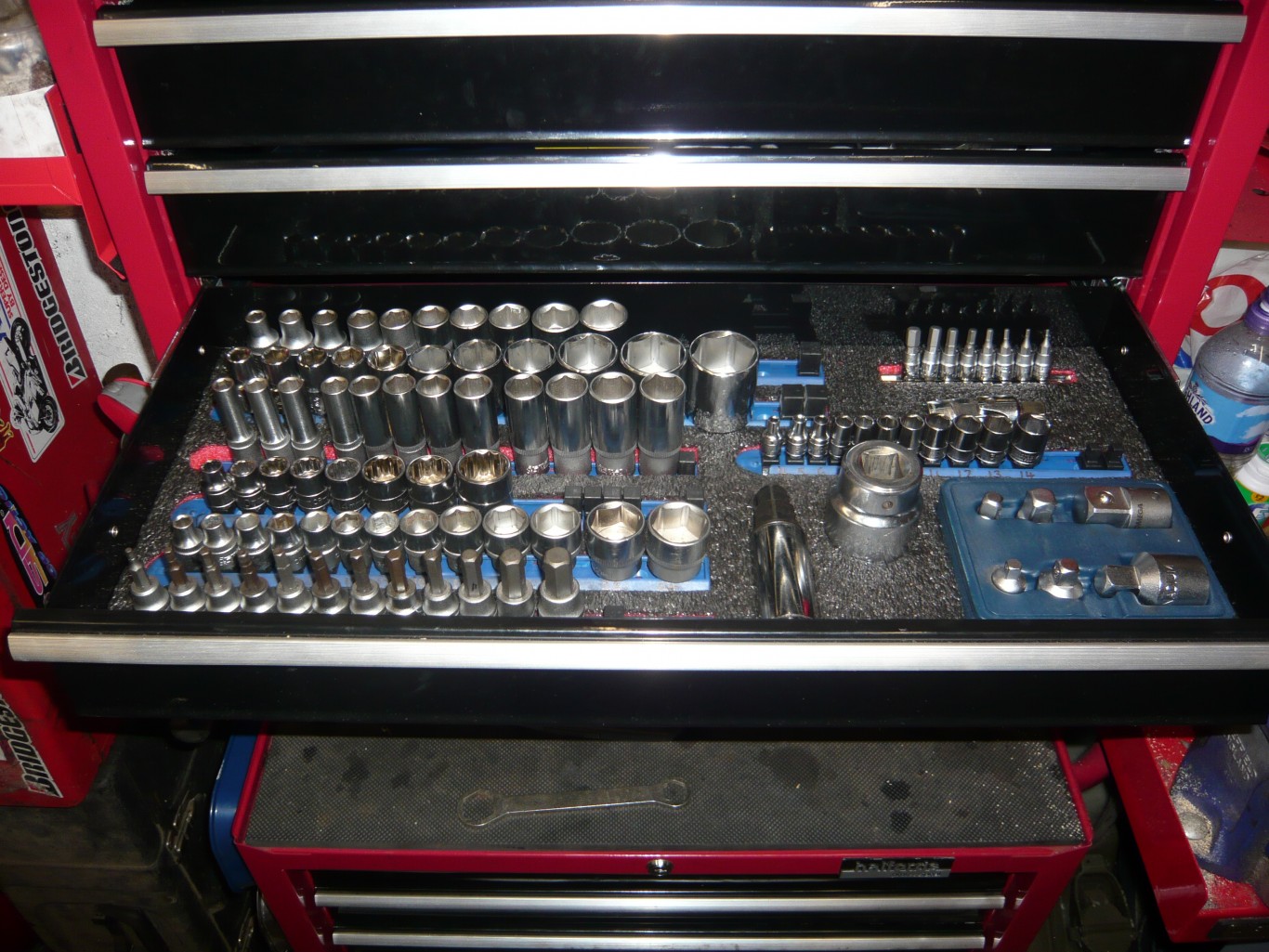

yen_powell
Joined: 22 Jun 2008
PostPosted: 21:27 - 17 Jun 2020    Post subject: Reply with quote
Freddyfruitbat wrote:
My Halfords set must be about vintage 1978, and is still in great condition, which is more than can be said for the plastic moulded insert which all the sockets and tools fitted into - the plastic degraded years ago so everything just rattles around in the metal case. I can't come up with any realistic way to solve it, but it annoys me so much that I'm almost tempted to bin it and buy a whole new socket set...
I have just put Sealey layered foam in a lot of my tool box drawers, cut around the sockets etc so they sit snug in it. Nothing moves now when the drawers get slammed or the box gets moved about on a lumpy floor.
XT1200Z and a DR350 in bits
Freddyfruitba...
Joined: 20 May 2016
PostPosted: 11:27 - 18 Jun 2020    Post subject: Reply with quote
Brilliant! Just googled that - I had no idea; thanks a lot. Going shopping...
yen_powell
Joined: 22 Jun 2008
PostPosted: 11:42 - 18 Jun 2020    Post subject: Reply with quote
It's not cheap for the amount you get but you can't beat it for knowing something hasn't been put back, a point I noted after one of my sockets did a runner and made me upset every time I opened the drawer. Found it in the end though. I tried a normal foam the first go, but the layered stuff is definitely easier.
https://images.versys1000.com/P1270673.jpg
https://images.versys1000.com/P1270671.jpg
https://images.versys1000.com/P1270665.jpg
The spanners one is temporary with a bit of left over foam I had lying about, trying it out to see if I like it or not before doing the whole drawer.
