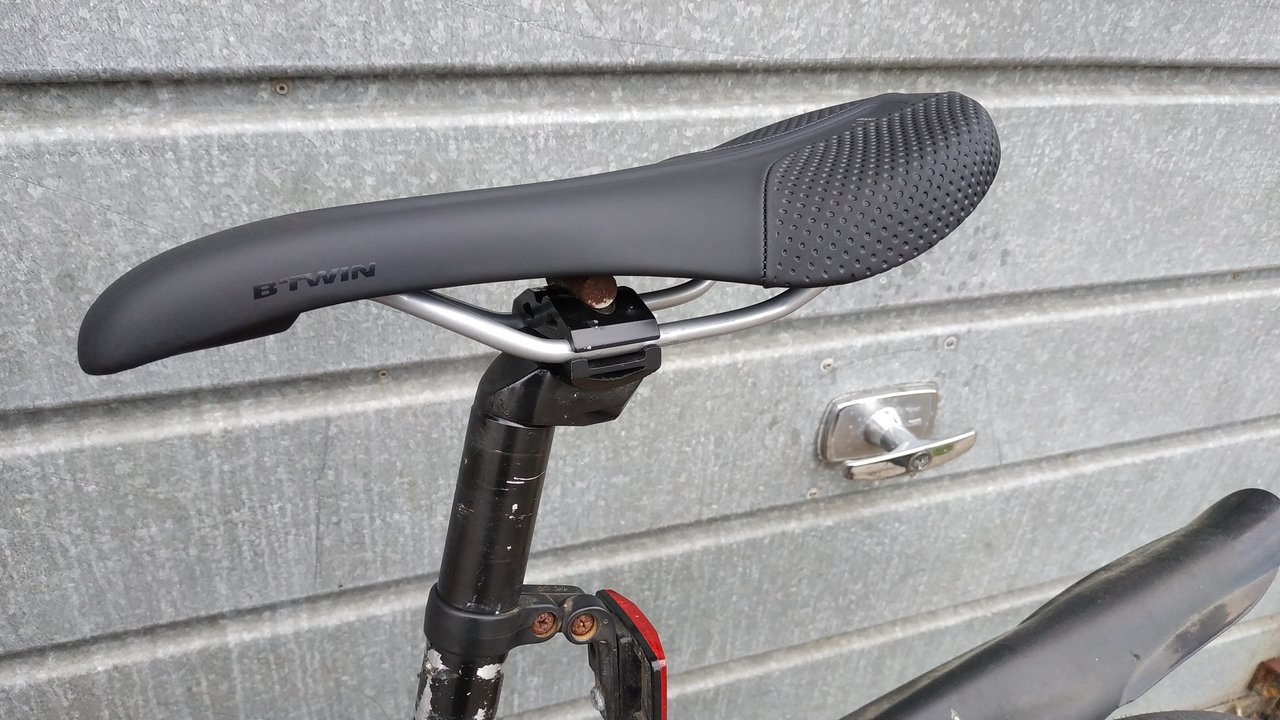

Got this seemed light, narrow, with some padding.
https://i.postimg.cc/YC5vbLFM/IMG-20200716-201733.jpg
Even with it fully back, I feel like I want another 2 inches adjustment.
