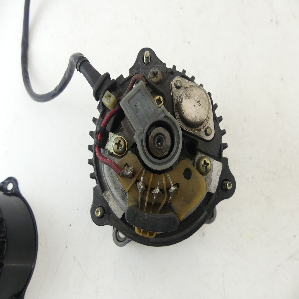

This is the ass end of an FJ alternator mounted above the
'stator cover' where the pimple switch err I mean pulse generator is
The impact may have cracked a solder joint on the diode pack
or damaged the brush holder
https://www.bilder01.mcr-dortmund.de/19749-5.jpg
4/10 must do better
