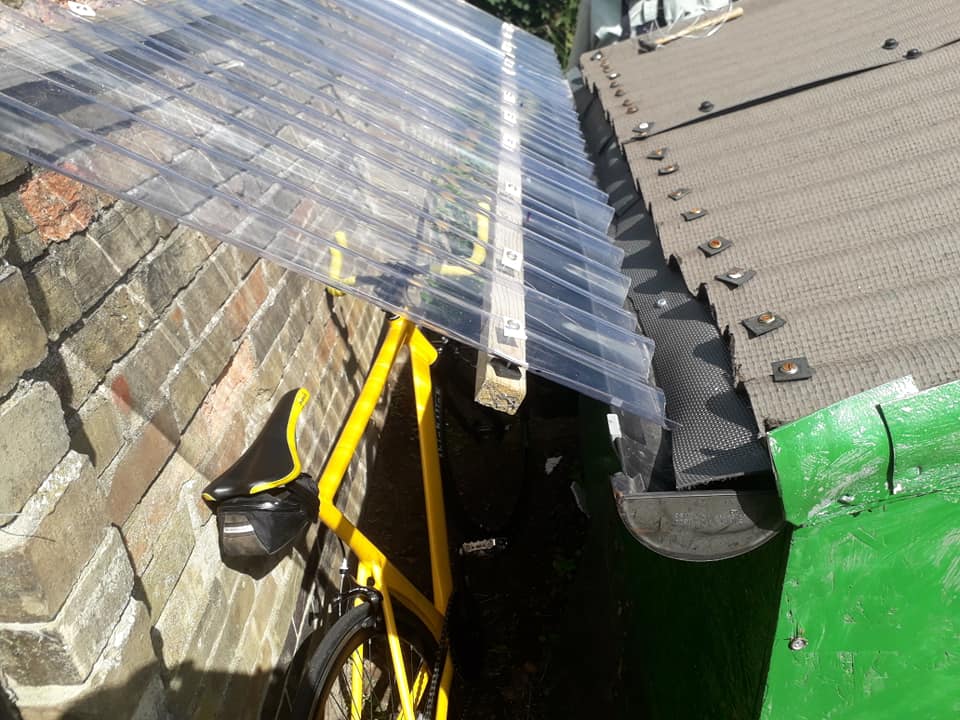

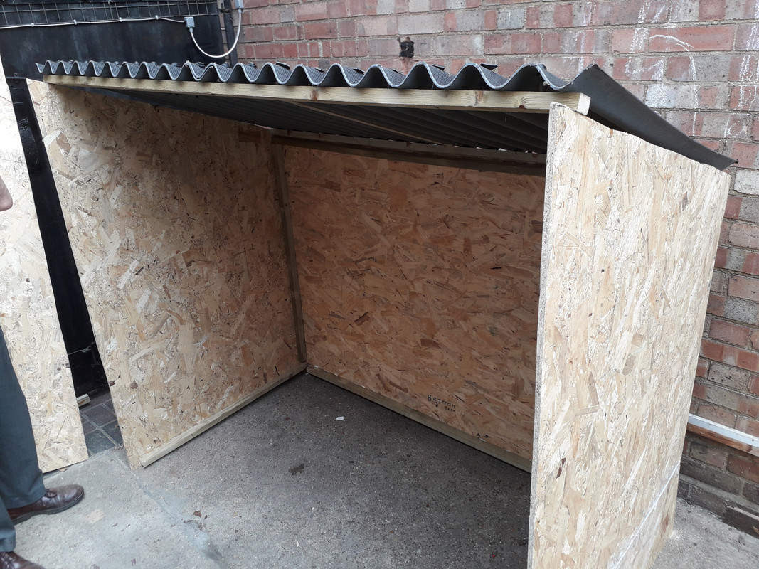

does it look like this? It really does need lots of support, or it will collapse, and the edges curl up like a stale sandwich after a year or so. It's okay, but not great.
https://i.postimg.cc/WpYcmXkq/20200616-104548.jpg
https://i.postimg.cc/DZxHryxB/shed2.jpg
