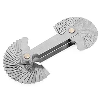

I really would reccomend getting one of these if you are doing your own spannering. Cheap and eliminates any doubts on pitch size. OK, it's not a necessity but I'm a tool nerd and it's nice to have. Laughing
https://images-eu.ssl-images-amazon.com/images/I/41RVb1HZRwL._SY445_SX342_QL70_ML2_.jpg
https://www.amazon.co.uk/Deals%E3%80%91OriGlam-Stainless-Measuring-55-Degree-60-Degree/dp/B071H8GP18/ref=sr_1_6?keywords=metric+pitch+measure&qid=1644756896&sr=8-6
