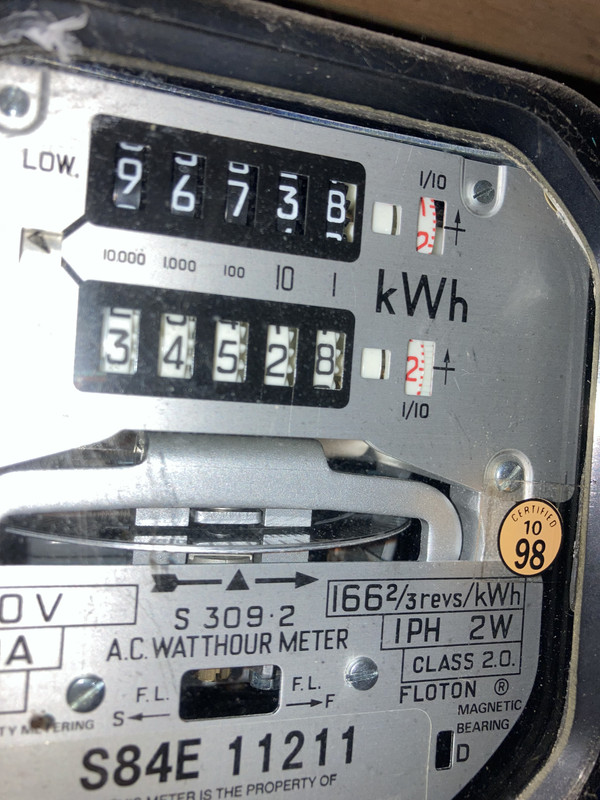

I guess the house had storage heaters originally but now it has Dimplex panel heaters with an individual controller on each one. They’re not great.
The original meter is still there with its two displays for day and night, but the night reading which would have been Economy 7 never changes.
https://i.postimg.cc/pXzW1mSm/762-BB02-E-7342-4-D62-9264-FB38-C0-AC7-B70.jpg
The one on the right looks like the Economy 7 timer setting.
https://i.postimg.cc/y8K1qVqv/FAE9-B329-CDA6-4733-8846-6-C41-D2738-C8-E.jpg
With the fridge, freezer and standby appliances in the house the horizontal disk spins like the clappers but the numbers thankfully don’t.
https://i.postimg.cc/sftfcYTF/C67-FDAD3-FA68-43-C6-9656-00-A35-AFD2-A98.jpg[/url]
Here’s the switchboard inside the house, and if I flick the mains to off the meter dial slows to a crawl (watch it for 10 seconds and you can see it move) but doesn’t stop, and I think it should.
https://i.postimg.cc/K85ZxdxF/4-B7-F0-B04-272-F-4-A2-C-978-C-867-A5-BE39398.jpg
I had almost convinced the supplier to send an engineer out but then lockdown 1 happened.

Just get your local electrician in to strip out the economy 7 wiring from that fuse box of the heating doesn't use the wiring for it any more.

They probably think they’ve already done all that’s required. I’m renting anyway. Maybe I’ll just punt this evidence back to the landlord via the letting agent. I just wanted confirmation that the dial shouldn’t be turning at all when the mains switch is off.

If everything is off, those meters shouldn't move, they work by induction so the disc only moves when current is flowing.
If it's barely perceptible movement, like less than 1 turn a minute, I suspect it'll be the timer which will be a tiny draw, probably costing you pennies a month. Almost certainly not worth bothering about..

Supposed to have been deactivated.

The night rate numbers never move.

No.

So there is a second set of tails leading off from the old horstmann economy 7 meter to a presumably now defunct storage heater consumer unit
Can you confirm there is still a second old fuse box?

There’s nothing below Pic 1 except the cables going into the wall, and there’s a single fuse box on the other side, inside the house. No old fuse box remaining.
