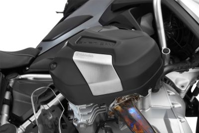

I recently had a low-speed off on my BMW boxer twin, and fortunately my cylinder head protector did exactly what it was supposed to. However in doing so, an aluminium plate came unstuck from the main plastic body:
https://www.wunderlich.de/thumbnail/cf/23/9e/1722566107/35613-002_web_blank_03.jpg_400x400.jpg
I'm probably overthinking it, but bearing in mind the adverse conditions (mechanical strength/ high temperature etc) I emailed the German manufacturer and asked what type of adhesive they use, and was advised it was the following, a 'single component polyurethane':
https://eshop.wurth.co.uk/Product-categories/Bond-and-Seal-structural-adhesive/31083005041106.cyid/3108.cgid/en/GB/GBP/
Now I can obtain exactly this stuff in the UK for sure, but it's no doubt going to be highly expensive, and truth be told, I've probably already got an equivalent in my glue collection here anyway. Would anyone who knows about this stuff be able to advise the specifics of what I should be looking for?

Remember there are foaming and non-foaming polyurethane adhesives. If there is a slight gap and you can clamp the pieces firmly together as it cures, the foaming sort is better because it'll get a bigger surface area and fill any gaps. Squeeze-out is easily trimmed with a sharp knife once it's cured. If you can't clamp it firmly, the foaming will push the pieces apart slightly.
As above, gorilla original is a foaming polyurethane. Gorilla crystal clear is non-foaming.
I use West Systems G-flex epoxy for most adhesive jobs and it's what I'd use there. You need to briefly run a blue gas flame over the ABS just before you apply the adhesive then tape it down hard while it cures.

I would get normal epoxy mix that shit up and paste it on to the back of the aluminium using a sacrificial paint brush across the whole surface then stick it on and pay my kid £5 to sit and watch youtube for an hour on his ipad while holding it in place Laughing
