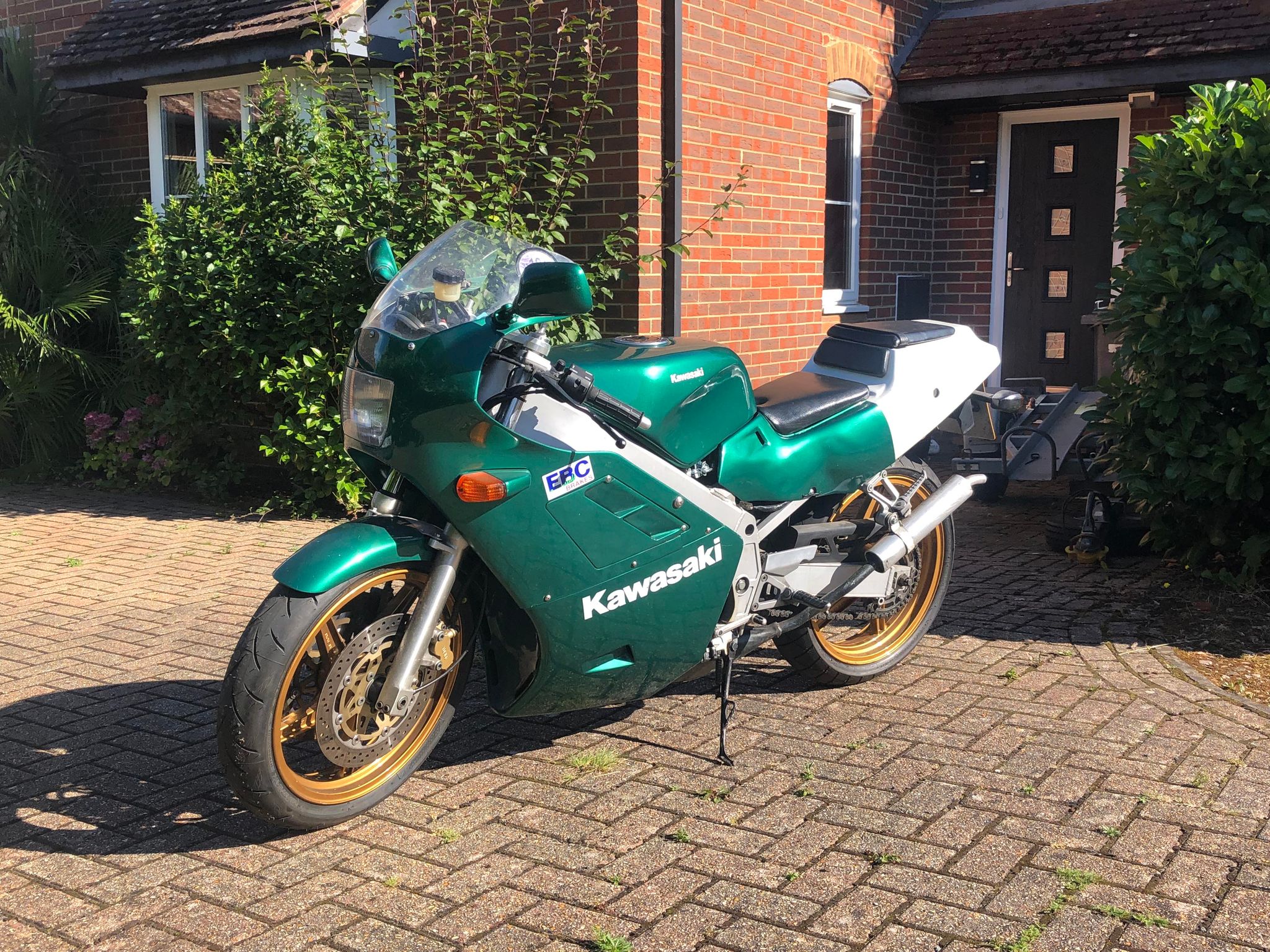

https://www.bikechatforums.com/files/09-08-24.jpg
It only took a full top end engine rebuild and complete brake overhaul...

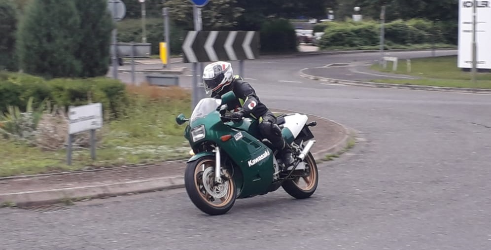

https://www.bikechatforums.com/files/kr1s.jpg
I managed to get a couple of riding pics of the bike (and me). It rides nicely, but the clutch lever feels weird. I found that the clutch lever pivot is 7mm in diameter, but the clutch lever pivot hole is 8mm so I'm going to make up a brass bushing to take up this slack. The brakes go nearly all the way back to the bar, but once they engage they feel good and work spectacularly well for a bike from 1990. This'll be the brand new pistons, cleaned up calipers and new fluid.
The original brake pistons had inserts in them that looked like fibre or ceramic, and the replacements don't have those, so that might feasibly affect the brake travel.
Also, considering it has weird tyre sizes it handles nicely. It took a bit of recalibrating to work out how the bike wants to be ridden, but now I've got it a bit the bike is great fun.
