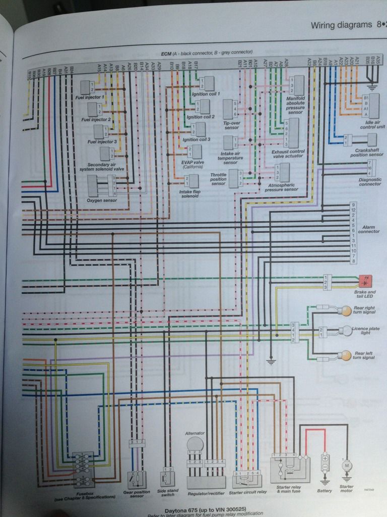

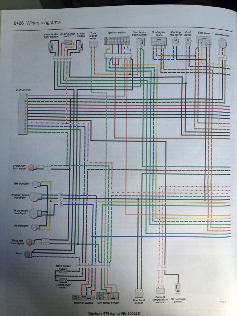

Street Triple 675 2009
When I try to start it occasionally doesn't start. It has full power to the dash, fan's come on. won't turn over. No dimming of the headlights when I tried to start it. The battery is new.
I assumed plenty of power there so must be something else.
Bump started it and rode it home.
Tried to start it and it started first time. Took it out for a ride again and it seems to start no bother again. Then randomly doesn't start at all and starts again
What I'm thinking is a relay switch or something faulty? rectifier on the way out?
I'm wondering which of these could fail intermittently and which would just cause a permanent fault? So I can reduce the amount of things that I need to test.
Looking at the wiring diagram I can see that it could be a number of things creating the fault. Also the sidestand switch? I guess it would be to test these components one at a time while hoping the fault re-immerges.
I will likely give this to the mechanic I use but he is booked up until Mid October. Confused
So I have a multimeter and know how to check voltage, resistance (Continuity). Insulation resistance but I'd need a megger.
Used to use Time Domain Reflectometry (TDR) for finding faults, Changes of impedence in long subsea cables power and control cables. It was 35 years ago at that time TDR was in it's infancy but that's not important right now. Laughing
I've never really dabled with motorbike electrics. I guess I'll need to figure out which relay is which. Are the relays/starters and there terminals normally situated around the battery compartment? Is there a need to take the stator cover off to access the terminals for rectifier/regulator?
I will search google but thought I'd ask in here anyway. Thanks for any thoughts.

It sounds like you have everything but the starter motor turning over if you can bump start it.
The first thing to look at would be the starter motor and its associated solenoid (bottom right of the diagrams.) The solenoid is usually located very close to the battery and starter motor to cut down the amount of thick copper cables. Look for a chunky relay with a blade fuse.
Assuming you again find yourself in a no-start situation, whip off the seat carefully jab the terminals with your multimeter. One will run back to the battery and should have >12V and the other should show voltage when you hit the start button. If power is flowing it hints at a starter motor problem. A bit of grit jamming it up, but I think that unlikely. More likely is you're not seeing power. It won't be the fuse on the solenoid as otherwise the rest of the bike would be dead.
Next is the starter circuit relay which cuts the lights and directs power to the solenoid. Check fuse no.1 (but if this was blown you'd have no lights.) About the only other thing to check is an intermittent start switch and tracing all the wires in-between. The rest is "black box" stuff - either the ECU or "Alarm Connector" and there isn't anything you can do with those.
Oh, and safety cutouts (sidestand switch, neutral light, clutch lever) usually cut ignition and/or injector power.

In that case you need to look at the clutch lever, gear and side stand switches because they disable the starter.

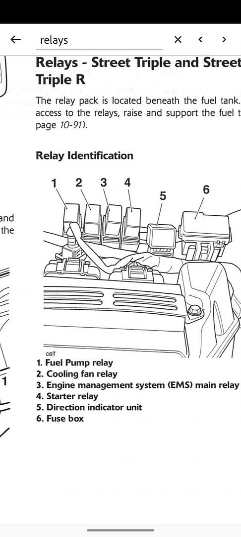

I think I'm going to struggle to find a fault which is intermittent. We'll see. Hopefully the rain will have stopped for me to get multimeter out tomorrow.

No.4 will be the "Starter circuit relay" in the diagram but elsewhere you should find the main starter solenoid. Something like this:
https://images.wemoto.com/full/ELECTRICAL_SOLENOID/wemoto-10089344.jpg
Careful with those big bolt terminals, one of them is connected directly to the battery positive.
Bypass those two connections with something suitably meaty and the starter will run. I've used it when a fuse earlier in the circuit disabled that relay.
That 30 amp fuse will isolate the entire bike so its not the fault if the lights come on.
