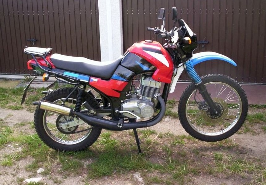

I also seem to remember some of the "special edition" model 640 Jawas they came out with just as the brand was dying off had factory expansion chamber exhausts. I think one was the 640 "sport" and another was the 640 "tramp".
I'd imagine the silencer is very restrictive and could do with being modified with a stinger in it but they are a proper expansion chamber and are designed to fit that engine.
https://www.bikechatforums.com/files/200904022331441.jpg
A100man
Joined: 19 Aug 2013
PostPosted: 07:57 - 05 Sep 2025    Post subject: Reply with quote
https://www.motorcyclespecs.co.za/model/Jawa/jawa_640%20sport%2095.htm
23.5 hp @ 5250 rpm Neutral
