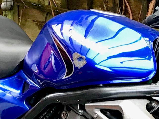

Got my tank Yesterday.
https://www.bikechatforums.com/files/dent.jpg
It came with a nice ball dent. Shocked Laughing
Well as I'm on a budget with these fairings there was no way I was even going to consider getting it repaired professionally.
Filler here we come..... Cool
https://www.bikechatforums.com/files/photo0663.jpg
I put quite a bit to much on but after 2 hours rubbing I finally got it smooth again. Laughing
https://www.bikechatforums.com/files/photo0664.jpg
Thumbs Up Thumbs Up Thumbs Up Cool

Looks like someone got there nuts into that tank Very Happy did a nice job of it. Though I would have used Epoxy resins to make it stronger. (you can buy the kits cheap) just make sure you give it a few decent strong coats of paint.. that will make it a bit stronger Thumbs Up finish that with a good Motrax tank protector and it should be plenty strong.

Basically I just want 2 sets of fairings. Laughing I used P38 as that was what I was recommended. I've still got to remove the damn zxr stickers off the side. Mad

From the look of the pic where you have put the filler in that ball dent it appears from the feather edging that you put the filler over paint...if so, it will fall out.
Filler needs a 36-40 grit *key* to stick (bare metal...always) & never more than 3/16-1/4in thick.. how deep was that dent?
Yer this is true, mate fillered his boot and resprayed it, got pissed off one night and slammed the boot shut, filler fell out Laughing . Flip paint too Shocked Doh!

I guess the dent was about 1/2 inch deep. Confused I rubbed the paint down so it was roughed up, thought that was enough. Laughing Tank protector should hold it in. Razz
