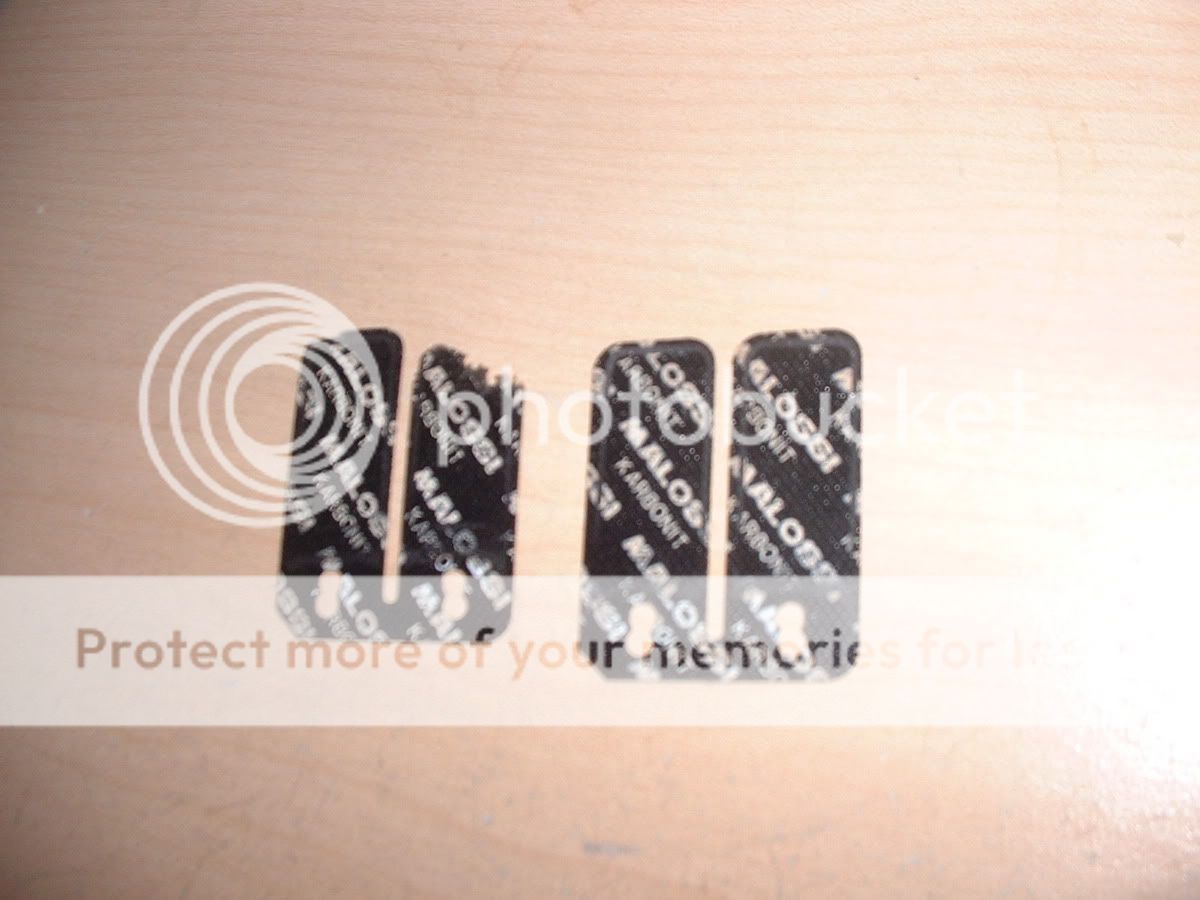

ah ok me and ben have taken the whole carb and inlet manifold appart to find that the carb float is not the problem that is fine!
the reed valves are mashed!
here spot the difference!
https://i4.photobucket.com/albums/y146/Dam_buster/reedvalves002.jpg
kinda mad that these got me from mine to bens house and back !

Pettals dude! Wink
Its kinda mad that Laguna motorcycles told us you cant buy patternt reed petals on their own, You need to pay £40 for a whole reed block!
Ahh well, Scooter center or PM tunings. Hey Jim, Ill give you the number for PM tunings as I have it here in my Twist and wank mag.

PostPosted: 07:57 - 24 Apr 2005    Post subject: Reply with quote
It was fun.
We spent like an hour striping the carb and polishing it up, then I was like.
Hummm, You got that allen key, Ill take a look at your reed.
Boom boom!
Result: One SHAGGED reed petal! Cool
Get them ordered, Ill pop by and stick it all back together for you.
GET YOUR BATTERY ON CHARGE TOO! Because your carb is fed on pressureised system meaning its going to take some turning over to get it going! Laughing
