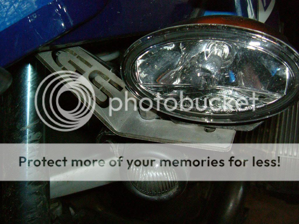

https://img492.imageshack.us/img492/4710/dscf00223zq.th.jpg https://img492.imageshack.us/img492/8296/dscf00234ek.th.jpg https://img492.imageshack.us/img492/1903/dscf00249ax.th.jpg
https://img492.imageshack.us/img492/4710/dscf00223zq.jpg
https://img492.imageshack.us/img492/8296/dscf00234ek.jpg
https://img492.imageshack.us/img492/1903/dscf00249ax.jpg
Just fitted the second pair, not wired up yet would have been done today but the place i buy wiring is closed*
The driveing lamps have been fantastic, i'm hopeing these can come on with the low beam when it really needs to (like in the rain at night with mrbmw pointing 250watts of main beam my way)...
Thought i'd share Wink

Each pair of lamps have one heavy duty relay, each lamp has its own wire(fused) straight to the battery. All have 100w bulbs except the dip wich is still the 55w as I will be upgrading to HID soon Wink . Alternator can cope as bike has ABS and heated grips as a high capacity one is fitted as standard, but the battery is giving up. A new Hawker Odyssey battery on the way next week. Thumbs Up

The round ones are fogs, 55watt each, these are on the low beam only, switched and has a blue warning light (high beam into fog just bounces the light rick back at you)
The square driveing lamps come on with the main beam all the time.
Was fairly sure they would be ok? As they are mounted i dont think theyd pass an mot as the driveing lamps are slightly in the way of the fogs, to save the hassle i might just take them off for the mot Neutral Or do some rearrangeing...
I doubt you would fail an MOT because of that as the fogs are aimed more to the side than straight ahead, what they may fail you for is the suspension travel, It looks like the front mudguard may touch the lights on full compression? If they don't then just ignore me. Wink
BTW forgot to say the Fogs(bottom two lights) are on with sidelight and headlight and can be turned off if required, the driving lights are on with main beam. I can also have the fogs go out when I go onto main beam and on again when I go back to dip. Shocked Hence the birds nest of wires behind the clocks. Shocked

Dukered - Vehicle wiring products sell them but i got mine from a local car parts shop, the likes of halfrauds do them but have a look in smaller places and you'll get them cheaper (i payed £15 for the driveing lamps and £18 for the fogs)

Jeebus!!!!! Got mine from Demon Tweeks just looked to find the link and the price has doubled on the fog lamps! Shocked Shocked
Anyhoo heres the links.....
FOGS (black ring)
Driving lamps FF50's (not blue)
The light bar was made by a guy in Belgium out of laser cut s/steel..
