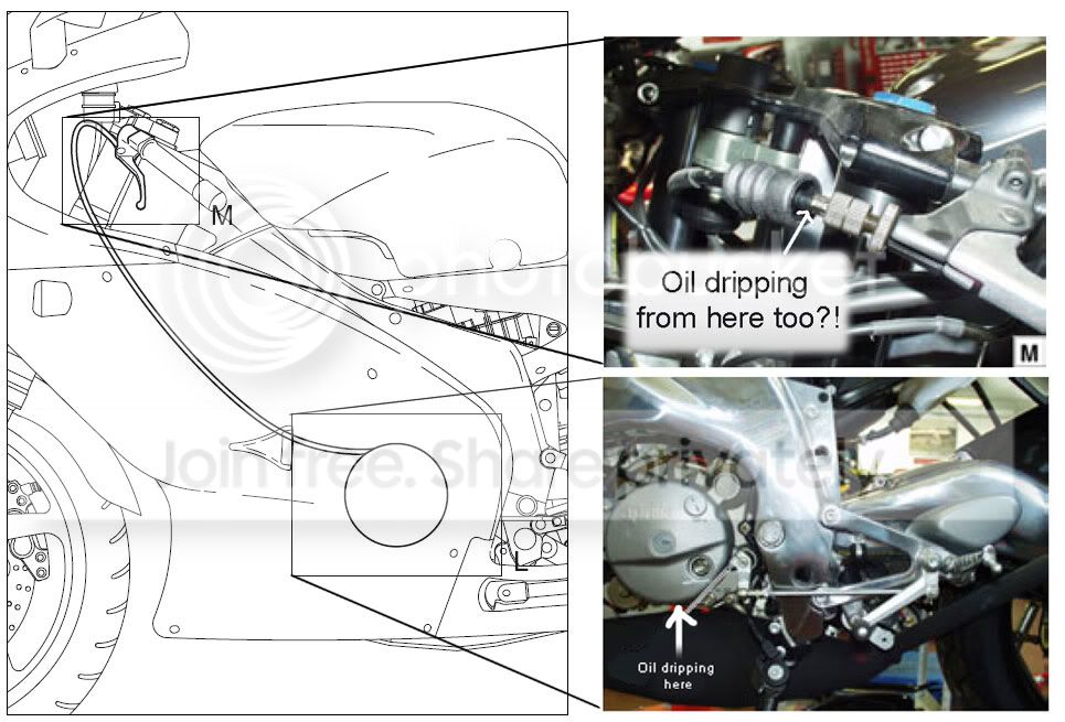

Well I have been working on the RS125 and nearly ironed out all the small problems with it that BCF has helped me out with. Even took it for a spin today and seemed to be working fine.
Problem is I keep getting this re-occuring oil leak which only seems to start when the bike is warm and I havent much of a clue what the problem is and not sure if I want to attempt it.
Below are some pictures from the workshop manual that I used to show where the oil is leaking from:
https://i31.photobucket.com/albums/c369/jinxyrs125/leak.jpg
The bike seems to be running ok apart from this leak, but I do not want to ride it in case it causes more damage so any ideas on what is causing the leaks or some advice from some more mechanically minded people would be great! Thumbs Up

Hi, looks to me that the gasket has gone on the engine casing, replace this and it should be ok. Thumbs Up

Leak from the bottom may well be the gasket. Check it isn't the oil drain plug, or possibly one of the plugs on the clutch cover leaking (the ones for adjusting the clutch).
Not sure why it is pumping oil out of the clutch cable. Only thing I can think of is the gearbox is getting pressurised. Possibly from the gearbox being overfull, or possibly a leaking clutch side main bearing seal.
