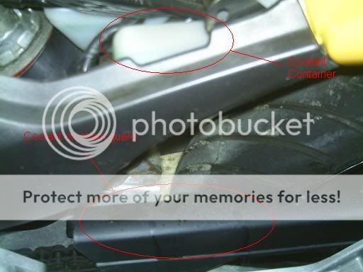

Arrow When I went out for a ride yesterday, there was some coolant on the chain guard underneath the coolant container. I checked the same place when I got back from my ride today and there wasn't any. Is this just because yesterday was the first time it had been out in ages?
https://i47.photobucket.com/albums/f186/markjackson13/coolant.jpg

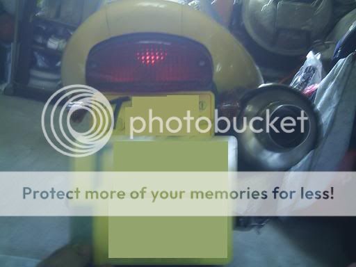

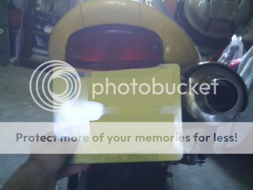

Arrow I got my legal numberplate today, but it's far too big for the bracket/indicator combination behind. The current (illegal Police) plate that's on at the moment fits perfectly in between the indicators, but if I put the legal plate on it'll cover up both indicators. I was thinking of getting a sheet of metal, or something similar, and screwing that where the current plate is. Then screw the big plate onto that, so it hangs under the indicators. Oppinions?
Current Plate

Legal plate blocking indicators
https://i47.photobucket.com/albums/f186/markjackson13/num2.jpg
Where the plate should go
https://i47.photobucket.com/albums/f186/markjackson13/num3.jpg
As the tank is at the 'low' pressure side of the system it's probably going to be OK. Was the tank overfull? Did you notice the temp' gauge rising abnormally at all? I would check that the clip that holds the outlet pipe on the tank is OK, looking at the (small) amount of spill and the position it seems to right below the tank outlet. Don't forget to re-check the level.

Last time I checked, the coolant seemed at a good level. I'm pretty sure it was nearly to the full line (although I'm not certain, will have to check tomorrow). I did re-seat the cap on the coolant container yesterday, so maybe it wasn't down right? Nothing abnormal with the temperature gauge.

Sounds like the coolant problem is nothing too serious to me. If it were you'd most likely have a loss each time you were out and the temp' gauge would be doing weird things. I reckon your brakes are probably OK too, but if in doubt, get them checked over - it's not worth the risk.

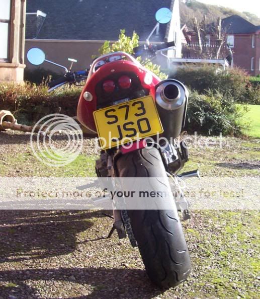

And to answer your other query.....flush mounted indicators. Smile Thumbs Up
Legal size plate + Powerbronze Undertray + Flush Indicators =
https://img.photobucket.com/albums/v612/greggreggreg/rear1.jpg
All purchased from www.jesterstrickbits.co.uk
I no longer own the hornet pictured so don't care about the number plate being visible!! Razz
