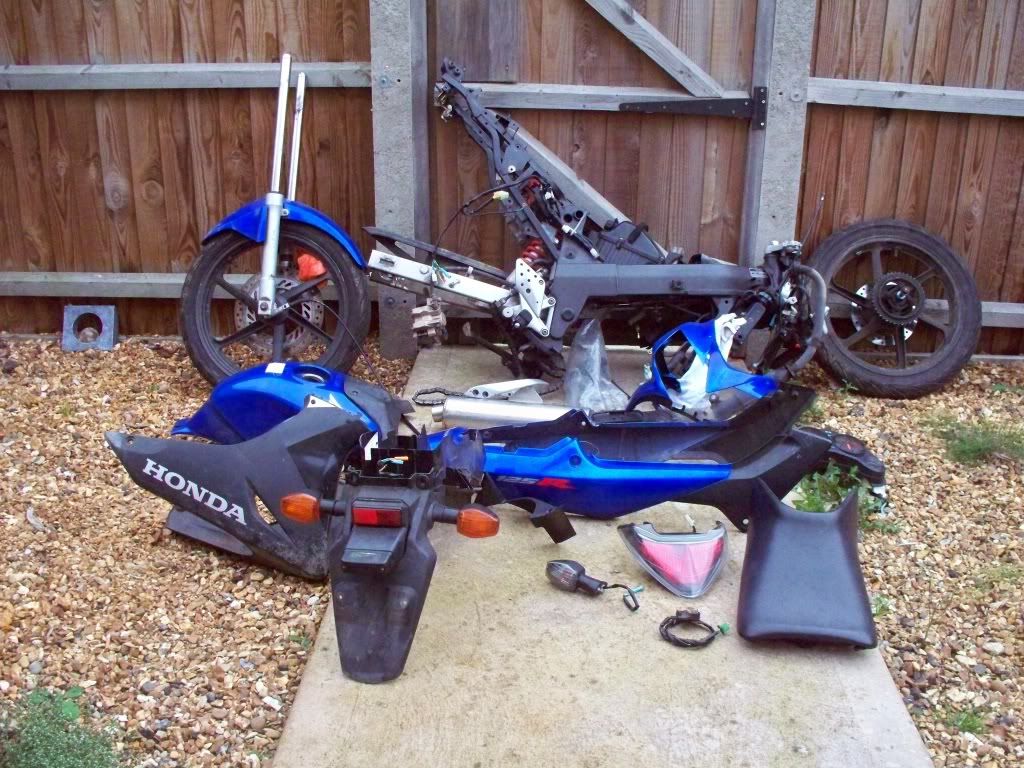

This is how the bike turned up at my door:
https://i231.photobucket.com/albums/ee125/carlosamillios/100_1291.jpg
To say i was shocked would be about right. All the bike needs to be useable is a front brake caliper/lever/mount/hose, new chain and a rear sprocket.

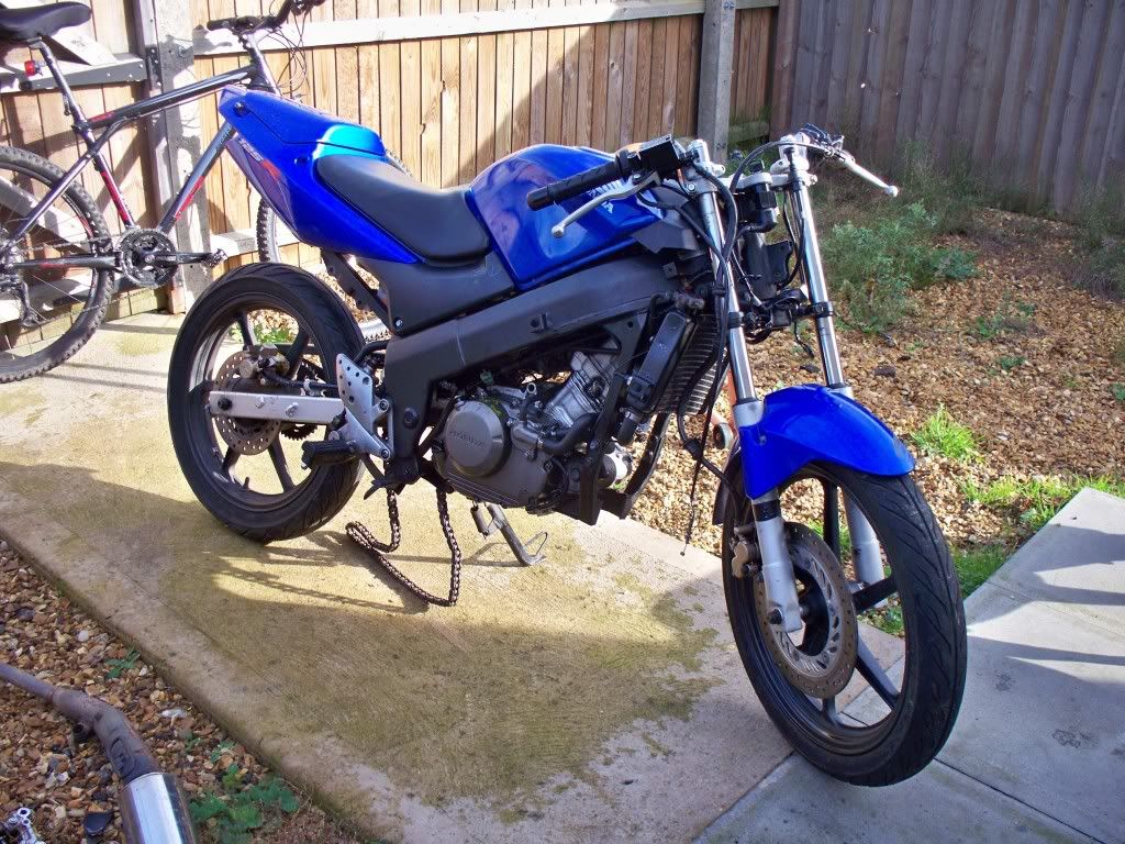

This is how the bike stood after half an hour of swearing and cursing trying to put it together on my own:
https://i231.photobucket.com/albums/ee125/carlosamillios/100_1292.jpg

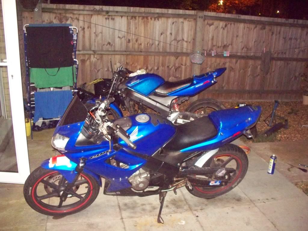

The road bike and the race bike, i will try my best not to pillage the road bike for spares, but that might be a different matter come race day.
https://i231.photobucket.com/albums/ee125/carlosamillios/100_1294.jpg

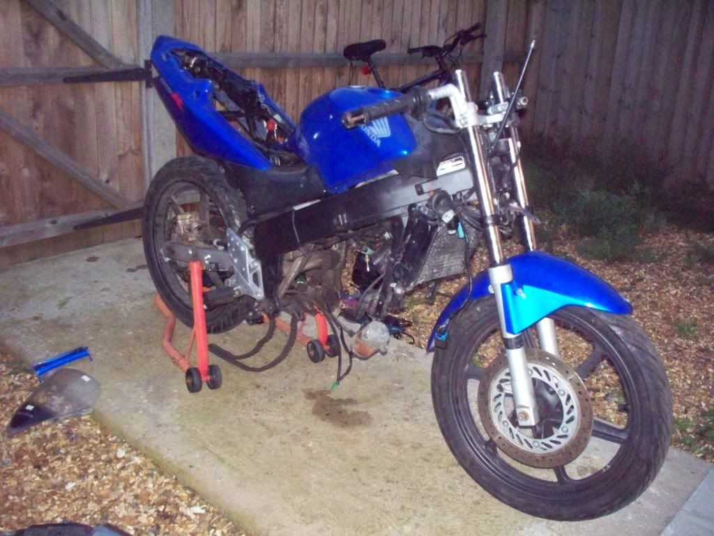

And how the bike stands currently:
https://i231.photobucket.com/albums/ee125/carlosamillios/100_1295.jpg
Will be grinding the rear subframe off along with all the unnecessary metal bits like fairing mounts and footpeg hanger mounts.

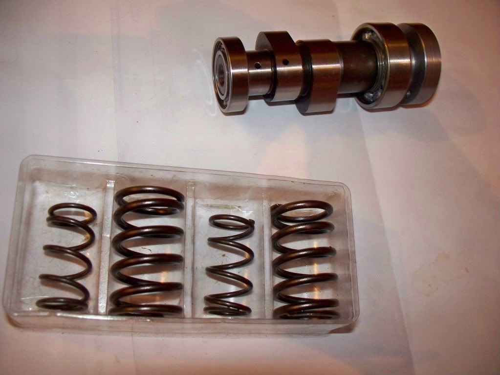

As soon as the engine turns up, these will be going in:
https://i231.photobucket.com/albums/ee125/carlosamillios/100_1303.jpg
Titanium valve springs and a 280 degree rotation 5.5mm lift race cam, will hopefully make a decentish increase in performance.

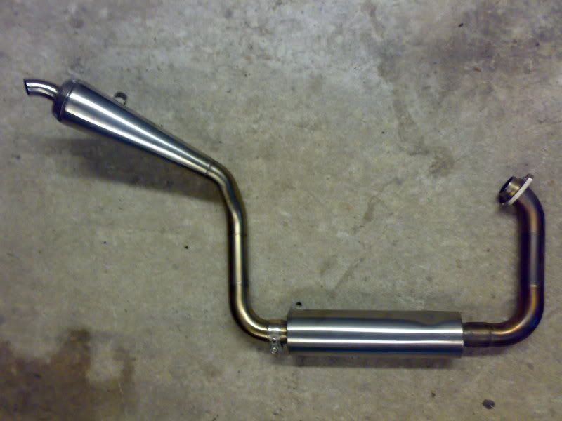

New exhaust on the way
https://i84.photobucket.com/albums/k28/donteatpeople/Mattphonepic2323.jpg
Also still have an Arrow system to do some back to back tests with, change of carb jets should see a nice little difference too.
BTW that silly baffle will be coming off but will keep it along with some rivets incase the bike fails noise testing.

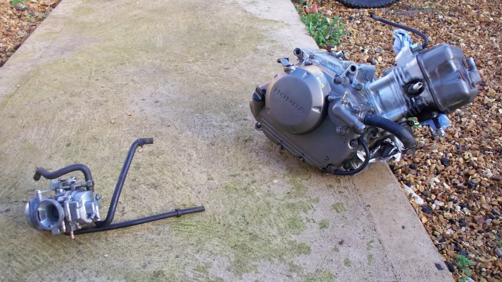

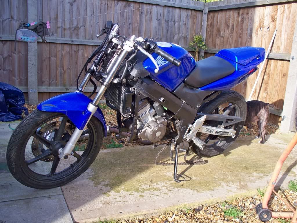

Starting to make a little progress today, had the engine, carb, petrol cap and key delivered so thought i would crack on straight away. Also managed to get a very good second hand caliper, brake hose and master cylinder for a bargain price so fitted that too, now i have brakes!
https://i231.photobucket.com/albums/ee125/carlosamillios/Bike/100_1343.jpg
Didnt have anyone to help so fitted the engine on my own. Quite easy to do as i have found. Lift the rear of the engine and put the rear mount in first, then just pivot the engine on the rear mount to mount the next, then bolt the brackets on and stick in the last mount, easy peasy.
This is how it looks at this very moment.
https://i231.photobucket.com/albums/ee125/carlosamillios/Bike/100_1344.jpg
https://i231.photobucket.com/albums/ee125/carlosamillios/Bike/100_1345.jpg

WRC exhaust?
As in weller racing corporation? My best mates dad is the one who makes those exhausts.
They aint to loud but there very deep.

Yeah WRC exhaust Steve-d. Does he still make them? I may be interested on some more but since the site went down i havent been able to get hold of them.
Steve-D
Joined: 07 Jul 2007
PostPosted: 15:09 - 04 Nov 2010    Post subject: Reply with quote
Yea the two of them fell out since pete was the one doing all the work making the exhausts and tony couldn't do any of it but got half the money they made.
Sure he could still knock them up, he's working on his own now still making exhausts and other fabrication work.
Will get his no and pm you.

Ol
Joined: 07 Aug 2009
PostPosted: 16:26 - 04 Nov 2010    Post subject: Reply with quote
Hmmmm... Chain looks a little slack !!!!!
