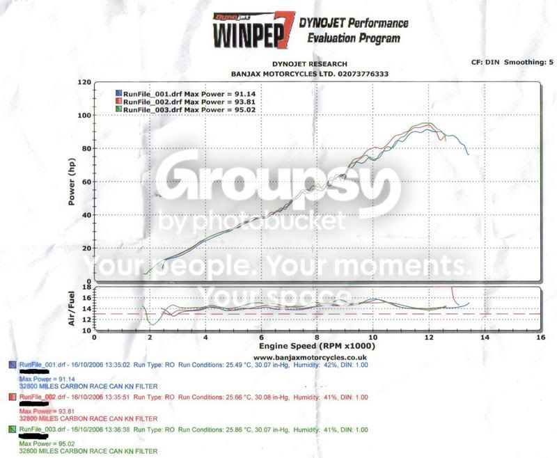

lads i could really do with some help here coz iv gotta upjet as its running VERY LEAN & the std mains i pulled out r like this...
carb 1 = 135
carb 2 = 132.5
carb 3 = 132.5
carb 4 = 135
is that right for my bike??
& when i up jet by 2 sizes should i do them up EXACTLY by 2 sizes so there 137 X2 & 134.5 X2? or should they all be same sizes??

its got a race can & a K&N filter but THEN i got it dynoed after tht(well the pipe was already on there) but it showed it being VERY LEAN!

he also showed me 2 diff jets 1 being std & 1 being a dynojet jet & iv got my carbs near me right now & stripped them down & the jets DO look like the dynojet 1's he showed me! but how do you tell if there dynojet 1's?
these main jets just have a letter "R" on them & next to tat is a square Confused
i can post up the results but the optimal air/fuel mixture is 14 & mine on goes on tht @ 2thou revs after tht it raises more & more & @ 10thou revs its on 16! Shocked DANGEROUSLY LEAN!

ok fit the jets theyve suggested. wouldnt worry about identifying dynojet jets. Its sounds like it was jetted up for the exhaust. When youve fitted the k&n it needs jetting up again usually. As for mixture settings on your pilot screw only more dyno time will get it spot on (sure someone will disagree though Laughing )

iw as told that if going up 2 sizes on the mains & it wasnt enuff then after doing tht raising the needles should sort it
i dunno cause that would be best way just the cost would be madness cause its a run on dyno(money) then setting up(more money) then re dyno ing again (EVEN MORE)

hopefully the place where you had it dynoed should be giving you the right info from experience and known settings. So going up two sizes should be right if thats what theyve reccomended. Then its just fine tuning.
I know dyno time is expensive ( had a load of engine work done on my k1 for racing and was for ever back and forth after fitting new bits ) but its the best way to get it set up correctly.

its in only 1 of them but its not were the main screws in to it, its the other end were the actual tube screws in to the carb & its THAT thread thats got a split
https://img.photobucket.com/albums/v232/DJLUX/GSXR/SRADdynoresultedit.jpg
check the LEAN in THAT!
