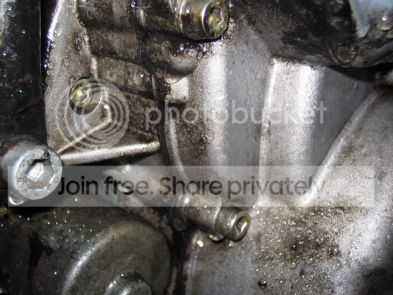

okay, iv taken the fairings off and their was oil all over the front of the transmission casing, so iv cleaned it with a pressure washed and cloth to try and see where its coming from, looks like its leaking out of the casing, see below
https://img.photobucket.com/albums/v626/i_am_tim/IMG_0628.jpg
does this mean the seals need replacing? or is there something less drastic that can be done? im starting to worry about seizing gears now..... Shocked

Walloper
Joined: 24 Feb 2005
PostPosted: 19:40 - 08 Nov 2006    Post subject: Reply with quote
Get some gunk into that and get it 'clean'.
Check fluid levels.
Run it till it's warm and dry.
Look around the engine with a good light source.
Try spraying the joints with a Dry Deodorant spray to show up wet patches.
But you will need to take time to clean it. Properly.... Evil or Very Mad
We have rules about dirty Kit on this forum Laddie. Laughing
Has the engine been 'cooked'?

yeah thats a before pic.....
its not exactly sparkling now, but its better than that
nah its hasnt been used more than before, i always let it warm up properly before using it, i mean a few drops of oil wouldnt worry me if it wasnt the fact that the gears could seize

THCi
Joined: 28 Sep 2004
PostPosted: 22:54 - 08 Nov 2006    Post subject: Reply with quote
Jet washing over a gasket can never be good. Might have caused the problem in the first place.

Paddy Blake
Joined: 29 Jun 2006
PostPosted: 00:04 - 09 Nov 2006    Post subject: Reply with quote
Is there a power valve type thing on the front of the cylinder at the
exhaust port that might have a blown seal.

ddracer
Joined: 31 Oct 2006
PostPosted: 15:05 - 09 Nov 2006    Post subject: Reply with quote
Hi there,
That is gunk leaking from the power valve assembly. Inside the valve housing the is a valve stem seal as the valve and seal wear it starts to leak, just change it and all will be ok. It's also worth cleaning the valve blade as this will improve engine response.

quik_d
Joined: 18 Mar 2005
PostPosted: 12:38 - 11 Nov 2006    Post subject: Reply with quote
ddracer wrote:
Hi there,
DD
Second that theory, thats what mine did Thumbs Up
