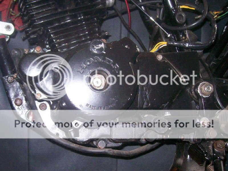

Sump plug.... down there, infront of gear lever. Remove, allow to drain.
https://i178.photobucket.com/albums/w269/teflons-torque/Little%20Dreams/LD07%20Eng%20Build/104_0267.jpg
Primary cover 'off'
Oil strainer where I'm pointing with spanner.

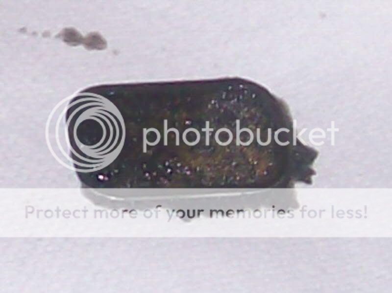

https://i178.photobucket.com/albums/w269/teflons-torque/Little%20Dreams/LD07%20Eng%20Build/104_0269.jpg
dirty strainer, about the size of a matchbox, as it will come out
https://i178.photobucket.com/albums/w269/teflons-torque/Little%20Dreams/LD07%20Eng%20Build/104_0270.jpg
CAREFULLY scrape the 'worst' of the crap off it.
https://i178.photobucket.com/albums/w269/teflons-torque/Little%20Dreams/LD07%20Eng%20Build/104_0271.jpg
Clean meticulousely, with washing up liquid and a 'soft' toothbrush!
Refit by reversal of removal!
Make sure sump plugs back in
ADD OIL
and with a bit of luck you wont kill the main bearings like you did on your CM!
