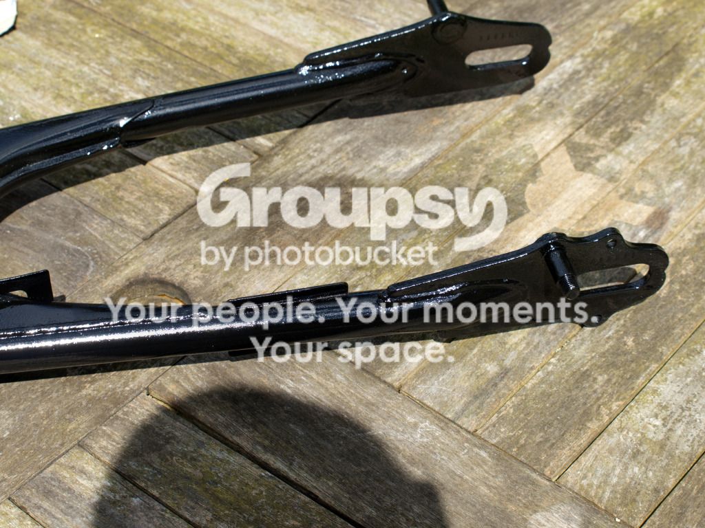

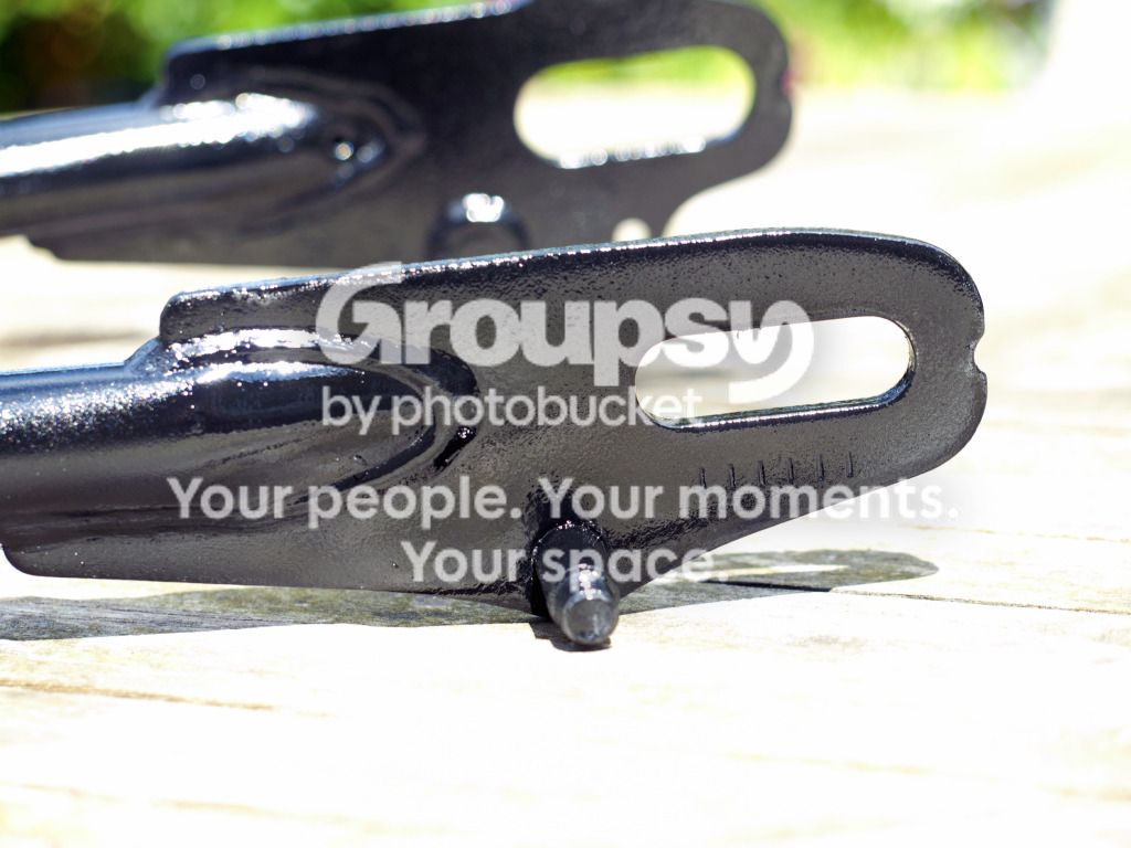

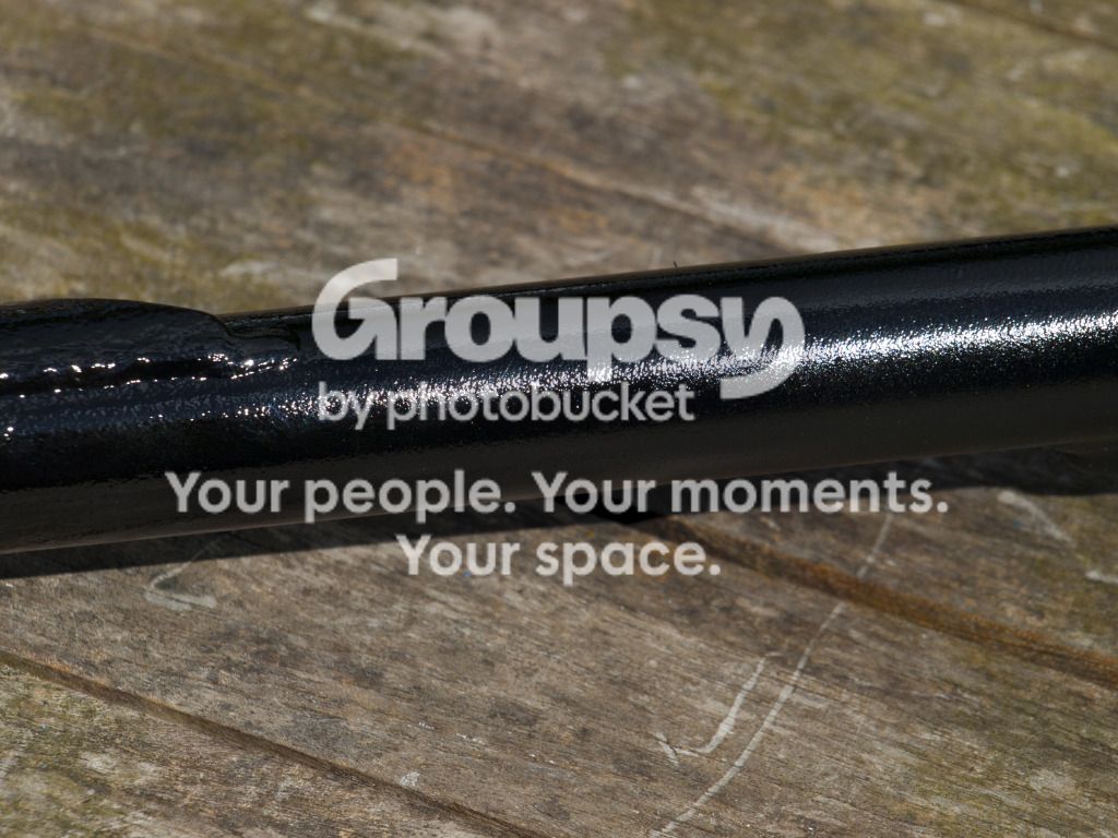

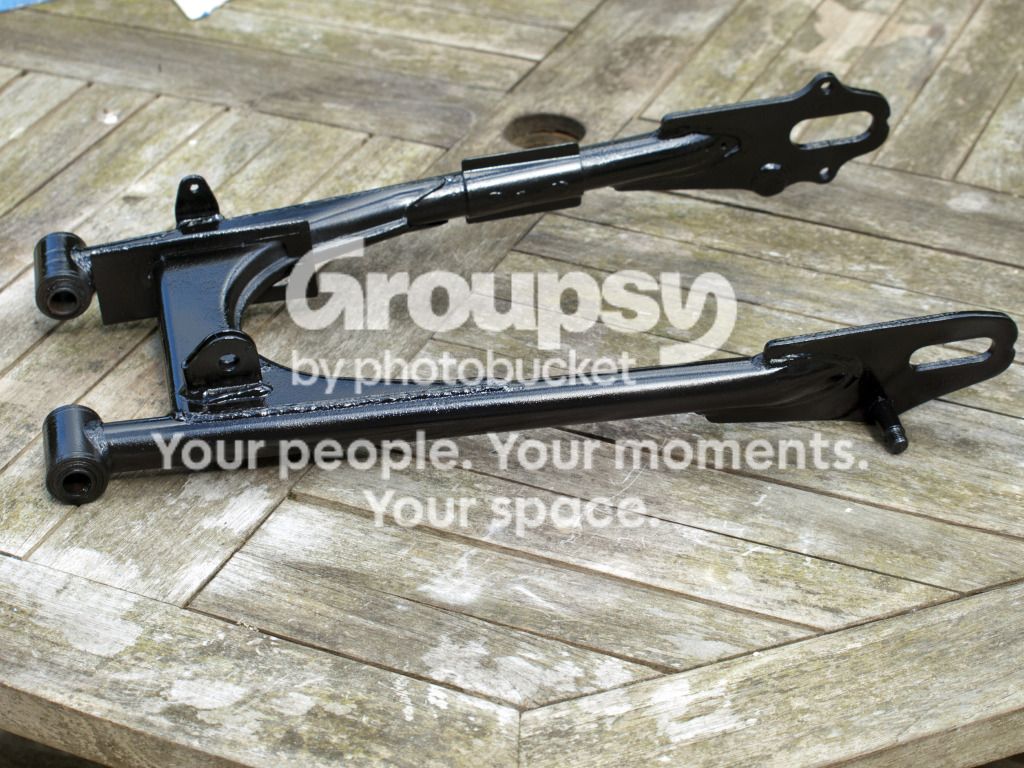

Painted the swinging arm yesterday. Put literally no effort into preparation so the finish isn't brilliant, but I'm not going for concourse standard.
This will do for me. Smile

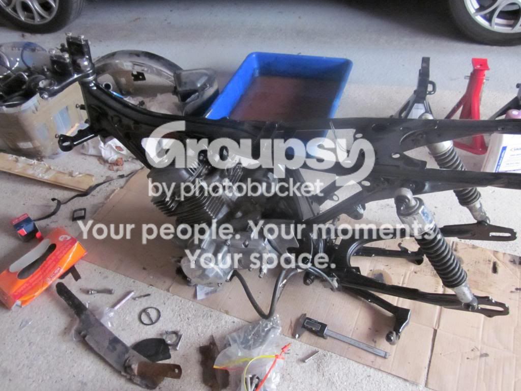

Stripped the rest of the bits off the frame so i can start removing the paint.

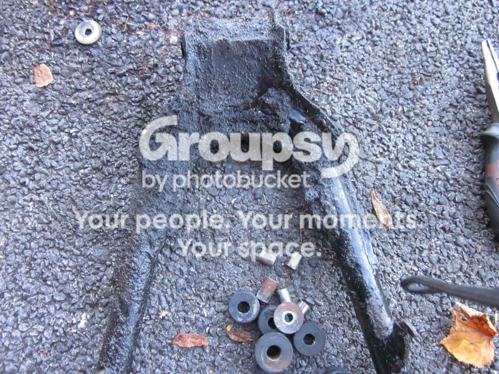

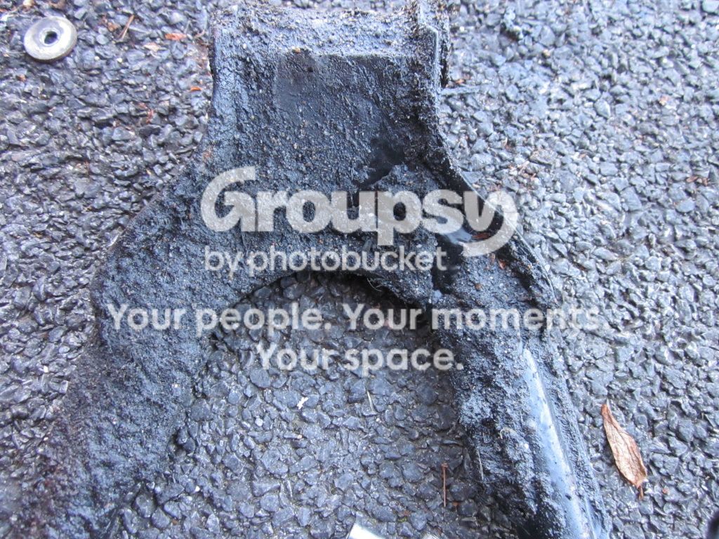

Centre stand was so caked in crap that it was blending in with the tarmac. Laughing Nothing was seized though thank god.
https://i1135.photobucket.com/albums/m637/Biles/CD200%20Project/IMG_0782.jpg
https://i1135.photobucket.com/albums/m637/Biles/CD200%20Project/IMG_0781.jpg

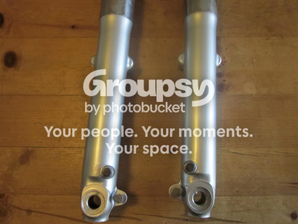

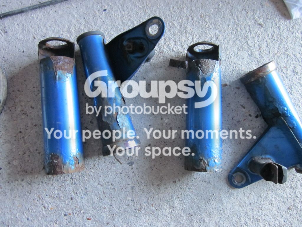

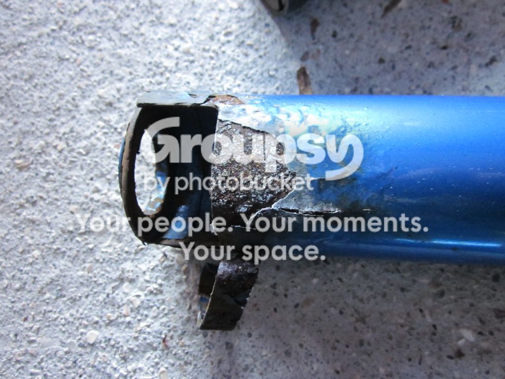

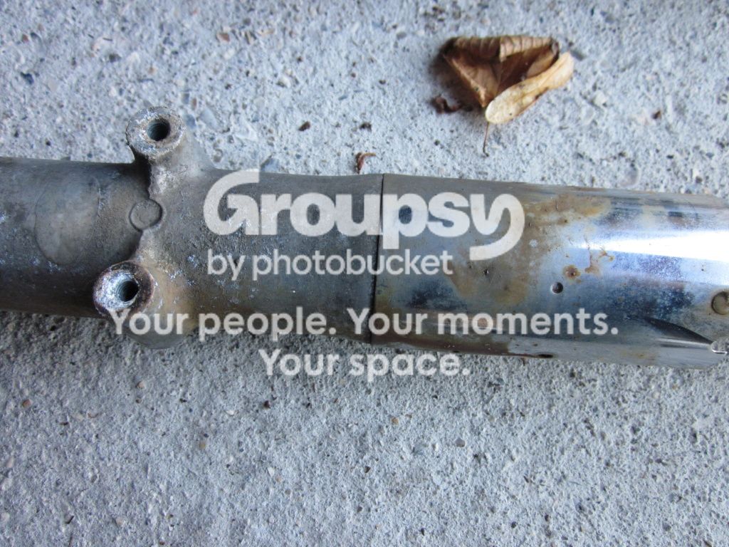

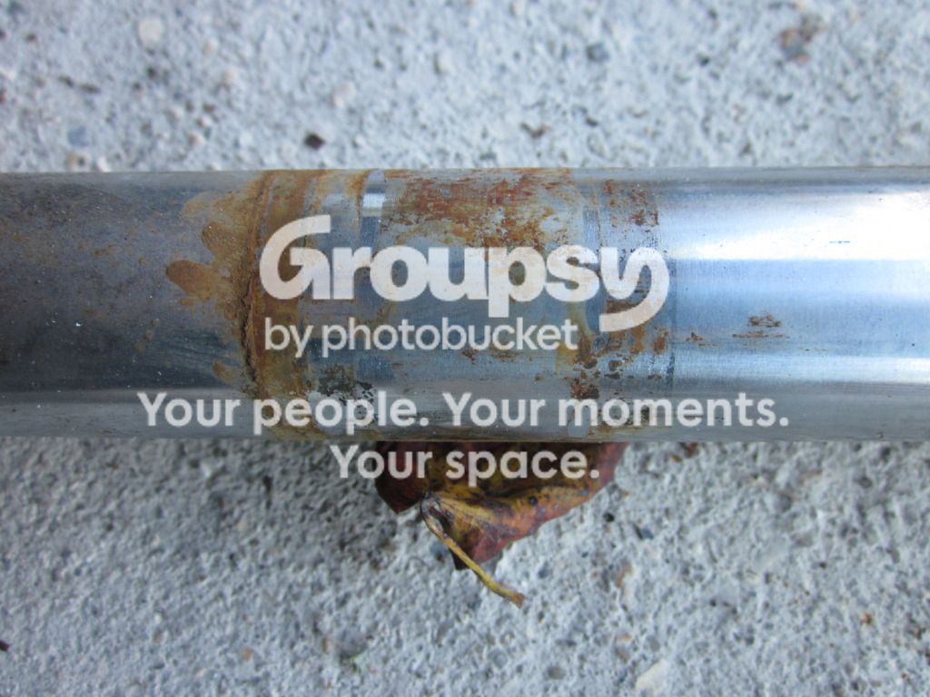

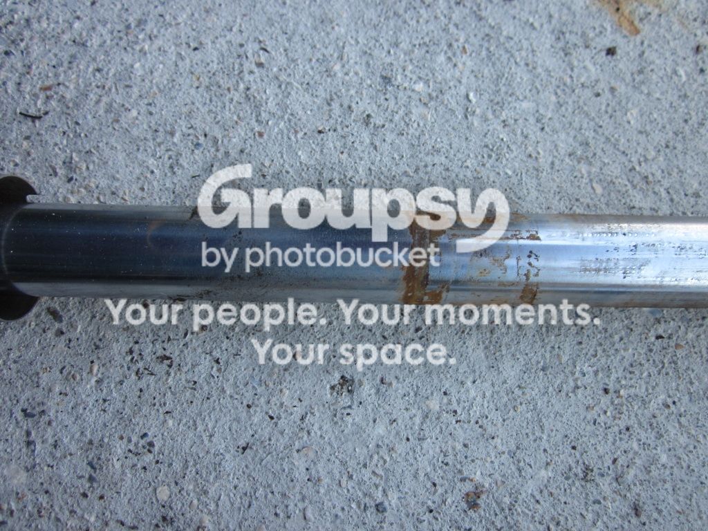

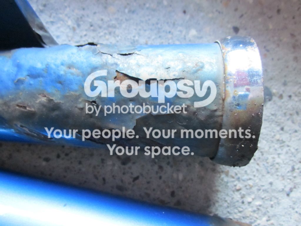

Forks and covers were very rusty, what's everyones view on these, can they be saved? Is it worth saving them?
https://i1135.photobucket.com/albums/m637/Biles/CD200%20Project/IMG_0788.jpg

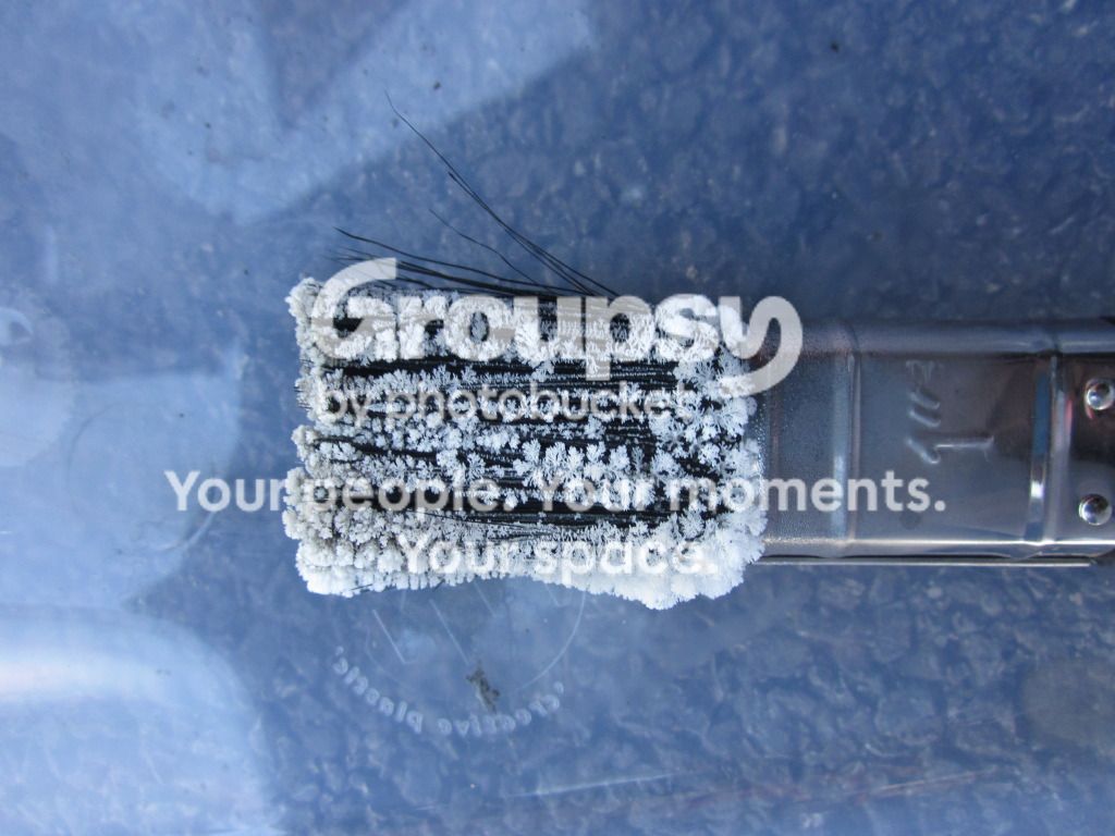

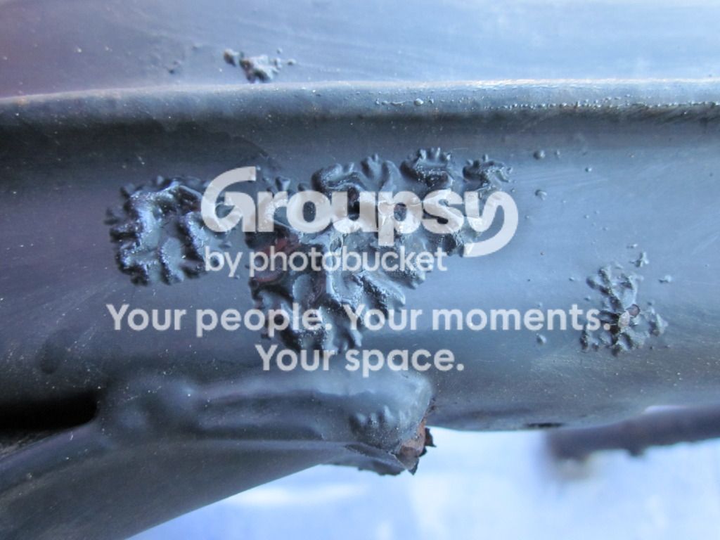

I then started stripping the frame using Dichloromethane (the stuff they took out of Nitromors making it terrible). Brilliant stuff, paint starts bubbling and peeling in seconds (see picture) however it does say "WARNING WILL CAUSE CANCER" on the side of the bottle, so I would be careful. Laughing
https://i1135.photobucket.com/albums/m637/Biles/CD200%20Project/IMG_0783.jpg
Also make some funky crystals on the brush.
https://i1135.photobucket.com/albums/m637/Biles/CD200%20Project/IMG_0791.jpg
thanks, and now we know why it's terrible!
will have to look for another fav paint stripper! everything in B&Q and halfords is crap.

My fork covers (cd175) looked like them, nothing a good stripping and rubbing down wont fix. Must get around to my CD200 rebuild (one day)
Do you think the stanchions look recoverable?
There is quite a lot of rust.

Aff wrote:
Read an article in Classic motorbike the other day where they fill the indents with JB Weld (metal epoxy), might be worth a try, at the end of the day if the legs are smooth and the seals dont leak, its a pass.
Well they weren't leaking, so they will either be OK, or have no oil in them. Laughing

Aff wrote:
Either way, strip them down, and double check, new seals, new oil

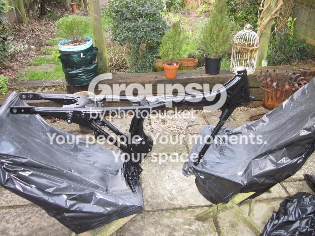

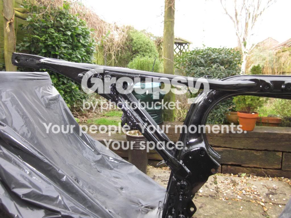

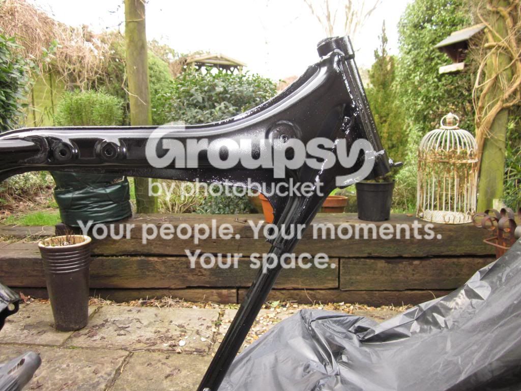

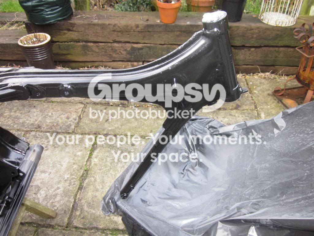

Well I've really been slacking since the accident. But there's finally been some progress.
Finally got round to finishing the frame.
Once again not a concourse finish, but for the cheapest rattle cans money can buy I am thoroughly impressed with the finish.
https://i1135.photobucket.com/albums/m637/Biles/CD200%20Project/IMG_0007_zps80c2cf78.jpg
https://i1135.photobucket.com/albums/m637/Biles/CD200%20Project/IMG_0008_zps1659d5b9.jpg
https://i1135.photobucket.com/albums/m637/Biles/CD200%20Project/IMG_0009_zpsd2aaf215.jpg
https://i1135.photobucket.com/albums/m637/Biles/CD200%20Project/IMG_0010_zpsaec0e6ab.jpg

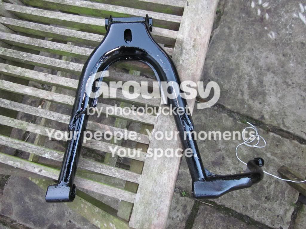

Centre Stand started like this:
After
https://i1135.photobucket.com/albums/m637/Biles/CD200%20Project/IMG_0015_zps20de44f5.jpg

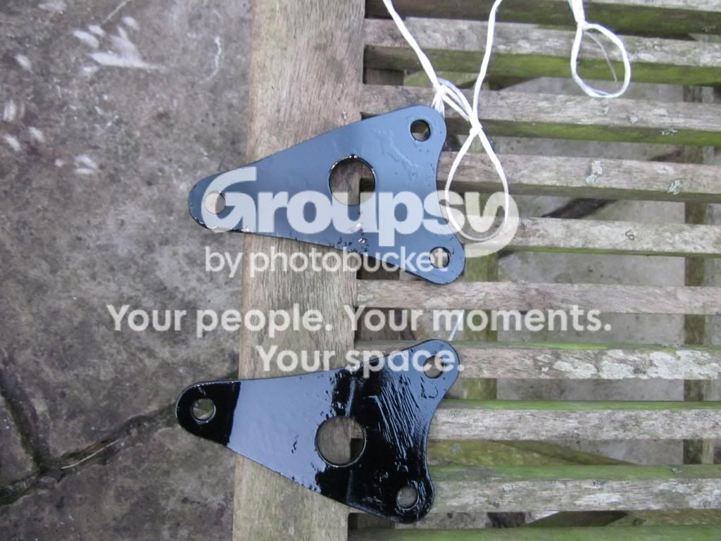

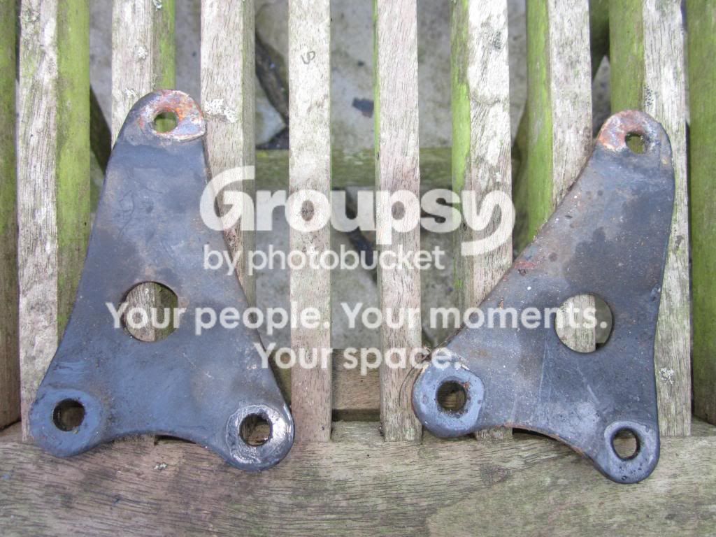

Engine Mounts:
https://i1135.photobucket.com/albums/m637/Biles/CD200%20Project/IMG_0014_zpsc1923f7d.jpg
https://i1135.photobucket.com/albums/m637/Biles/CD200%20Project/IMG_0016_zpsde3cbe81.jpg

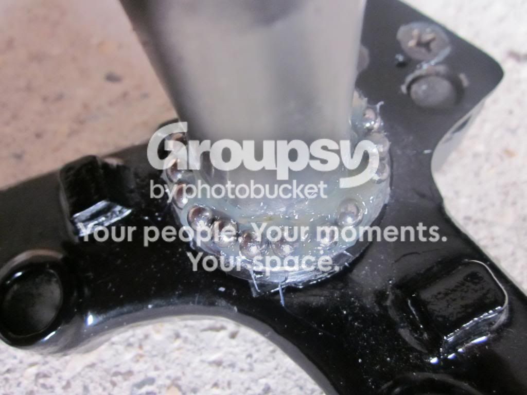

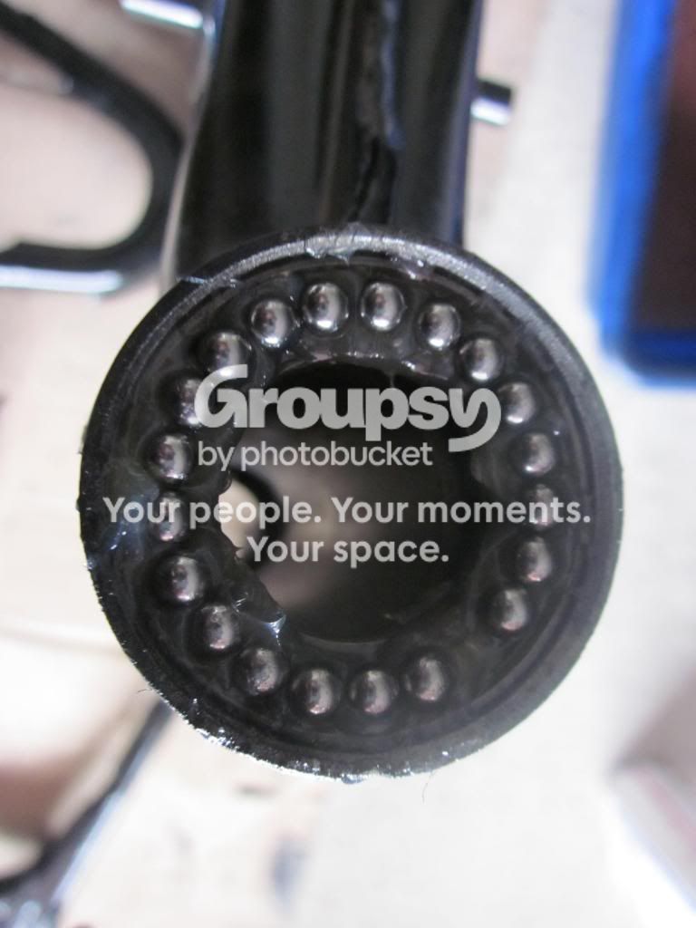

Lower bearing cone packed with grease and new ball bearings (3/16" for anyone wondering). Leave space for 1 extra ball bearing so that they roll, rather than slide next to each other.
https://i1135.photobucket.com/albums/m637/Biles/CD200%20Project/IMG_0065_zpsaaca46a0.jpg

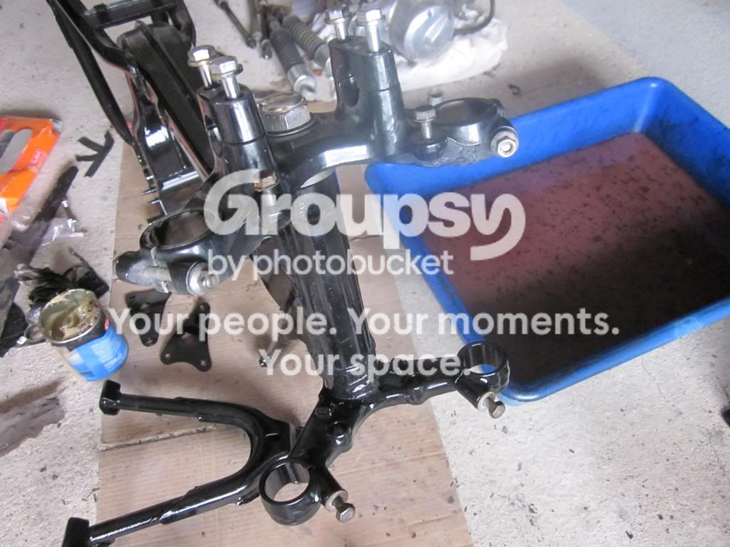

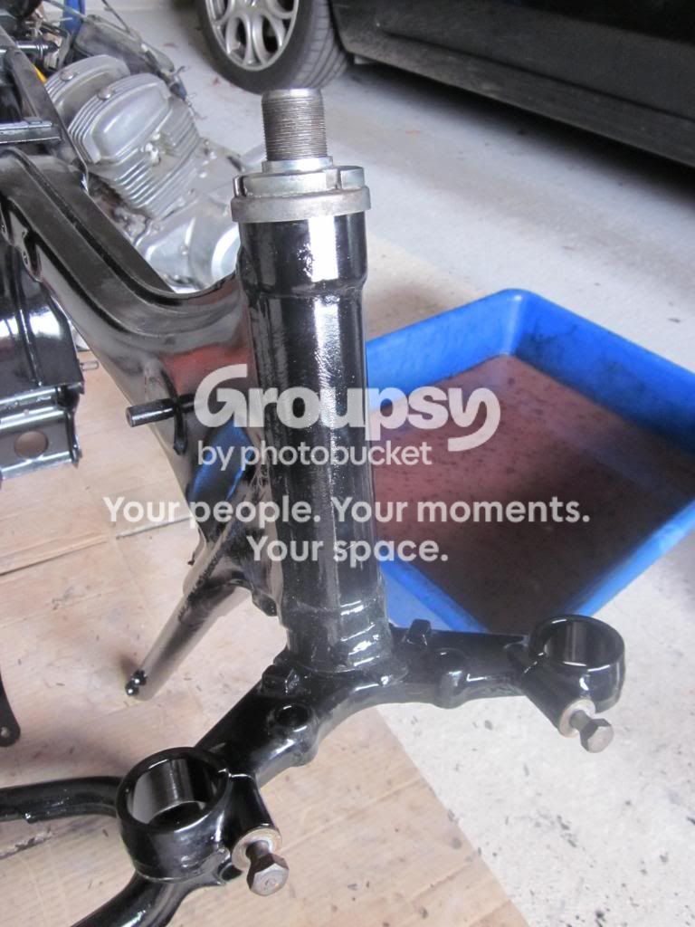

Bottom yoke in and bearing adjuster ring thing put on and tightened.
https://i1135.photobucket.com/albums/m637/Biles/CD200%20Project/IMG_0069_zpsfd97c32c.jpg
Top Yoke on.
https://i1135.photobucket.com/albums/m637/Biles/CD200%20Project/IMG_0071_zpscb3ae8ee.jpg

do they not make a tapered roller bearing that you could use instead of those crappy ball type ones, on the headrace
the humans are dead
I kick arse for the lord
Aff
Joined: 05 May 2011
PostPosted: 09:16 - 26 Apr 2013    Post subject: Reply with quote
Yea, but I don't want to spend £40 on bearings, that's 25% of what the bike cost. Laughing

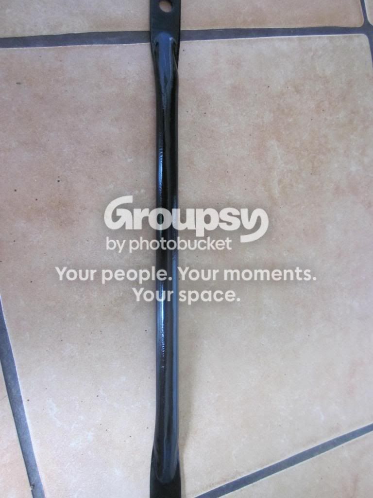

Rear torque arm painted:
https://i1135.photobucket.com/albums/m637/Biles/CD200%20Project/IMG_0095_zps3135720a.jpg
