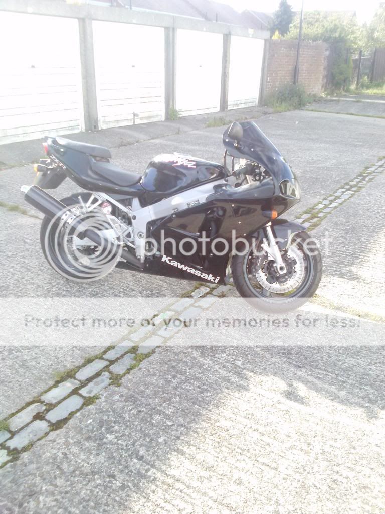

Only crappy pic for now, will get more in coming days
It has no mot, something i learnt 2 hours. After riding about oooop. Also a few starting gremlins which i think is down to being stood for a while.
https://i300.photobucket.com/albums/nn6/ElScampio/CAM00240_zps3e8e64cb.jpg

Looks good, I only wish I had black wheels on mine. I'd go green for the rest of the bike, what do you think? Thinking Smile
