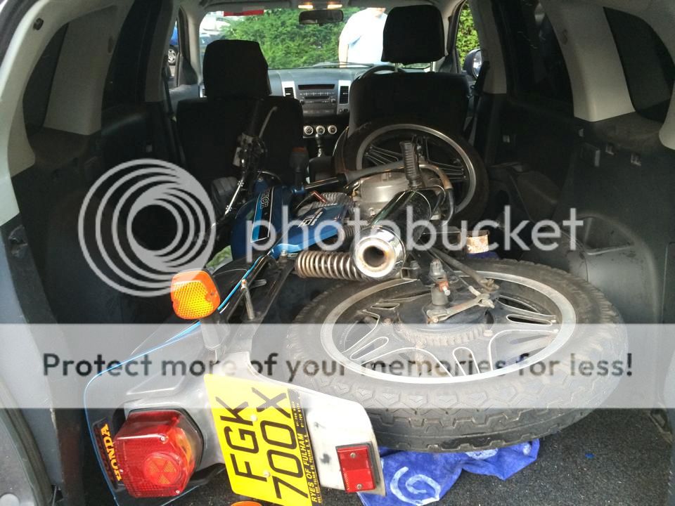

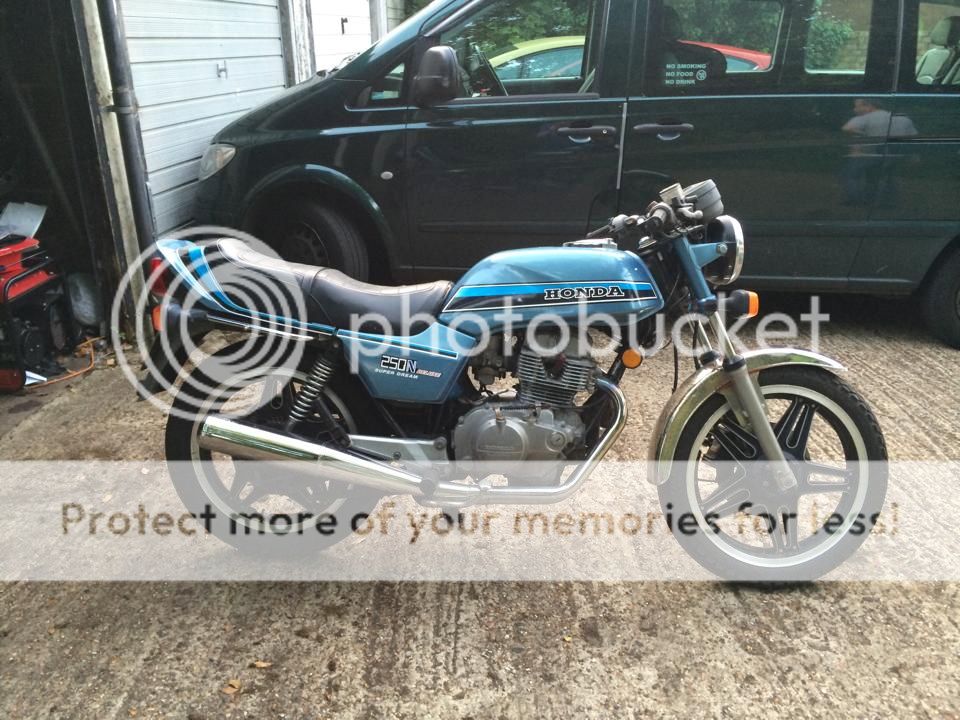

This came up 0.5 mile from where I work. It'd been into the local rip off garage, charged 12 hours (reduced to 5), to tell him new CDI. Bought brand new CDI and brand new coil, but it didn't run. Listed as such on the ad, spent about £600 and gave up. I went over with a spare battery, and it fired up almost first go. Lumpy, as the carbs were gummed up. But it ran. Picked it up in a 4x4 and brought it home. £200 lighter. Still taxed until the end of the month, MOT expired. Needs a new rear tyre (cracked) and some bulbs for MOT. Everything else is tip-top, apart from some surface rust on the mudguard and rotten under the seat (the seat itself, not frame) it's near perfect. 7,900 miles on the clock and the condition suggests it's genuine. These are a love/hate bike, but a classic in this condition ('82 vintage) and at this price, awesome. Plan is, clean it up and get it running right. Then use it.

I like it a bit too! It's a bit of 80's Honda mini Eurostyle lets pretend CB900F, which IMO is a good dream to have! Smile

That looks in exceptional nick for the money OP (colour doesn't look standard though) I would be tempted to get an MOT and flip it immediately, should turn a tidy profit.
As usual, bang on. Did a check, and only flag was has had a colour change. No idea what it was though.
Quite like it though. I can use it for a while and when fed up, just sell on easily.

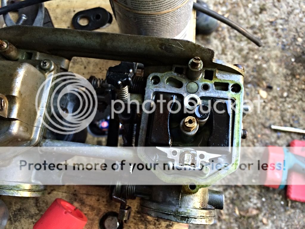

Anyway, Marmalade was over last night so we inspected the carbs. Nice colour.
https://i1312.photobucket.com/albums/t525/wotsthestory/CB250N/AB5FECA8-366C-4F05-9156-F4C2C1CAC83A_zpsbun1duhl.jpg~original
Cleaned them up, some of the jet screws look as though they'd been mullered a bit. Cleaned it all out and it runs beautifully, but it's bogging after 4K, when hammering down through the gears after building speed it will actually use the upper end of the rev range. Taking the carbs to bits fully and ultrasonic clean them. See if that helps. Brakes work, well as good as I imagine them too. Just need to find a rear tyre, then into MOT.

There should be a VIN plate somewhere on the frame (can I see it just below the reflector on the downtube?) with a paint code on it, which would be easy enough to translate, I've a got list of paint codes somewhere.
The popular colour for a repaint was Candy Bourgogne Red, which faded like mad and didn't like petrol, they tended to go silver on the top of the tank, where the petrol vapour took the pigment out of the lacquer and revealed the base coat underneath (Tanzanite Blue did that as well).
Pay careful attention to those carbs, I think I had mine apart and ultrasonic cleaned two or three times, before I got it running right and not puking fuel out of the overflows.
I particularly advise paying a little bit more and using genuine rebuild kits, not pattern stuff, which isn't much cheaper and uses wildly inferior materials, especially the float bowl seals.
Any links to this sort of stuff? I don't want to pay a lot, but I don't want to buy stuff twice. It was really cheap and I'm not wanting to spend too much on it. Also, when I took the top off the carbs, the spring for the needle plunger felt really weak.
Shaft
Joined: 27 Dec 2010
PostPosted: 22:20 - 13 Jun 2014    Post subject: Reply with quote
This lot are the usual go to for Honda spares
https://www.davidsilverspares.co.uk/
When I took mine apart, it was obvious they had never been touched and I could've reused the original seals, but decided to go for some cheap rebuild kits instead; when I had to take them to bits again a couple of days later, the new seals were so swollen, they were almost unusable.
I don't remember the springs being especially strong on mine, but I don't think it's a part that's known for wearing out.

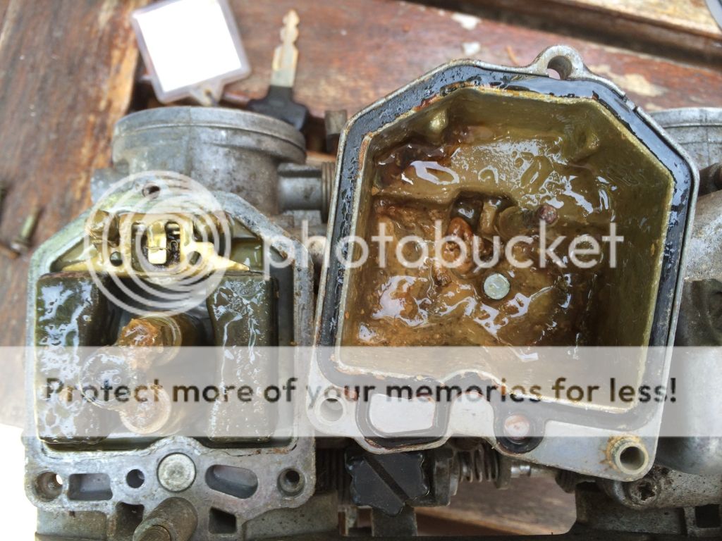

Got a spare set of carbs off eBay, they've arrived. I was planning on making the best from both. But think I'll use the new ones as they are?
