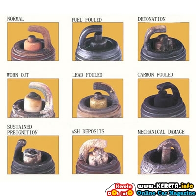

Moving onto your second problem, it sounds like the bike is running rich if you have some throttle delay. Would I be correct in assuming there's only a delay once it warms up; the bike runs better cold than when warm? If so, the bike is most likely running rich.
Aside from the million different "symptoms" which a bike displays when running rich, I always find the best way to determine the mixture is correct is by checking the colour of the spark plugs. Note that you will need to check the colour of the spark plugs after a ride (doesn't have to be straight after the ride of course), this is because the plugs need to get up to "self cleaning", the temperature when the carbon fouling is cleaned from the plug's insulator and you can get a true representation of the mixture from the carbs. From memory a NGK spark plug's self cleaning temperature is 450 degrees, don't worry too much about the temperature, just make sure you take the bike out for a long ride before checking the colour of the plugs.
Here's a chart to compare your plugs to: https://kereta.info/wp-content/uploads/2009/07/spark-plug-colour.jpg
Right, so you've verified whether whether the engine is getting the correct air/fuel mixture, next step is adjusting the mixture screw as recommended in your service manual (2 1/2 turns out as you say). I've found this to be a good video to watch if you haven't got much experience on making adjustments to a mixture screw, it explains what to listen out for etc: https://www.youtube.com/watch?v=YxpQjDQzX7g

According to the spark plug chart one plug seems to be normal:
https://s9.postimg.org/dtuwpbx7z/IMAG0151.jpg
The other plug is slightly burned on the ceramic, which i cant find in the chart. But IMHO i would say its because this one was on heavy duty while the other one was working on low performance?:
https://s29.postimg.org/em71d1odz/IMAG0152.jpg
Both carbs seem to have different mix settings but only by a 1/4 of turn.
