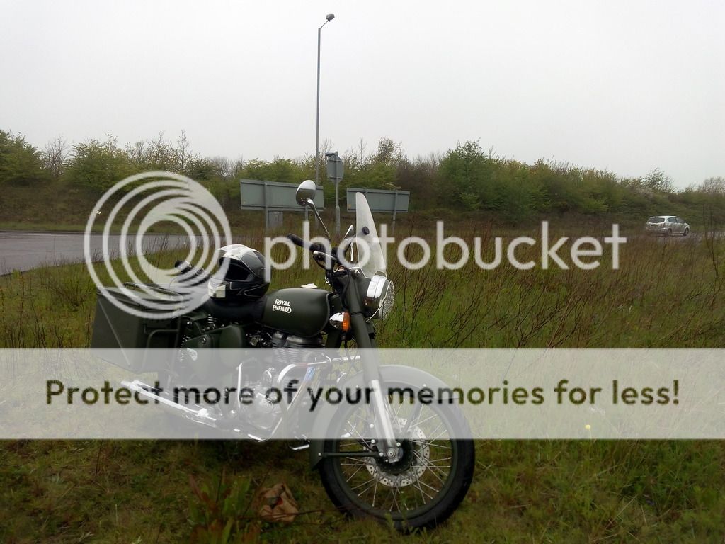

picked up a stomp at the weekend after following this thread for a while.
just ordered some bits from Bens Bikes and some things from ebay to tidy it up
looks quite nice next to my grom Smile
