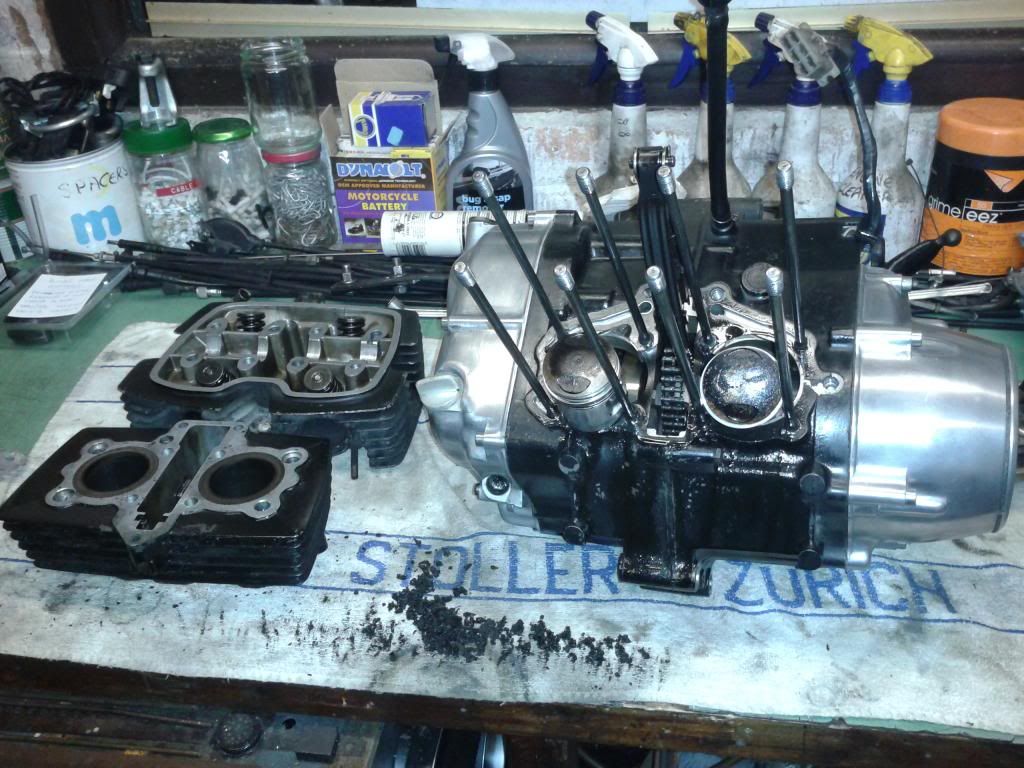

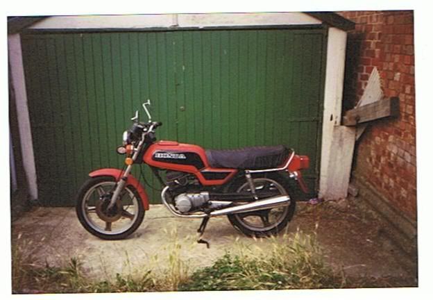

I am in the process of slowly (read VERY slowly Evil or Very Mad ) rebuilding my CB125T2.This was how I first bought it many years ago.Bit of a state Shocked
https://i666.photobucket.com/albums/vv23/WiNot_Rhencullen/CB125T2/LatterDays039.jpg~original
I have had the engine running,only to find that the piston skirts are severely scored and that the valve guides are beyond help.

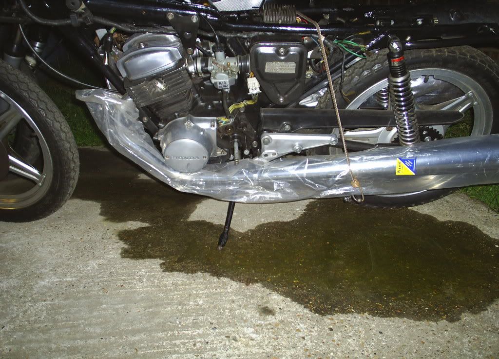

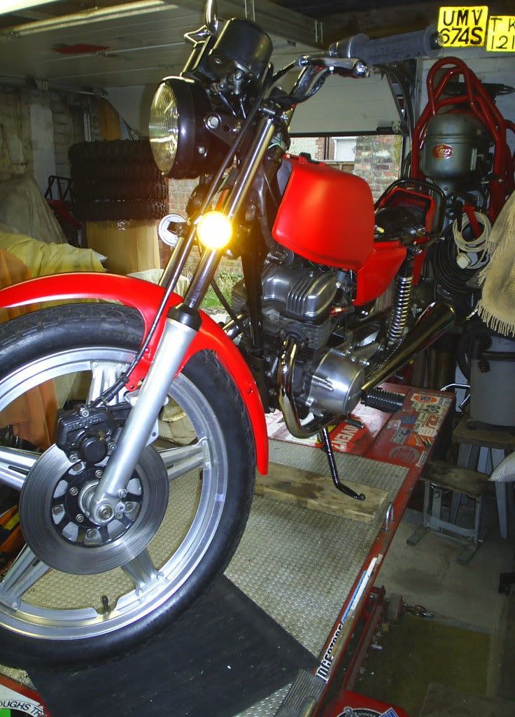

As for the sidestand,I found one from another bike,which may well have been from a CD185 that I scrapped a while ago.I used two engine mount bolts to secure the bracket through redundant holes in the bottom of the engine cases
https://i666.photobucket.com/albums/vv23/WiNot_Rhencullen/CB125T2/Picture019.jpg~original
https://i666.photobucket.com/albums/vv23/WiNot_Rhencullen/CB125T2/Picture389.jpg~original
