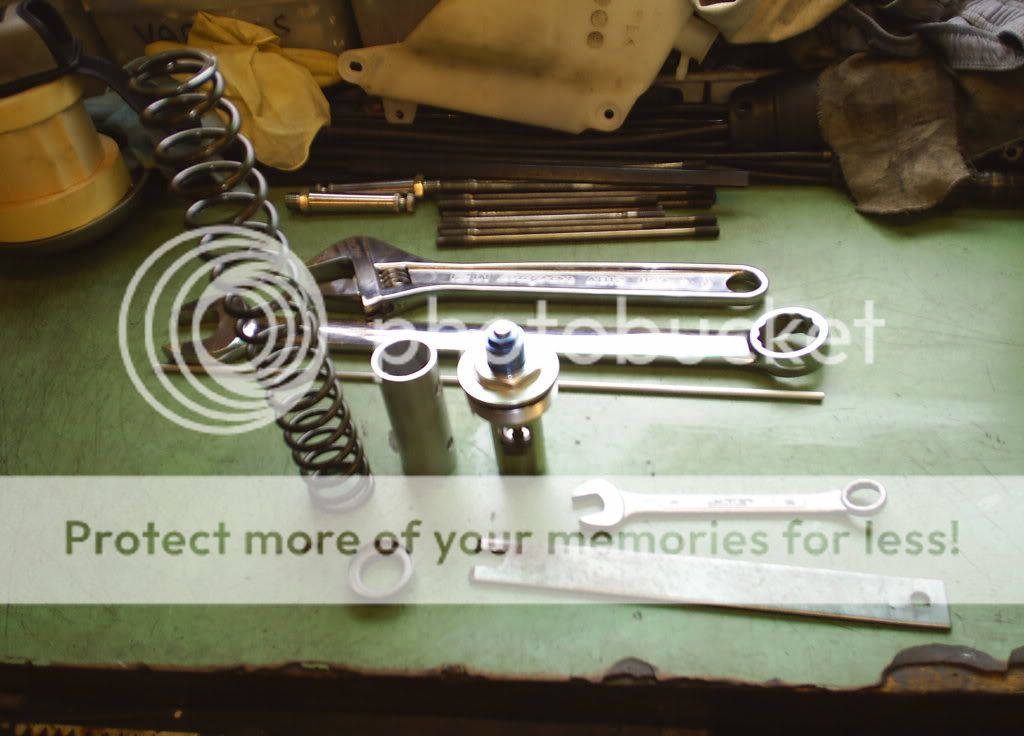

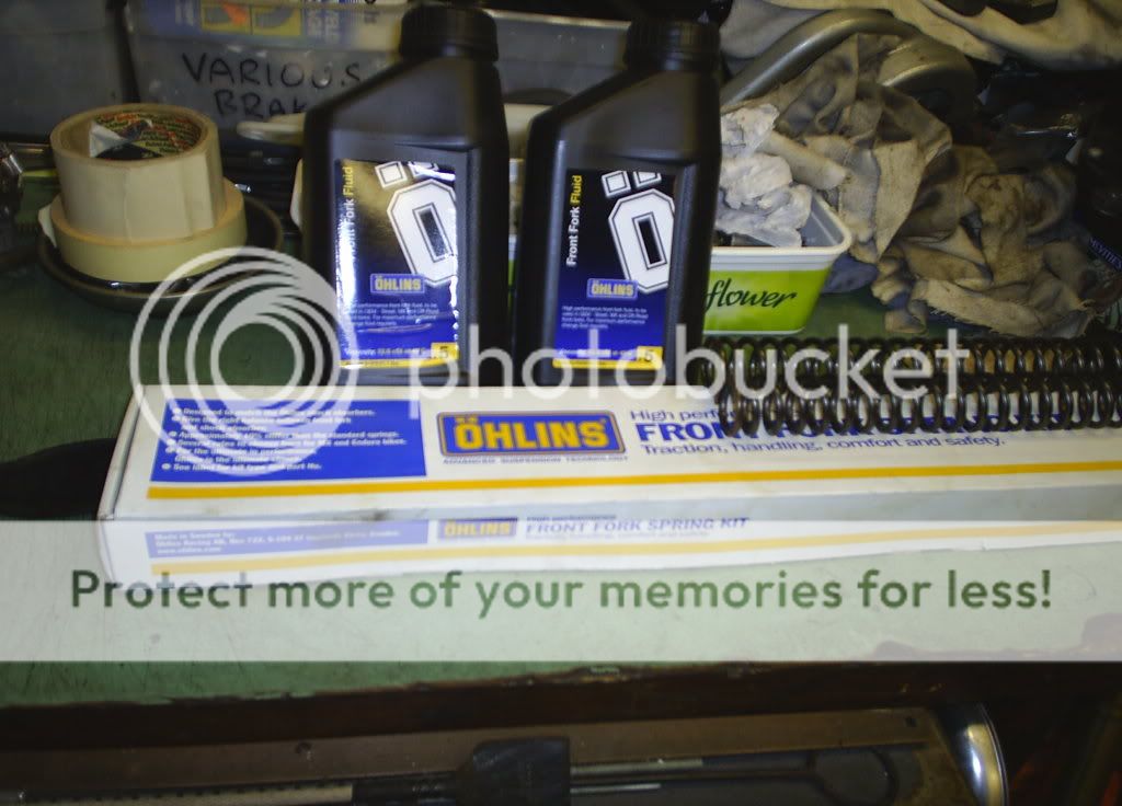

I used Ohlins 5w when I replaced the fork springs at the same time

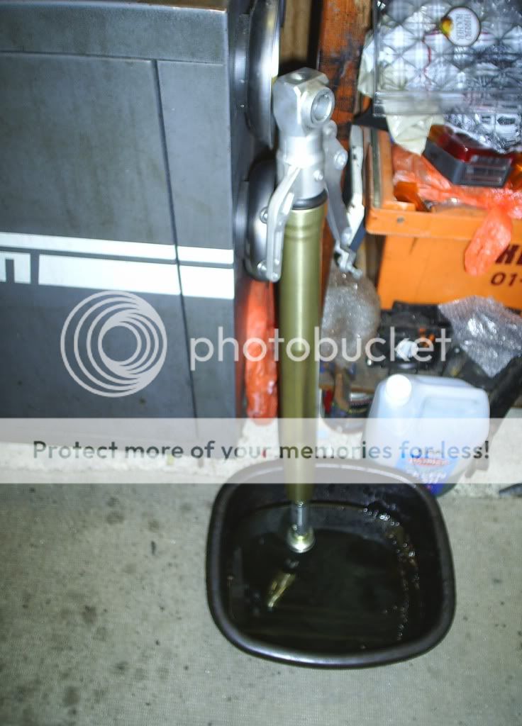

If only draining the oil I used a cheap thin oil to flush out the cartridge before pouring in the quality oil
https://i666.photobucket.com/albums/vv23/WiNot_Rhencullen/Workshop/Picture479.jpg~original

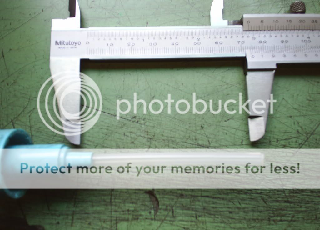

I then made up a tool for measuring the air gap before inserting the new fork springs

Motorex is another quality oil if Ohlins is not easily available Thumbs Up

The air gap tool was made out of a soap dispenser pump and a suitable length of tube,depending on the measurement required.Just fill to just over the amount specified,pump the cartridge and add more if necessary.Works a treat and costs pennies Thumbs Up Wink
If you find 5w too light and 10w too harsh,then mix equal amounts to get 7.5w Wink
