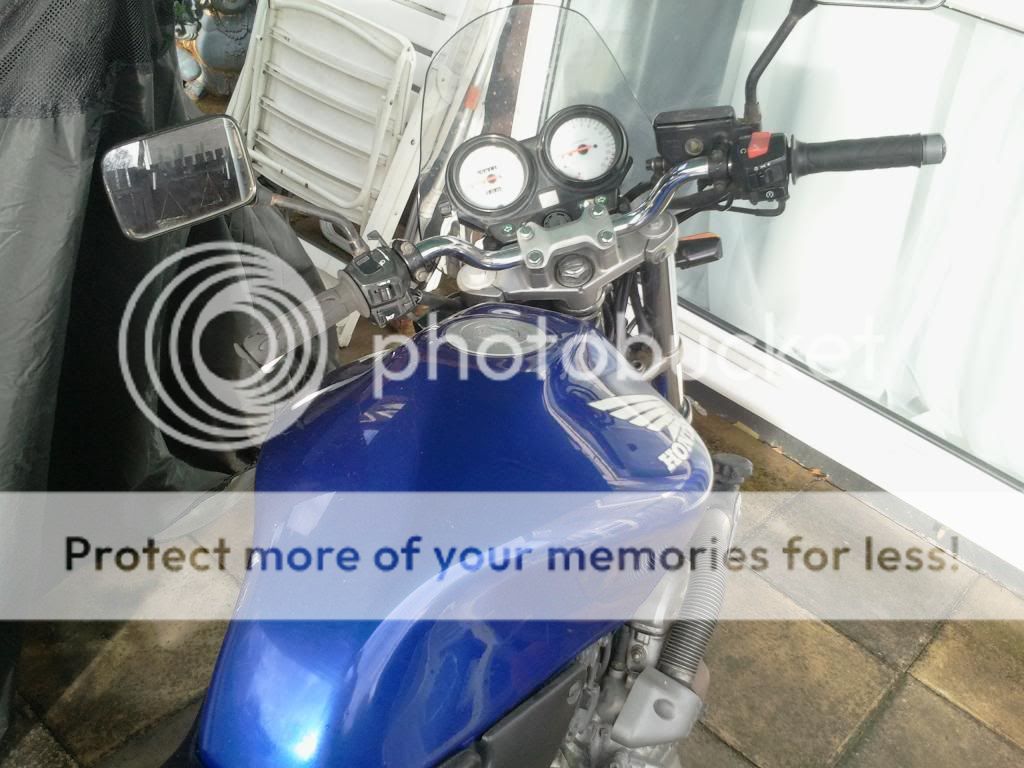

Went all the way to Norwich (absolute cunt journey) to pick up this:
https://i47.tinypic.com/1hw500.jpg
A Honda Hornet 600cc 1998. Needs a lot of TLC, new rear tyre and a general service but I'm very pleased to call this mine!

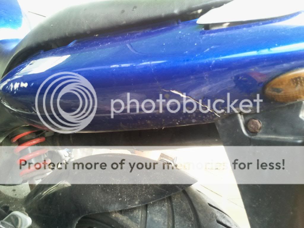

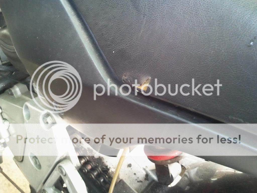

Seat damage
https://i77.photobucket.com/albums/j69/willyrobbie/2012-12-03120629.jpg

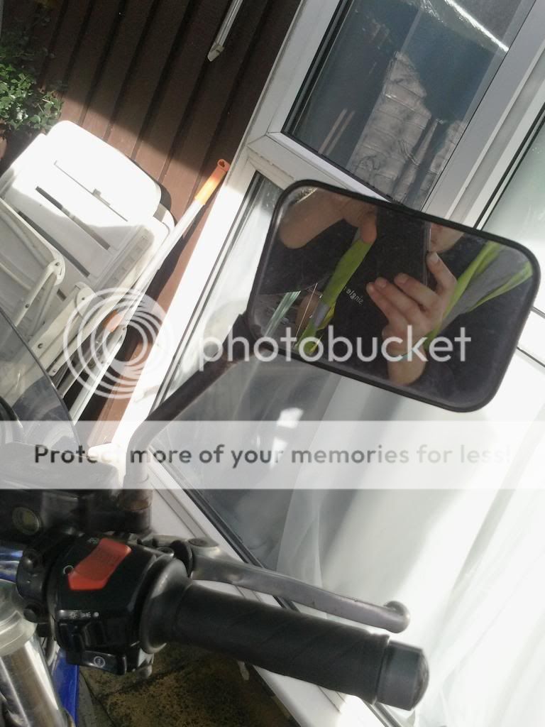

These wing mirrors are going!
https://i77.photobucket.com/albums/j69/willyrobbie/2012-12-03120546.jpg

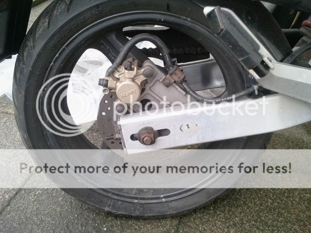

Needs a new rear tyre
https://i77.photobucket.com/albums/j69/willyrobbie/2012-12-03120523.jpg

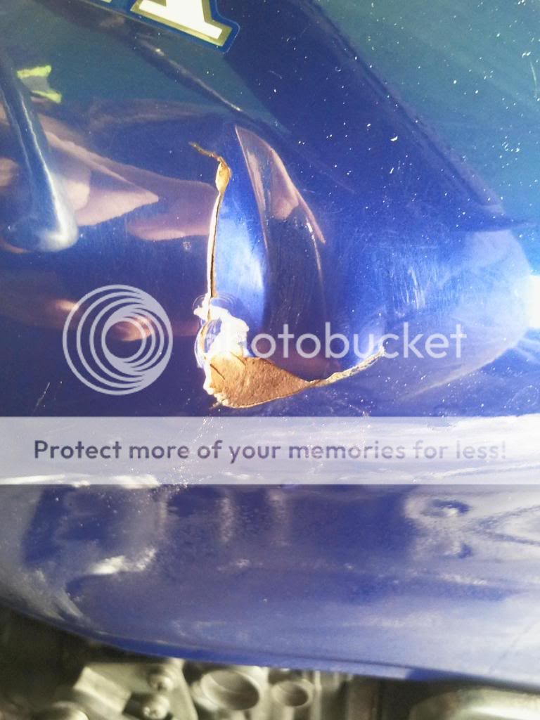

Dent in the fuel tank - how the fook am I going to fix this??
https://i77.photobucket.com/albums/j69/willyrobbie/2012-12-03120509.jpg

Whats up with the rear tyre? It doesnt look square and looks like it has plenty of tread on it
That dent :O
Filler and paint ?

That rip in the seat is easily fixed, i recovered mine myself, piece of piss.
Have a look on youtube and there's a load of how to's

iMark wrote:
That dent :O
Filler and paint ?
Do explain? I'm a numpty with anything to do with painting
The rear tyre has a puncture

And it was just a guess about fill and paint.
I was meaning, use a filler compound to fill in the dent, then just repaint the tank, not sure what sort of filler you'd use to fill in a metal tank with though... never done anything like this O.o

Yeah, for the tank you'd be looking to use filler and respray the thing. You'll likely be sanding the whole lot down to do it too.
Can it not be patched? looks like a good tyre to see you through winter then replace it at the start of the good weather?

Nope - it's pierced somehow!

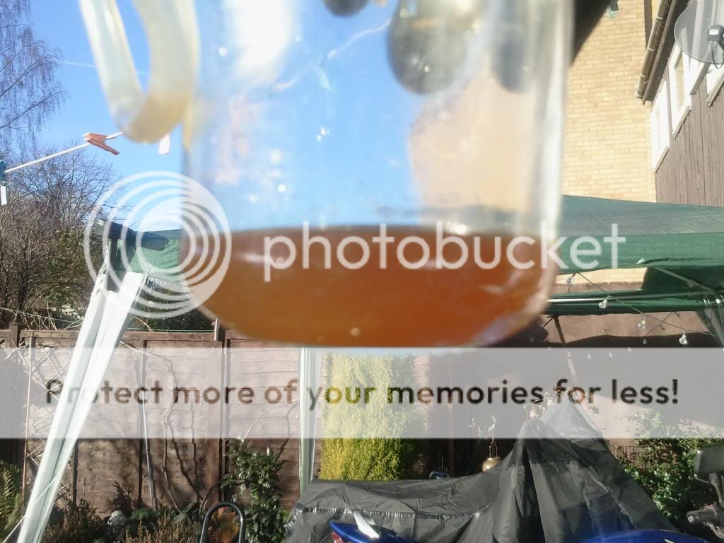

The rear caliper wasn't seized (fluid actually in the reservoir LOL), so I removed the caliper, cleaned, refitted (after refitting my rear wheel, pics to follow) and re-bled. Working perfectly Thumbs Up
My new air compressor is gagging to be used, the pistons simply wont budge back down the bore, so I'm gonna blast the fuckers out Laughing

The old fluid from the rear, looks pretty nasty!
https://i77.photobucket.com/albums/j69/willyrobbie/2012-12-12235222_zpsf048f3db.jpg

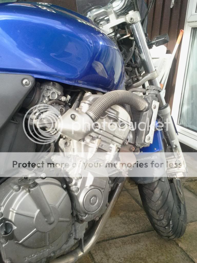

4) Air box removed from the bike - I am leaving the brakes on hold for now as I am now moving to the fuel system and engine
5) Carbs still attached, need to try and get them out!
6) Removed the spark plugs for inspection - all OK. Going to drop small amounts of clean engine oil down the holes for the piston rings to make better contact with the cylinder wall after 2.5 years of not moving.
7) Fit the shitty restrictor kit
8) Remove float bowls and clean - won't bother with the whole carb assembly just yet.
9) Tipped the fuel tank upside down to remove the stale fuel (no spanner for the petcock lock nut) and it was literally dark ORANGE. I really hope there is not any rust in the tank! It was pretty full up. Left the fuel to evaporate. Got fresh fuel and system cleaner waiting.
10) Replace the fuel hoses as I bloody snapped them..way too short!
11) Fit new battery
12) Lube all control cables, fit new wing mirrors (lovely chrome ones)
13) Fit carbs, air box (air filter clean as anything) AND FIRE!!!

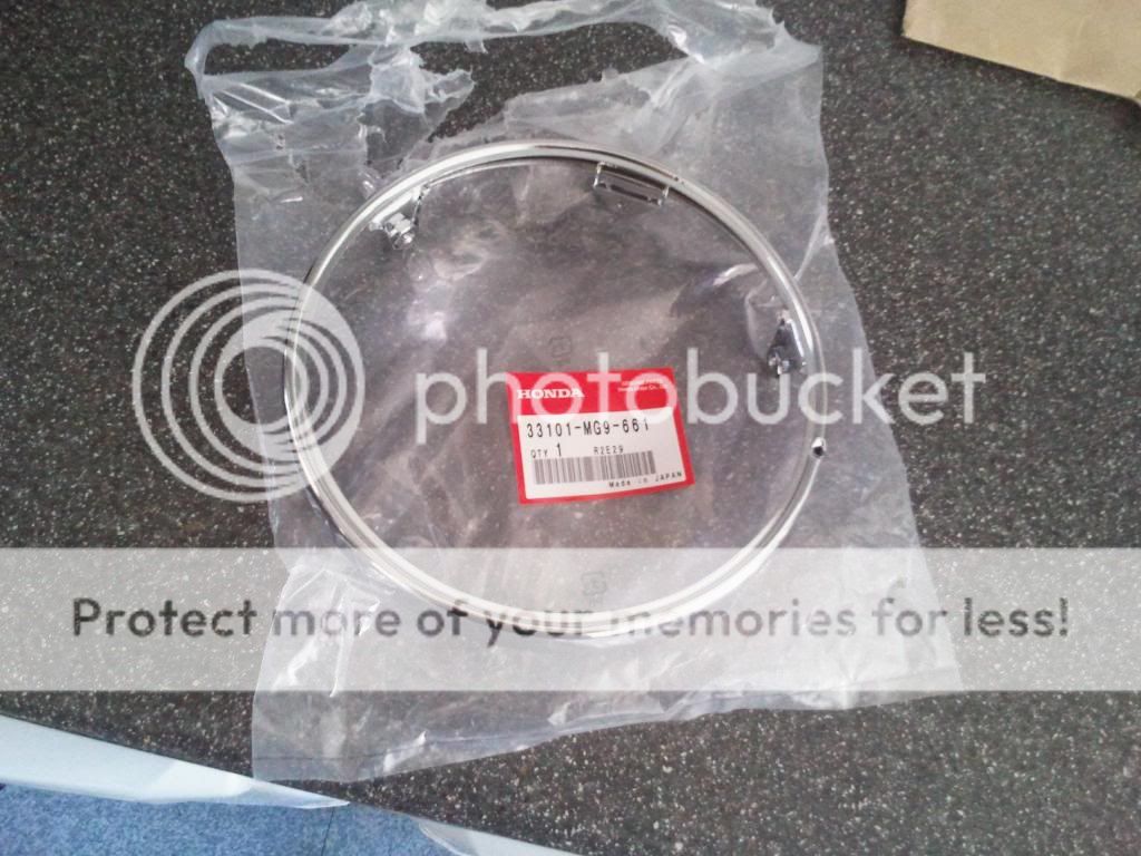

https://i77.photobucket.com/albums/j69/willyrobbie/2012-12-10112758_zps634afc97.jpg
Genuine headlight rim. Old one rusted to buggery.
