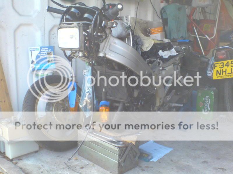

Finished rebuilding the rear brake caliper today and also bent the headlight cradle to the right a bit with some scaffold tube so it's straight again.
I have 2 things left to do for the M.O.T. Bleed the brakes and rebuild the forks.
I was going to get the bike up on top of a tool box today so I could remove the forks, but I need to re-arrange the garage first and my dad wouldn't move his RD250 outside when it was raining.

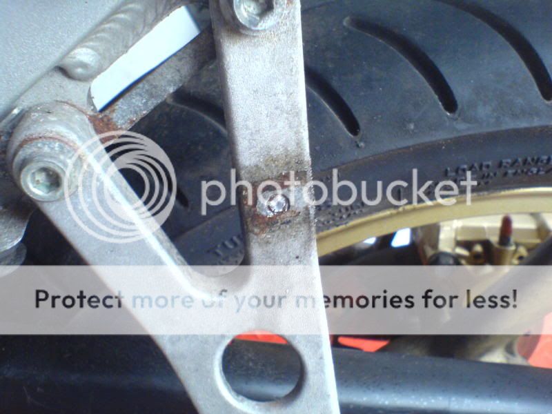

My first sheared bolt Evil or Very Mad
https://i15.photobucket.com/albums/a376/ms51ves3/DSC00869.jpg
Crying or Very sad

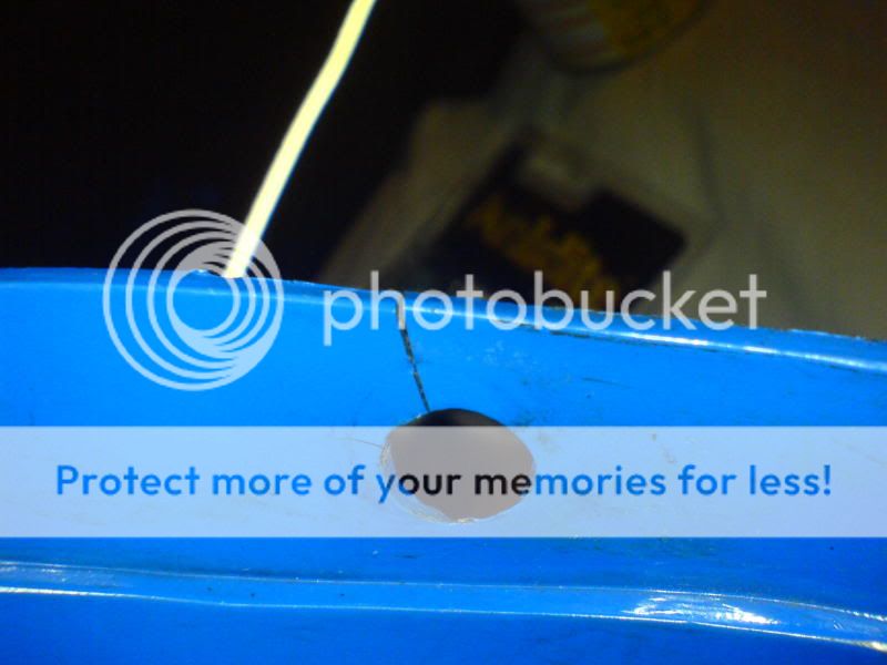

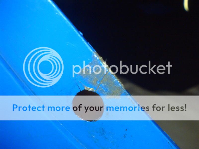

A repaired a couple of little cracks on the V piece fairing with some Araldite.
Before:
https://i15.photobucket.com/albums/a376/ms51ves3/DSC00877.jpg
After:
https://i15.photobucket.com/albums/a376/ms51ves3/DSC00879.jpg

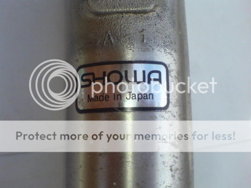

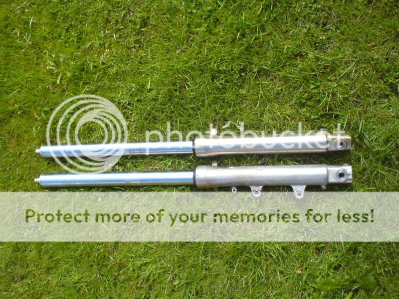

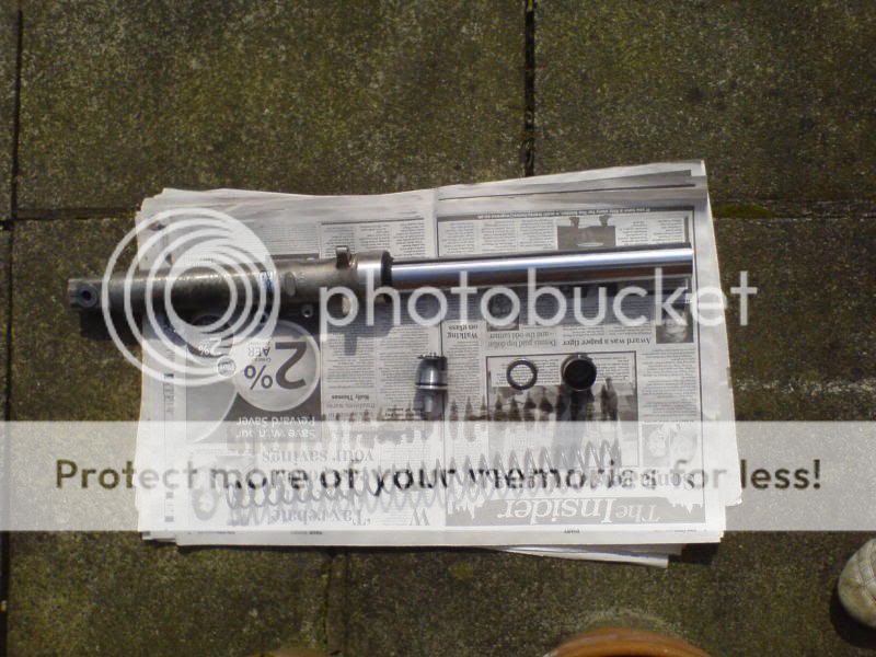

The forks:
https://i15.photobucket.com/albums/a376/ms51ves3/DSC00882.jpg
https://i15.photobucket.com/albums/a376/ms51ves3/DSC00883.jpg
Caps removed and oil drained:
https://i15.photobucket.com/albums/a376/ms51ves3/DSC00884.jpg
What to do with the old fork oil Thinking
Burn it Twisted Evil
https://i15.photobucket.com/albums/a376/ms51ves3/DSC00885.jpg
I'll need to wait until Monday now until I can get my forks to the garage and fit the new seals.

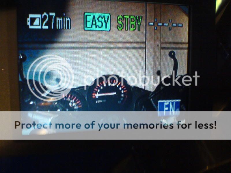

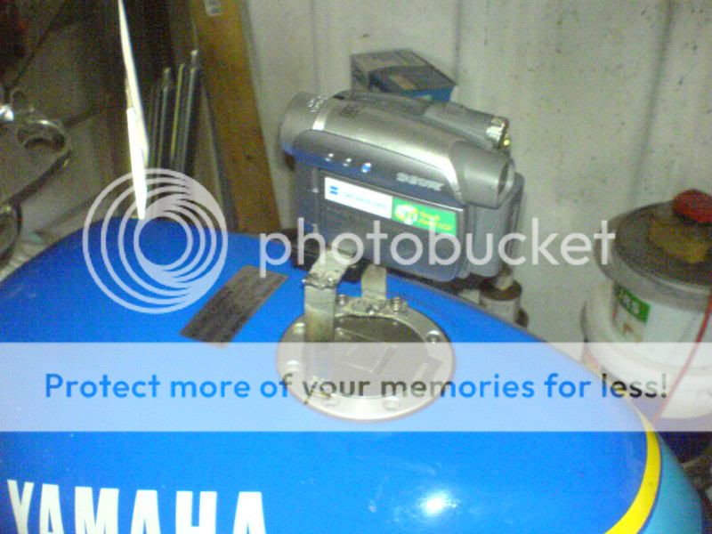

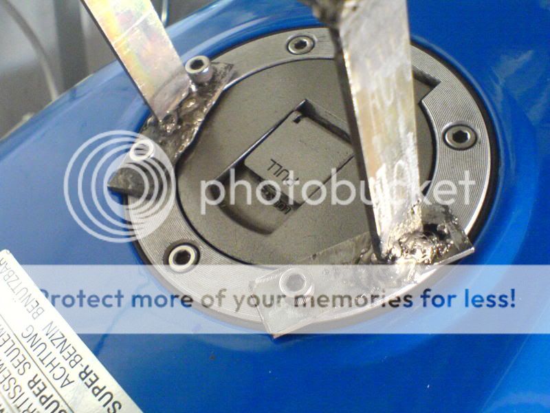

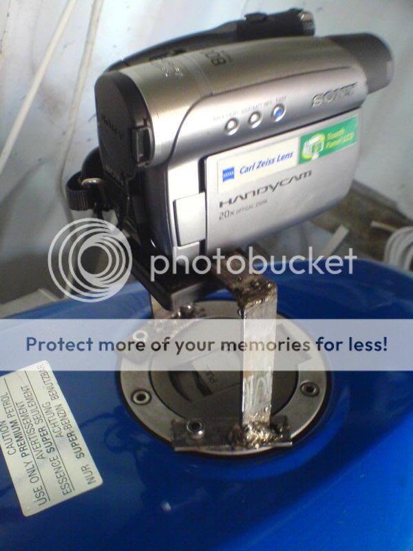

Just been outside for the last couple of hours making a camera rig out of the mechanism from my front door.
https://i15.photobucket.com/albums/a376/ms51ves3/DSC00886.jpg
https://i15.photobucket.com/albums/a376/ms51ves3/DSC00887.jpg
Yes I realise my welding is crap and with it bolted on you can't open the tank cap, just needs some re-working. I was going to bolt it on the other side but because of my shoddy welding I wouldn't be able to get the bolts in Rolling Eyes
It's sturdy though, I just need some bolts to bolt it on as the ones I was using were to bolt the tank cap to the tank.
https://i15.photobucket.com/albums/a376/ms51ves3/DSC00890.jpg

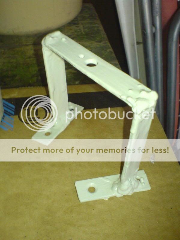

Finished off the camera mount today with some more shoddy welding so now it is held on by 3 bolts.
https://i15.photobucket.com/albums/a376/ms51ves3/DSC00895.jpg
https://i15.photobucket.com/albums/a376/ms51ves3/DSC00896.jpg
Then I painted it white with a tin of anti rust primer I found in the garage.
https://i15.photobucket.com/albums/a376/ms51ves3/DSC00899.jpg

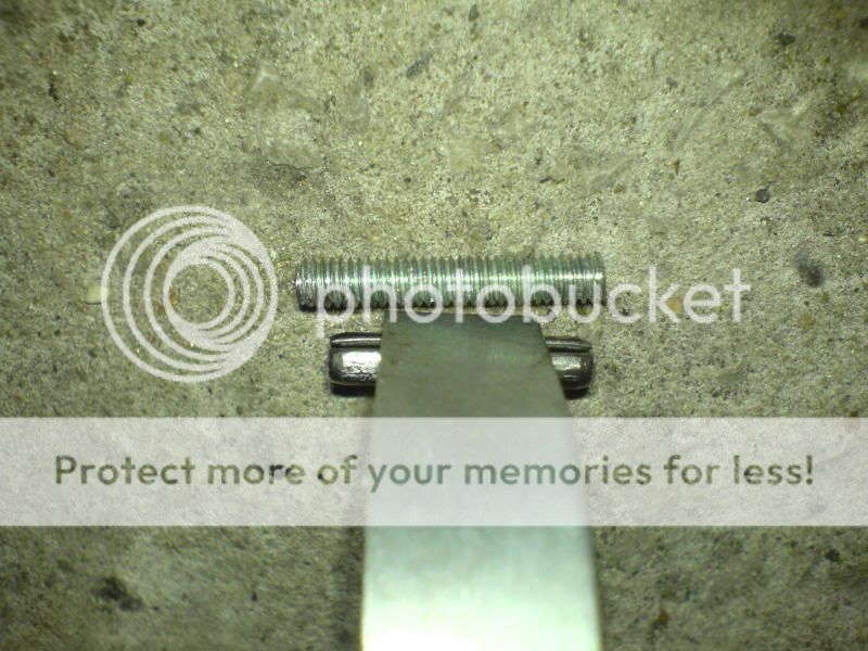

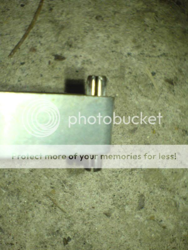

The spacer that goes in between the clip-on and the top yoke has a little pin through it, but the one on the right didn't so when fitted it spun round.
https://i15.photobucket.com/albums/a376/ms51ves3/DSC00900.jpg
I found a little piece of threaded bar (if you can call it a bar) that was pretty much the perfect size. Another job striked off the list.
https://i15.photobucket.com/albums/a376/ms51ves3/DSC00901.jpg

Hope you don't need to fill up with petrol in a hurry Mr. Green .

I'll be carrying a 4mm allen key around. No F1 pit stops for me Laughing

I just found a tin of taps hoping that I could use one after drilling most of the sheared bolt out, but they're all imperial Evil or Very Mad
PostPosted: 21:19 - 12 Apr 2009    Post subject: Reply with quote
The baffles are standard. One was slightly mishapen and a git to get out. If you take them out they are a blocked tube with a couple of scoops for the gas to leave the tube, and then a couple more scoops for the gas to enter the tube. If you wanted to you could probably easily make up a replacement noisier baffle.
Suspect with the sheared off bolt it would be easiest to take the hanger off and stick it in a piller drill carefully lined up and drill the old bolt out with progressively larger drills. Suspect there is a good chance you could get it out without damaging the hanger.
I don't have access to a pillar drill. I was just going to use my black and decker hand drill progressively getting bigger until 5mm, then put an M6 tap through it (I think it's M6).
For now though, it's not crucial.

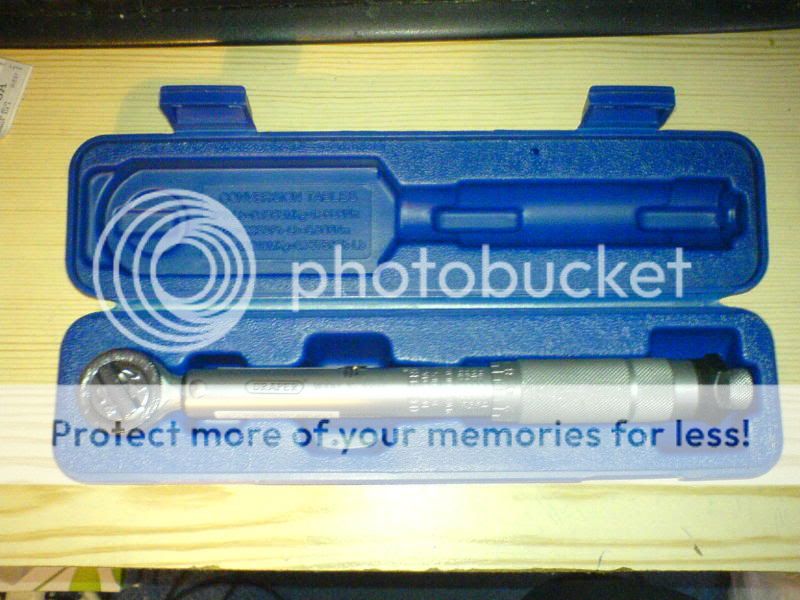

My torque wrench has arrived Very Happy
Credit to Amazon. Dispatched yesterday, arrived today via RM as well.
