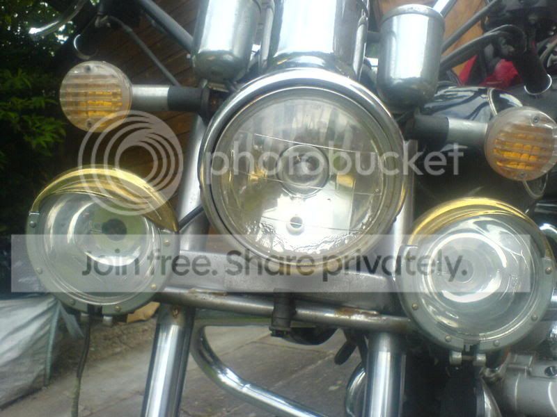

I had a load of electircal problems a while back and i never bothered putting bulbs back into my sidelights.
Is this going to be an MOT fail or will i need to go get some bulbs?
https://i115.photobucket.com/albums/n290/benus_maximus/DSC00007.jpg
The main bulb and headlight works and has high beam setting.

No requirement for a working speedo. It's not tested on the MOT. I specifically asked the guy who MOTs my bikes this and it has been MOTed for the last three years without a working speedo (there isn't even a speedo drive on the wheel).
The light's will fail if they aren't working. You should get away with taping them up for the MOT (stick gaffa tape or similar over the lens) because it does have a proper light anyway. Asking your MOT tester beforehand is the best bet though because in my experience, many of them make up non-existant rules to suit themselves.

I was working on the assumption that there is a position light in the 'main' headlamp unit on that bike. There is certainly a space for one. That'll have to have a working bulb in it.
The two additional lights are surplus to requirements but if they are fitted and unmasked they will be expected to work.
