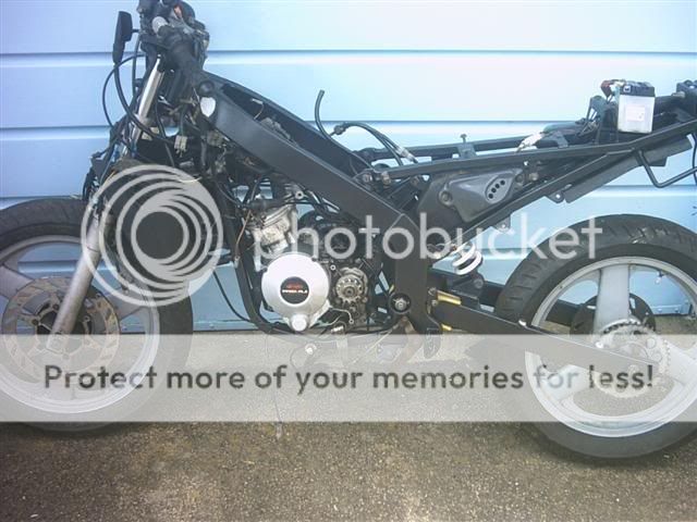

hi... i have just bought a rieju rs1 year 2000 off eBay for £150... the bike its self is pritty fu**ed tbh... gone into back of a car... have been told engine is fine...
Question
the bike will not start... there is nothing... replaced battery as other 1 was no good, and still nothing... stripped bike down completely, and starter motor is disconnected. there is no kick start and it wont bump.. at the back where the fuse box is there is a broken wire hanging out of it.. it is same colour as starter motor cable but too thin.. if some one could post a pic of whats men't to happen it would be very helpful....
hope that makes sense^^ lol
n e help appreciated
will try and post a pic another time... no website is uploading them..
Current Bikes: Kawasaki zx6 g2 (my everyday transport), vfr400 project, honda crf250 (currentely with smashed crank cases) projects: 720cc 2stroke jetski engine, mini moto engined push bike Razz
hmmmnz

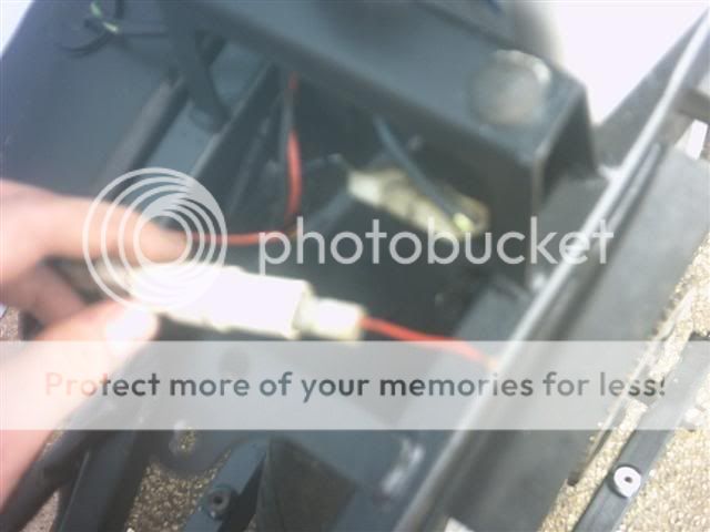

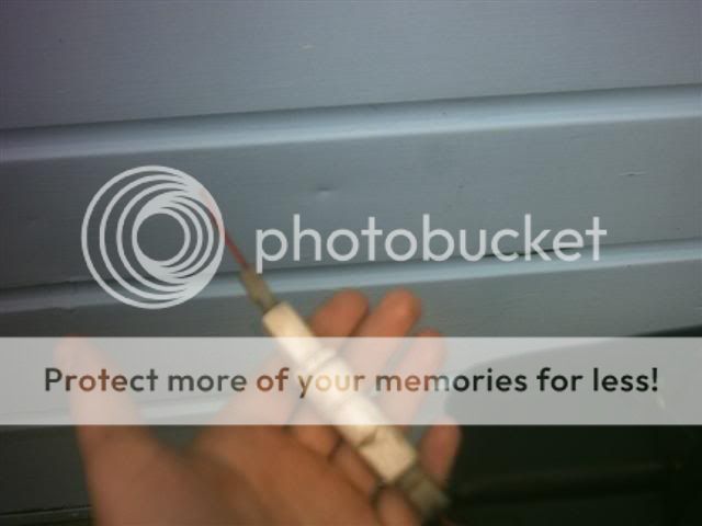

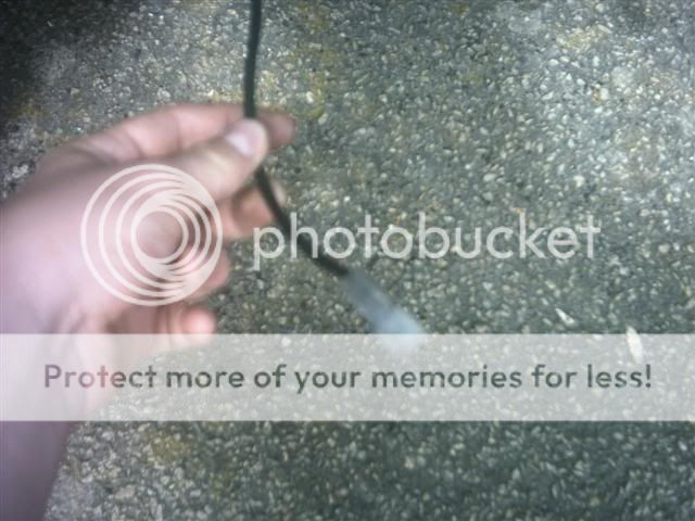

hey mate heres the pics
https://i58.photobucket.com/albums/g257/hmmmnz/PHTO0036Small.jpg
https://i58.photobucket.com/albums/g257/hmmmnz/PHTO0035Small.jpg
https://i58.photobucket.com/albums/g257/hmmmnz/PHTO0034Small.jpg
https://i58.photobucket.com/albums/g257/hmmmnz/PHTO0033Small.jpg
the wires thats connected to the fuse, follow that back and see where it goes,
i can't tell anything from those pics really.
but that could be the main fuse that goes from the battery up to the ignition switch.via a few joins in the cable for the turn signal relay and the dash rev counter.
it makes it a bit tricky to follow wire with out a multimeter, so i sugesst the first thing you do, if your not getting any one to help you is buy one and talk to a reiju dealer about getting a manual and wiring diagram for the bike.
