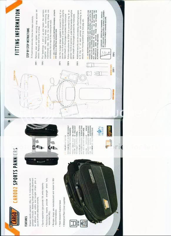

Which bit do you need. Pm me your address and I will send you a copy. Just bought the touring set myself.
Or this might work
https://i50.photobucket.com/albums/f324/skudd67/Cargo_sports.jpg

Hi Skudd,
Have pm'd my address. Can't get it to print off clear enough. Thanks for your help.

Full instructions are in the post.
