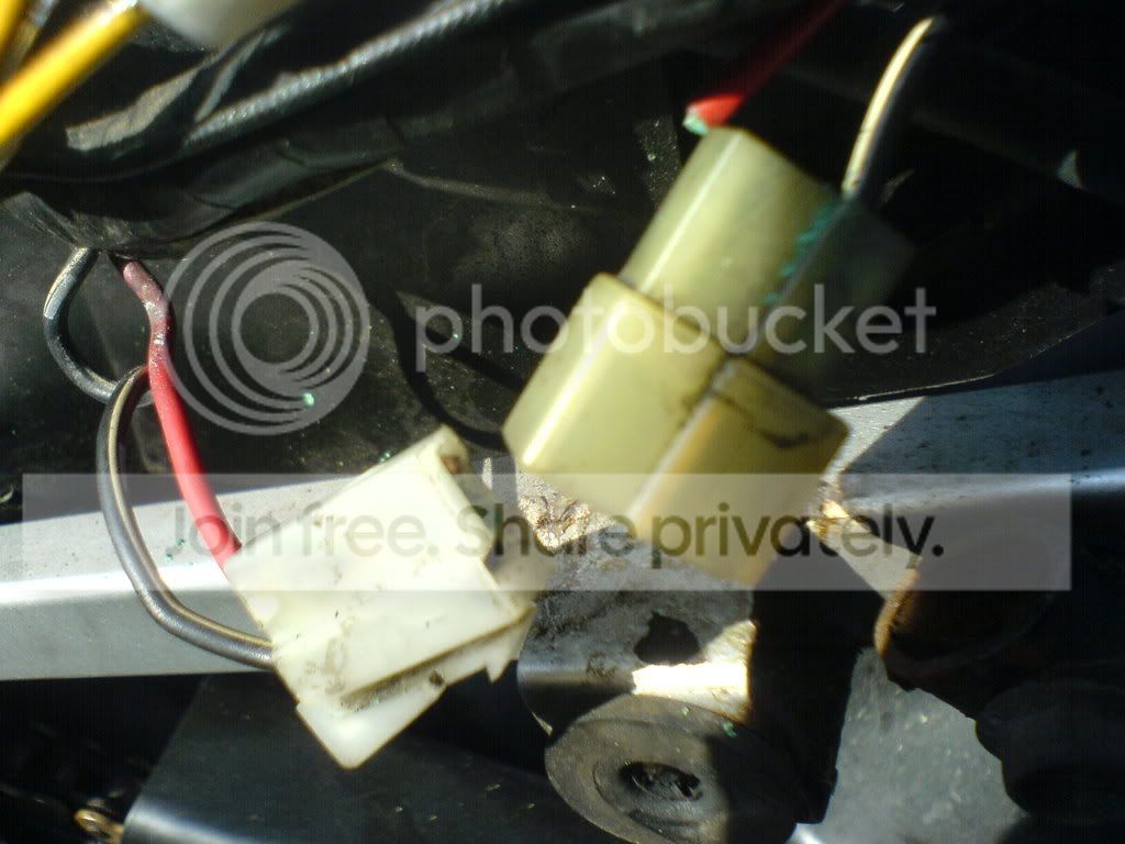

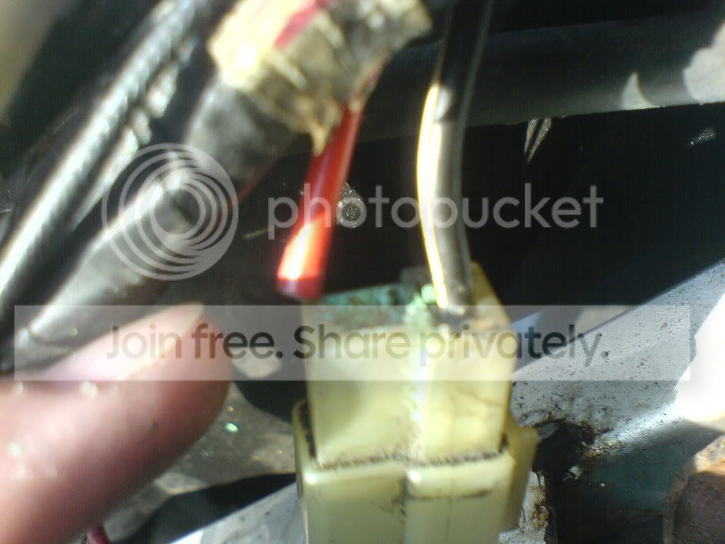

well just been lookin over the bike as its now sunny for a short while. lookin at the connectors for the reg/rec i find one is a bit dodgy.
https://i210.photobucket.com/albums/bb146/21chappers/DSC00538.jpg
https://i210.photobucket.com/albums/bb146/21chappers/DSC00537.jpg
its full of green stuff which im guessin is copper rust stuff. could this be the cause? wot would be the best thing to do?
cheers

PostPosted: 17:20 - 20 Aug 2007    Post subject: Reply with quote
ladies nail file up it, cut it to size and give it a good fucking with it.
have you checked your solinoid? and that the battery is screwed on TIGHTLY???
if its a little loose it will do as you described.

that connector's a bit trashed dude. The corrosion is caused by age.
If I were you I'd cut them off and make a new connector using insulated bullets.

PostPosted: 18:56 - 04 Sep 2007    Post subject: Reply with quote
well annoyingly it has started to do the same again. not want to work with the electrics on and will not charge the battery. the connection i soldered is still fine so have ordered a new reg/rec to see if this works. any ideas if it doesnt?
cheers
adam
