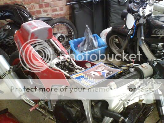

Dad forgot some of the bits - but ive got a Haynes, If you look just above the grip that pink bit of wire is actually a nicely bodged hoke cable.

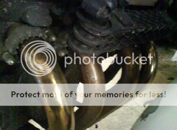

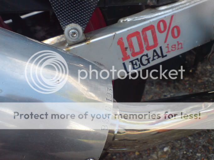

Stainless downpipes leading to the stainless ART can

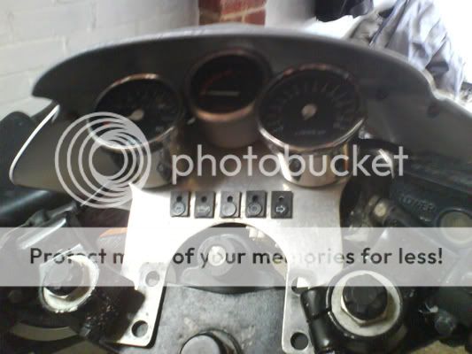

Someones bodged the dash. Im sure it must have looked okay at some point... maybe.

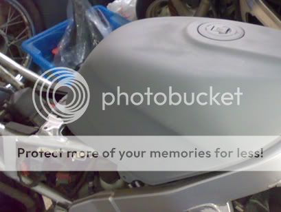

So I soon decide to go down Hal frauds and get some sand paper/primer/satin black/clear.
I sand down all the parts - then sand them again.. And again - you can see where this is going. Prime them and wet sand them to get them nice and smooth. Then started the painting. Which is actually great when you’re not wearing a mask! Shifty
Tank primed after a lot of sanding

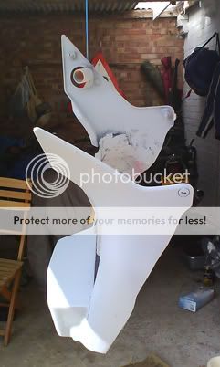

tail section primed - it has a crack in it which i didnt think id bother repairing at first
https://i148.photobucket.com/albums/s34/Torque05/tailsectionprimed.jpg
Then i thought why not before i started wet sanding i got out some crack filler and wacked that on it. Sanded it down and it wasnt too bad.
https://i148.photobucket.com/albums/s34/Torque05/bodgedup.jpg

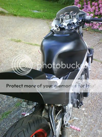

This is the first coat of black on the tail unit. I thought the choice of satin black was pretty good. Didnt feel like going for that common as muck matte black! Wink
https://i148.photobucket.com/albums/s34/Torque05/1stcoatontail.jpg

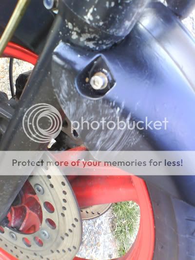

This is the fender after some coats of clear - it was like my tester piece thats why it looks so crap.
https://i148.photobucket.com/albums/s34/Torque05/frontfenderpainted.jpg
I got a bit over excited with the clear and made it run a little so i picked up a cloth to wipe it off.. little tip... DONT
https://i148.photobucket.com/albums/s34/Torque05/oops.jpg
Anyway i couldnt be botherd to start that again as im properbly goig to throw this bike down the track anyway. So i fitted the bits on, bare in mind they havnt had gloss put on the (except the fender), i also dont have a seat for it at the moment as my dad hadnt been able to get over. I still couldn’t get over the fact of how damn ugly the headlight fairing looked. I’m not the biggest fan of twin headlights anyway.

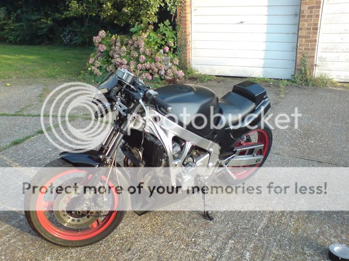

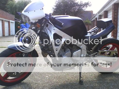

https://i148.photobucket.com/albums/s34/Torque05/tailandtankpainted02.jpg
https://i148.photobucket.com/albums/s34/Torque05/tailandtankpainted.jpg
https://i148.photobucket.com/albums/s34/Torque05/tailandtankpainted03.jpg

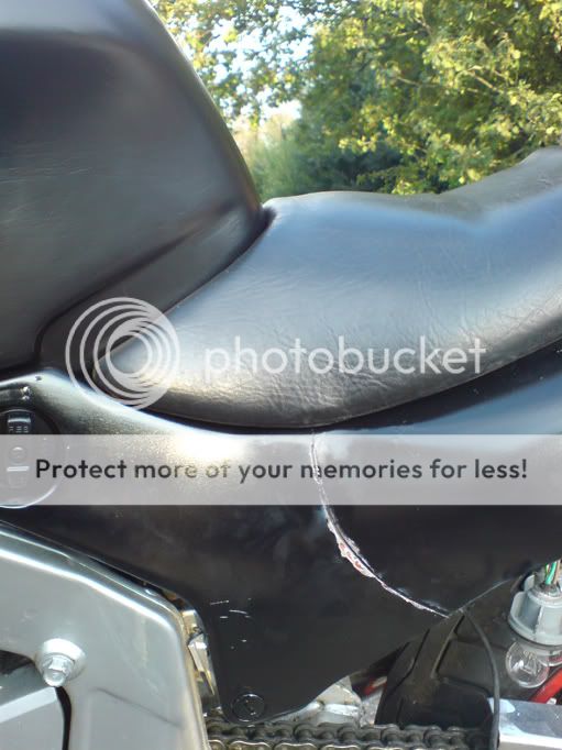

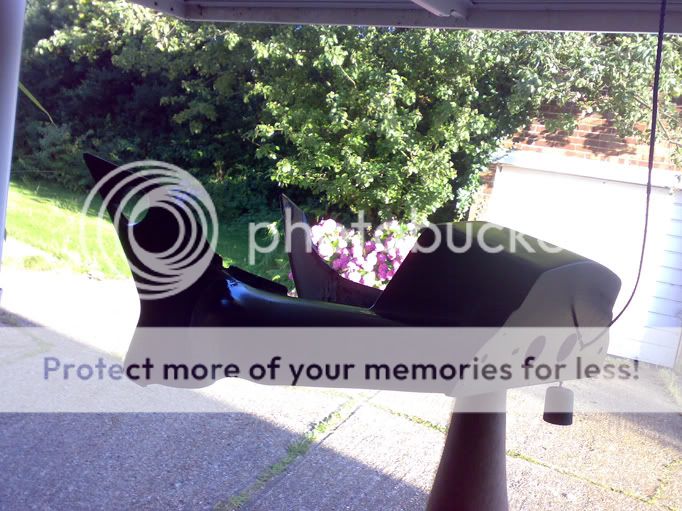

I then decided to do the clear on the tail section - It went really well until i decided to drop it and all that repair work i had done was gone instantly. Crying or Very sad
I have however managed to bodge it together with some superglue Very Happy
https://i148.photobucket.com/albums/s34/Torque05/Crackedseatcowl.jpg

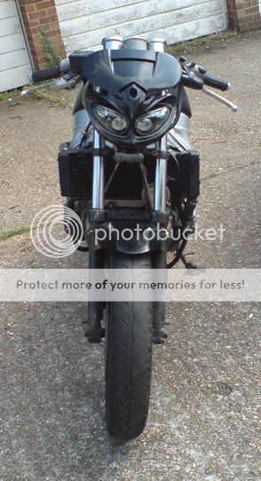

A couple of days ago my new headlight fairing came through from busters. Very very nice IMO. Especially for the bargin price of £30! And lets be honest i couldnt wait! So off came the twin lights and that horrible piece of fairing and on goes this wonderful piece of sex. (granted i havnt actually wired it up yet as i dont have a soldering iron or anything - but give me time! I just wanted to see what it looked like, and i wasnt dissapointed. Twisted Evil
https://i148.photobucket.com/albums/s34/Torque05/nosefairing05.jpg
https://i148.photobucket.com/albums/s34/Torque05/nosefairing02.jpg
https://i148.photobucket.com/albums/s34/Torque05/nosefairing03.jpg
https://i148.photobucket.com/albums/s34/Torque05/nosefairing04.jpg

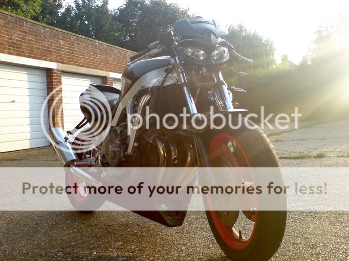

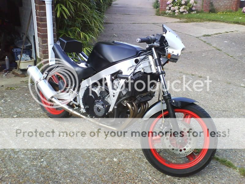

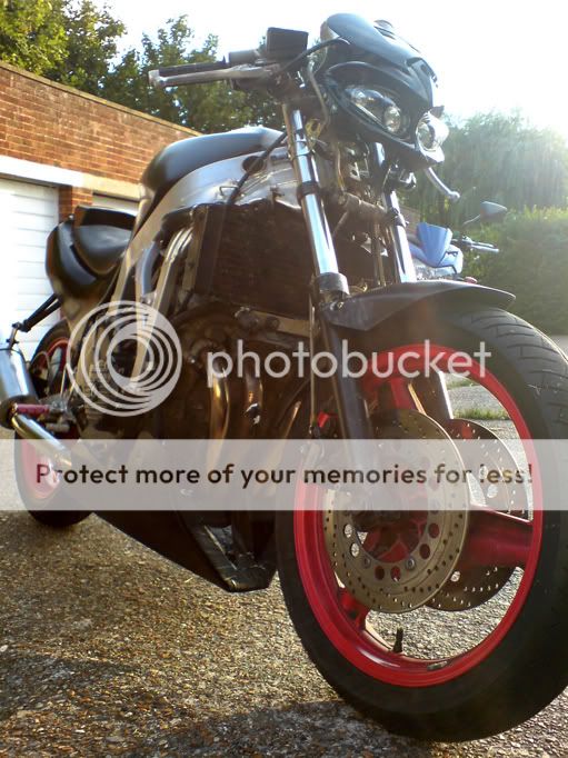

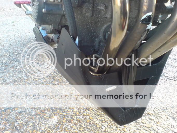

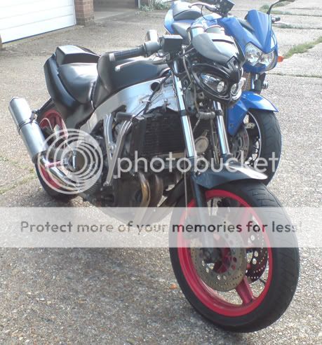

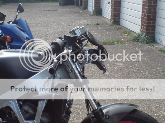

After this the belly pan too my eye. Now i couldnt be botherd to start painting it only for the stone etc to wrek it and make the whole lot of work pointless. So i came up with a pretty good solution in my eyes!
Now it isnt actually fixed on properly - ill need to make some brackets up. But this is now close to what i want the bike to look like when im done. Obviously ill need to paint the wheels. Any other suggestions?
https://i148.photobucket.com/albums/s34/Torque05/gaffabellypan.jpg
https://i148.photobucket.com/albums/s34/Torque05/bellypanandnosefairing06.jpg
https://i148.photobucket.com/albums/s34/Torque05/bellypanandnosefairing05.jpg
https://i148.photobucket.com/albums/s34/Torque05/bellypanandnosefairing03.jpg
https://i148.photobucket.com/albums/s34/Torque05/bellypanandnosefairing02.jpg
https://i148.photobucket.com/albums/s34/Torque05/bellypanandnosefairing.jpg
https://i148.photobucket.com/albums/s34/Torque05/bellypanandnosefairing04.jpg
Thanks for reading! It was a bit long i know! Any suggestions welcomed! But remember its got to be cheap and expendable.

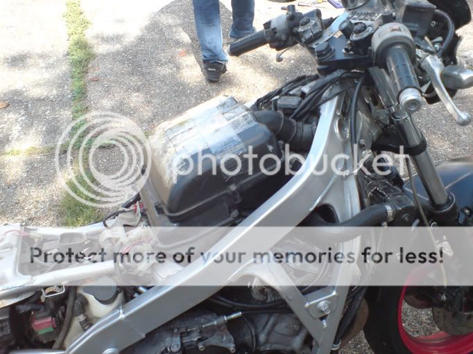

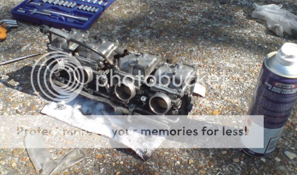

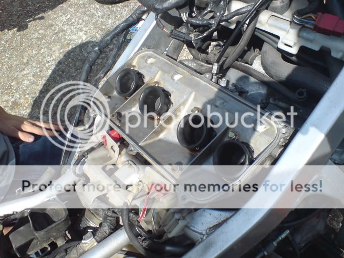

Right this is my third time of writing this out as the computer hates me.
Grant came over today to help me with the bike. As im not very mechanicly minded and the carbs needed taking off and cleaning.
We start about 10 in the morning trying to get the carbs off which did take a while to be honest. But in the end with some brute force they finally came off ready for some cleaning.
We drained out some rather luminous looking petrol and then srayed a lot of carb cleaner in and around them to get it all flushed out. We also cleaned the jets and put them back together.
Heres a nice picture of them upside down.
https://i148.photobucket.com/albums/s34/Torque05/DSC02501.jpg
We also cleaned the rubber bikes that we had to detach them from. (i dont know what theryre called) They were encrusted with crustyness?? So some WD40 and elbow grease soon removed that. and they were looking alright again.

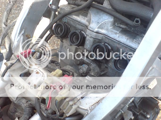

https://i148.photobucket.com/albums/s34/Torque05/DSC02502.jpg
Then we put the carbs back on during which we realised the throttle able is begining to fray... yey more expense!
https://i148.photobucket.com/albums/s34/Torque05/DSC02505.jpg
Then came time to put the airbox and filter back on which was pretty straight forward.
https://i148.photobucket.com/albums/s34/Torque05/DSC02506.jpg
Then we ventured down to the local texaco garage and got about 3 litres of petrol - although some did manage to spray in my face. Embarassed
Got back to the garage and put the tank on - linked the pipe to it etc and put some petrol in this bint. Turned the key and pressed the starter button....
Nothing Evil or Very Mad
Damn batteries never last. Then we tried it again, the battery had hardly any charge but the engine was turning over so we decide its time for a bump start.
1st attempt the engine just turned over and nothing much happend. Second attempt - not too much really as i forgot to turn the ignition on Embarassed . 3rd time was the same as the first so by now were both pretty tired and decide to go inside and have a bacon sarnie while putting the battery on charge.
Grant decides to use his battery in the bike to see if it would fire up with a bit more electricity flowing through it. Put it in and pressed the button. Unfortunatly it was just more noise. We soon turned our attentions to the fuel pump relay which had been by passed by my with a nice piece of pink wire.
We consulted the haynes on this matter which showed us it had all been done right and should really be working... unless the fuel pump is nakard. Which it turns out it is. The suction on it isnt too bad but the amount of air its pumping out is pitiful. So after all these hours of working i now need to find a new fuel pump for a CBR600FJ... any idea's?

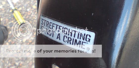

O and the stickers look like this -
https://i148.photobucket.com/albums/s34/Torque05/DSC02504.jpg
https://i148.photobucket.com/albums/s34/Torque05/DSC02503.jpg
