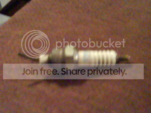

td007
Joined: 16 Nov 2007
PostPosted: 18:11 - 19 Nov 2007    Post subject: Reply with quote
yes just the threded bit left in the head
i will get u a picture later if u can upload them on here
td007
Joined: 16 Nov 2007
PostPosted: 18:50 - 19 Nov 2007    Post subject: Reply with quote
https://i188.photobucket.com/albums/z117/trist077/DSC00022.jpg
this is the spark plug if this is a better idea
Barry_M2
Joined: 09 Sep 2004
PostPosted: 20:49 - 19 Nov 2007    Post subject: Reply with quote
Looking at that picture, I think there may well be some of the ceramic insulator on top of the piston! Shame, as it means the head has to come off.
I wouldn't turn it over any more either if I were you.
