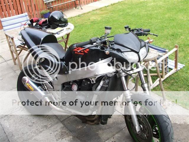

did you not read why???
i originally had a external thermostat housing and filler unit as one
but when i turned it into a fighter it just looked dumb,
https://i58.photobucket.com/albums/g257/hmmmnz/DSCF1040Small.jpg
so i changed the rad to a bigger zx6r one which had the filler built in,
but alas no more thermostat.
https://i58.photobucket.com/albums/g257/hmmmnz/DSCF0658Small.jpg
so that is why i run a inline reducer, effectivly slowing the water down to cool the water as its passed through the rad.
and has worked a treat,
and i do run antifreeze/coolant just obvisiously the ratio wasnt high enough and over the 8 days of sub zero temps in scotland while i have been over in germany have been enough to freeze he system solid.
if i had a faired bike i would have left everything as stock and im sure this still would have happened, not having a thermostat hasnt changed anything about the bike,
so before you think you know everything about the set up on a zxr realise we are all not plastic pocket rocket riders Very Happy Wink
