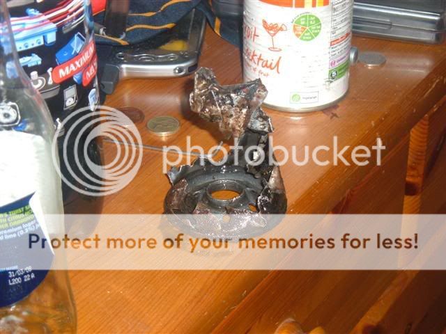

just dont be over zealous, its better to have it a bit too loose and get a wee leak that you can just give it a little tighten up later on,
than over tighten, and get a leak any way because you have fuct the thread,
also only hand tighten the oil filter and rub a little oil on the rubber gasket,
or you'll end up with this the next time you have to do a filter change
https://i58.photobucket.com/albums/g257/hmmmnz/DSCF1138Small.jpg

Shocked Shocked Shocked ..OMG what on gods green earth did you do to that????

well i couldn't undo it with either my hand or my oil filter tool, so i resorted to the screwdriver through the filter trick, which still didn't work, so i then preceded to tear the filter to pieces so i could get to the little holes and use a screw driver and hammer to turn the filter,
i had to remove the exhaust system to do it, what should have been a 10min oil change turned into a 3 hour mission, just because the last person to do an oil change didn't oil the filters rubber seal, and over tightened it.
