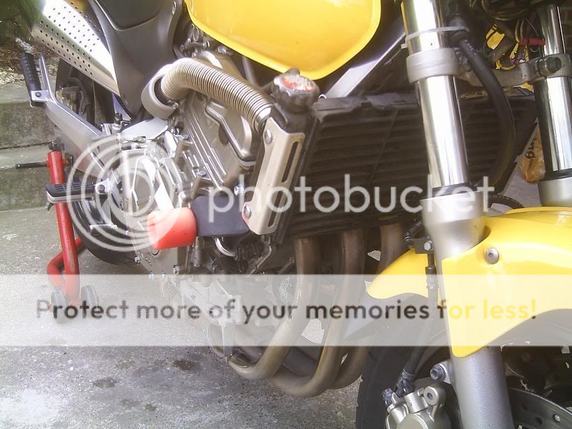

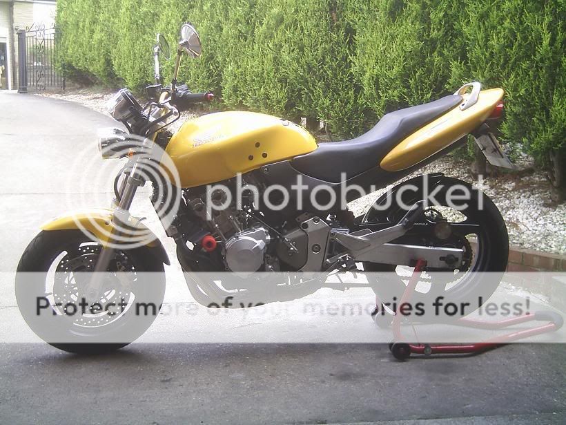

Now that I've finished uni I have a bit of spare time to do things on the bike. I decided that i'd clean the downpipes and exhaust today as it's been bugging me how grubby they've looked for ages.
So I took off the belly pan, bought some wire wool and Autosol and set about them:
Hornet minus belly pan.

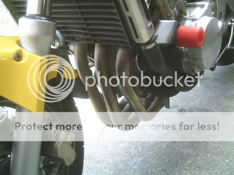

Tarnished downpipes.
https://i47.photobucket.com/albums/f186/markjackson13/downpipes2.jpg
https://i47.photobucket.com/albums/f186/markjackson13/downpipes3.jpg

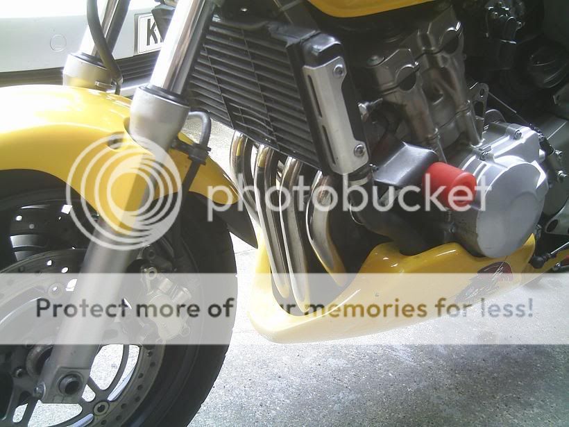

One side cleaned, the other awaiting cleaning. Bit of a difference!
https://i47.photobucket.com/albums/f186/markjackson13/downpipes4.jpg

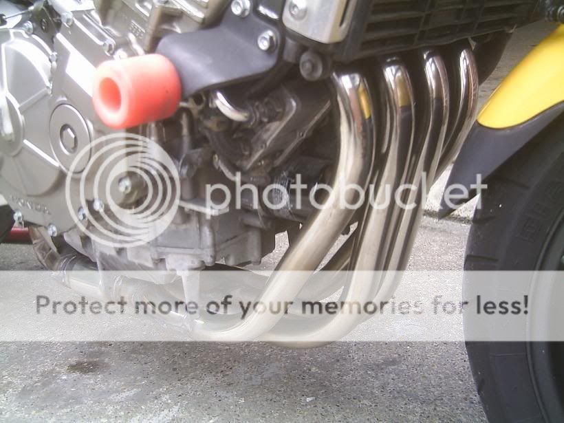

Finished!
https://i47.photobucket.com/albums/f186/markjackson13/downpipes5.jpg
https://i47.photobucket.com/albums/f186/markjackson13/downpipes6.jpg

looks sweet. how did you do it? i would have thought the wire wool would have scratched the pipes. Confused
MarkJ
Joined: 11 Apr 2006
PostPosted: 23:01 - 07 Jun 2007    Post subject: Reply with quote
So did I to be honest, so I tried it on a small patch of the exhaust under the sump first - no scratches at all. I used the fine grade wire wool (bought from Halfords in a pack of 5 - 2 fine, 2 medium 1 coarse). Just put a bit of Autosol on a cut out piece of the wool and scrub the downpipes with it. Takes a bit of effort but you get used to it. Probably took me an hour max to get the exhaust like that. I went all the way under the sump but that part didn't look as impressive.
Pte1643
Joined: 07 Aug 2006
PostPosted: 10:56 - 08 Jun 2007    Post subject: Reply with quote
It won't scratch.
The Stainless that the pipes are made of is "Harder" than the wire wool.
"00000" (five O) grade wire wool for polishing.
