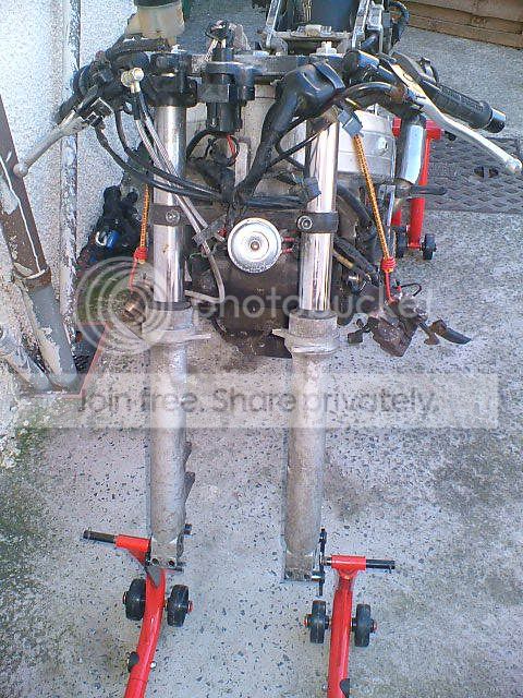

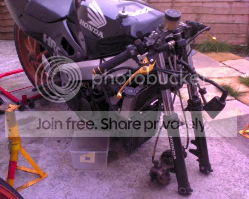

faddius wrote:
Thats how I keep trying to lift the front wheel but the stand keeps turning allowing the forks to slide till the bottum prong is about to slide off the back of the fork, which would cause the bike to fall.
Thats why I thought I must be doing something wrong.
This is what happened to my nc30 when mine "fell off ". Confused
Two of us to lift it up and one to put the stand back under..... Aint using the front stand on the gsxr, i rather buy an abba stand instead .... not taking the risk again !
Before :
https://i127.photobucket.com/albums/p138/lilldic_mossy/DSCF0782.jpg
After..... DOH ! (also after tarting it up a bit aswell !)
https://i127.photobucket.com/albums/p138/lilldic_mossy/DSC00022.jpg
